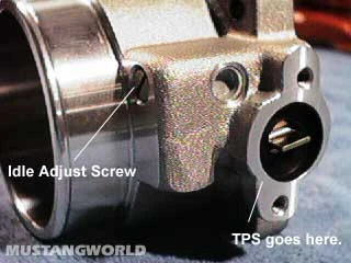

Sorry for the ignorance but where is the screw that you guys were talking about to adjust idle?
I assume they mean this :
(Thanks MustangWorld)
yeah um that screw is nowhere to be found on my stock Tb. Anyways isn't the idle all controlled by the computer anyways or even my chip?
