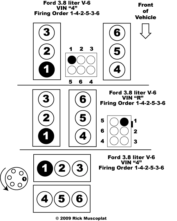

I had the exact same problem! I would start my car and the rpms would drop drastically and my car would shut off unless I gave it gas, only while idling too. Battery checked and it's 100% good, the first sign was my lights not dimming when it would do this. So I bought new spark plugs and cables, installed them last night. The cables were dry rotted and plugs we're bad. It solved the problem completely! She has a very smooth start up and idle now. I hope this helps someone! Also including the diagram for cable connections.
