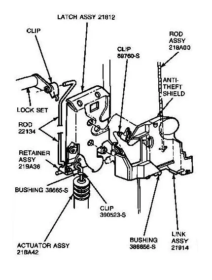

Secondly, please take a look at the pictures below. This was in the bottom of the door when I retrieved the solenoid (after drilling out the rivet). I have to believe that it was somehow previously attached, because it probably would have rattled pretty badly, and we don't recall hearing this thing previously. So, my question is, WHAT is it and WHERE does it go? It does have a part # stamping = 9AB - 54220A91 - AA.

That piece is a cover for the door latch mechanis. I popped it off and for life of me could not figure how to pop it back on. So I've left mine off for some time. I assume it's just a sheild. Ford will have the rivets. I think I paid 1.69 each. I bought the big rivet gun at harbor freight and comes with the rivets for 19.99 They are not the best rivets though, they mushroom and don't split into three parts like the ford rivets do. You could always use 1/4 (I believe) bolts.

Man an anti theft sheild? Maybe I shouldn't have thrown it away. Lol. Oh well. My cars are rarely left alone and are parked in the garage.
