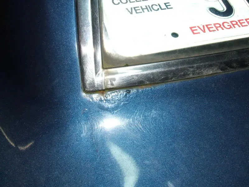

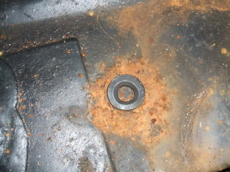

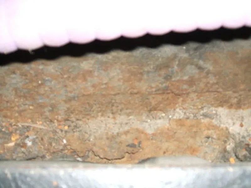

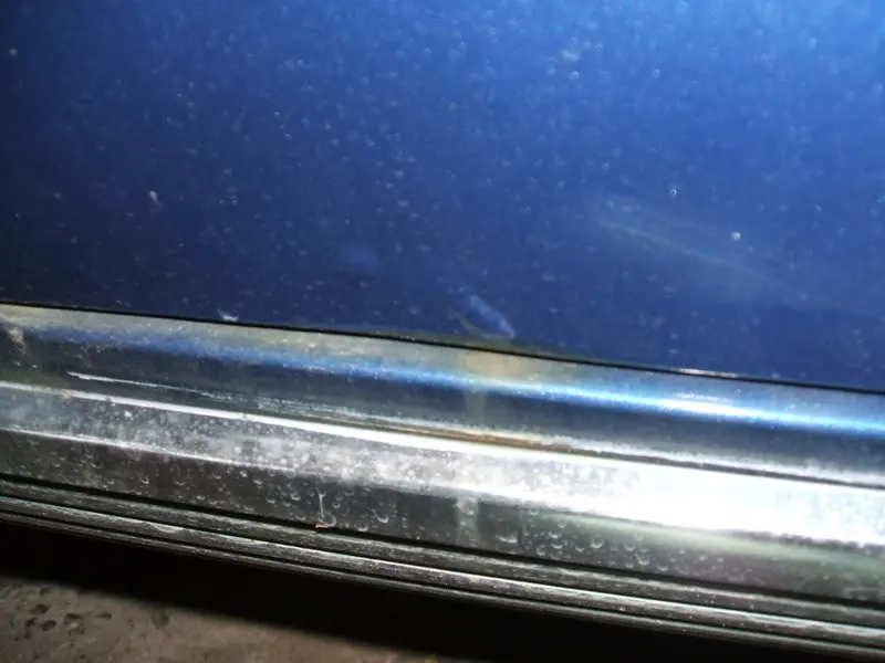

For those who dont know, we picked up tis 65 coupe for $8K.. car is in reat shape inside and out for the most part. Here are the trouble spots I found after we got her home. How hard to fix these?
ok, first one in the drivers side of the trunk and inside the fender:
the other is at the corners of the rear window...both sides look the same:
and this one, on the door may be cheap paint job work...I found some more drips under the grille in the front:

I just got mine out of the body shop for the aera behind the rear window. About 450 to remove rear glass, clean out the seams, blend the paint and replace the window. They did great work but kept it a long time.
the area in the trunk I would take it down to the metal to see how much of it is surface rust. worst comes to worse you might have just cut it out and patch it....the bubbles under the paint are rust spots also or what looks to be.....so the would have to take it to the metal and repair the rust and repaint....price will depend on the area your in
