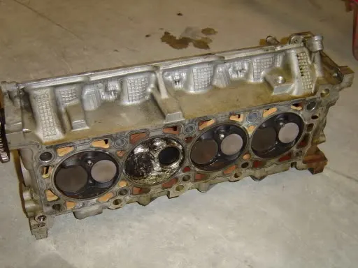

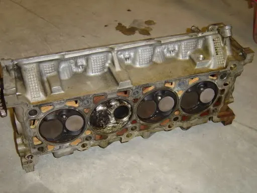

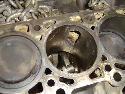

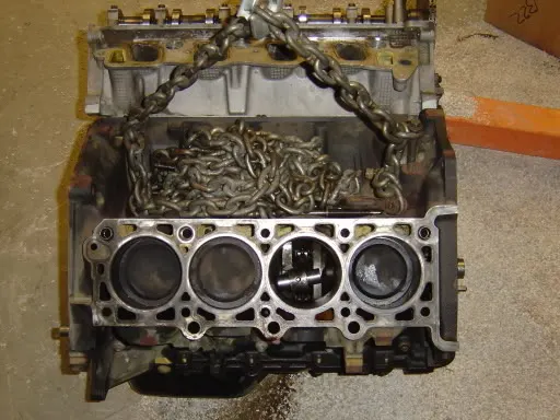

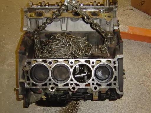

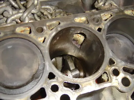

About three weeks ago I had a Mod Max valve spring break on my newly ported head. Here is a couple of pics of the damage it caused.
It is still hard for me to believe so much damage could come from such a small part, but oh well!!

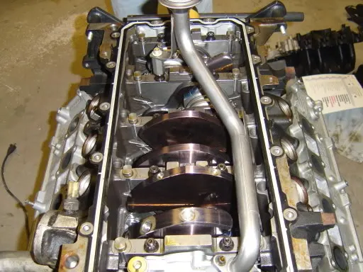

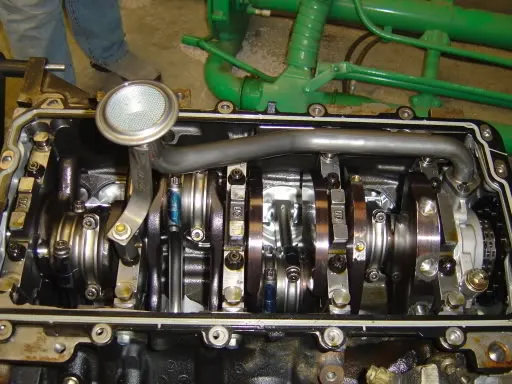

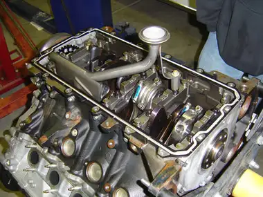

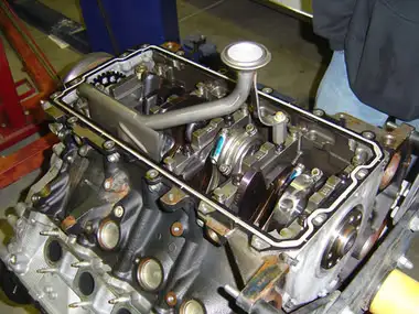

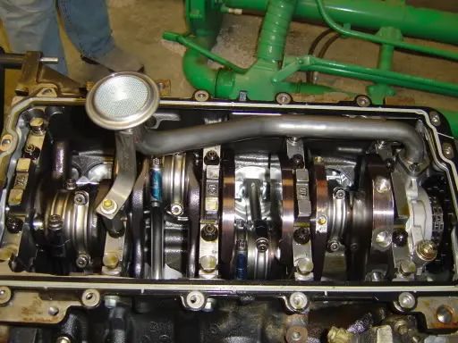

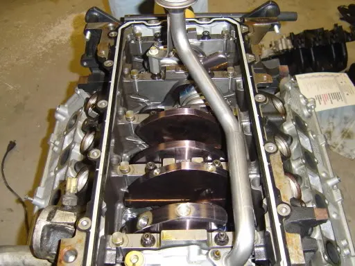

Here is a few pics of what I replaced it with!!!
It is a balanced & blueprinted Sean Hyland built longblock with:
Manley rods & pistons .020 over (8.5 -1 compression for future blower)
heat treated Cobra steel crank
High volume oil pump
ARP bolts throughout
P&P P.I. heads
Comp Cams 270 cams & their beehive valve springs

Less than 500 miles!! Funny thing was it broke with my wife driving it at 70 MPH with the cruise on, not while i was driving the piss out of it!!
