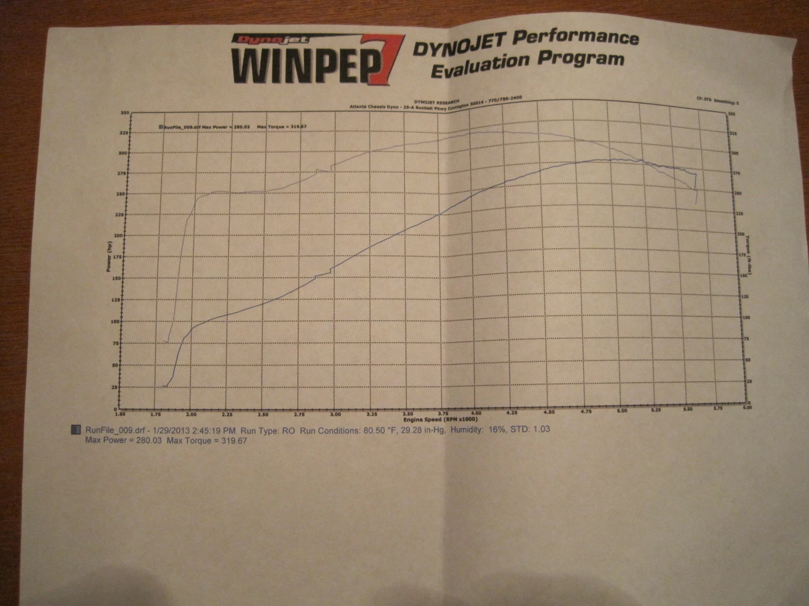

Well being its a DD and that xe292 cam they used with AFR 185 heads with the gt40 intake made i think 450/450, but basically i'm looking at the intake supporting those n/a numbers with a larger cam, if it supported the hp numbers with the larger cam, it will hold my dd needs with any cam smaller than that. I feel basically the intake will hold my chosen rpm band.Giving up the upper 6000rpms for the torque curve i want on the street.

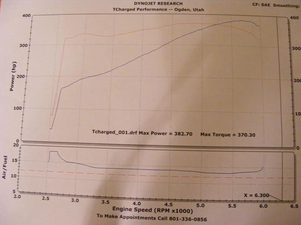

So custom grind is on the table obviously cause it's a torque build but I'm also considering the xe270-12, tfs 1. Here is goody_seven's dyno from another site with a 331 AFR205 with 3.55's using the xe270-12 with 1.6 rockers, so only .512 lift and not .544 with 1.7's with that cam. Also had high rpm intake but the torque powerband is pretty appealing. This is rwhp_rwtrq also.
