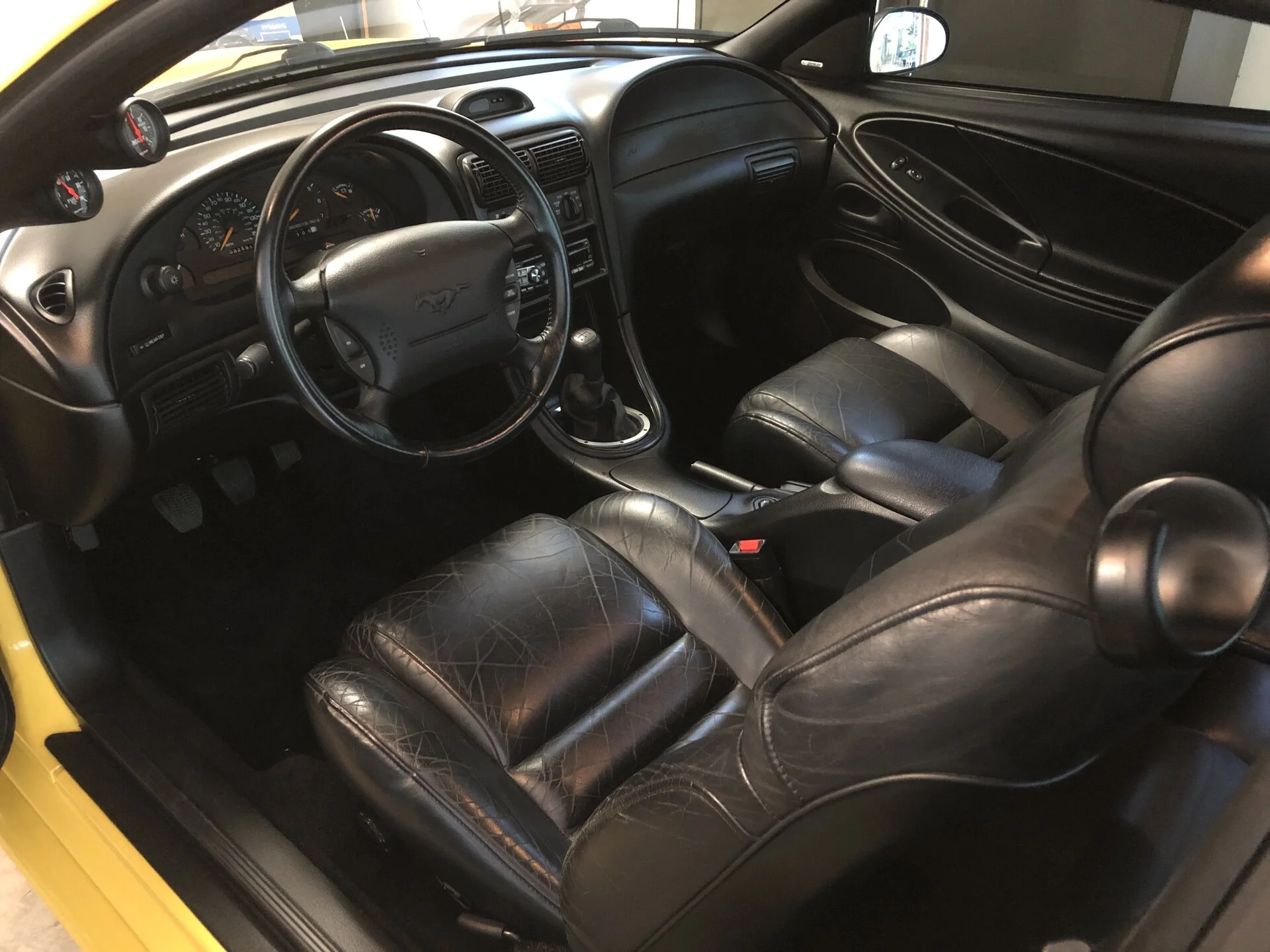

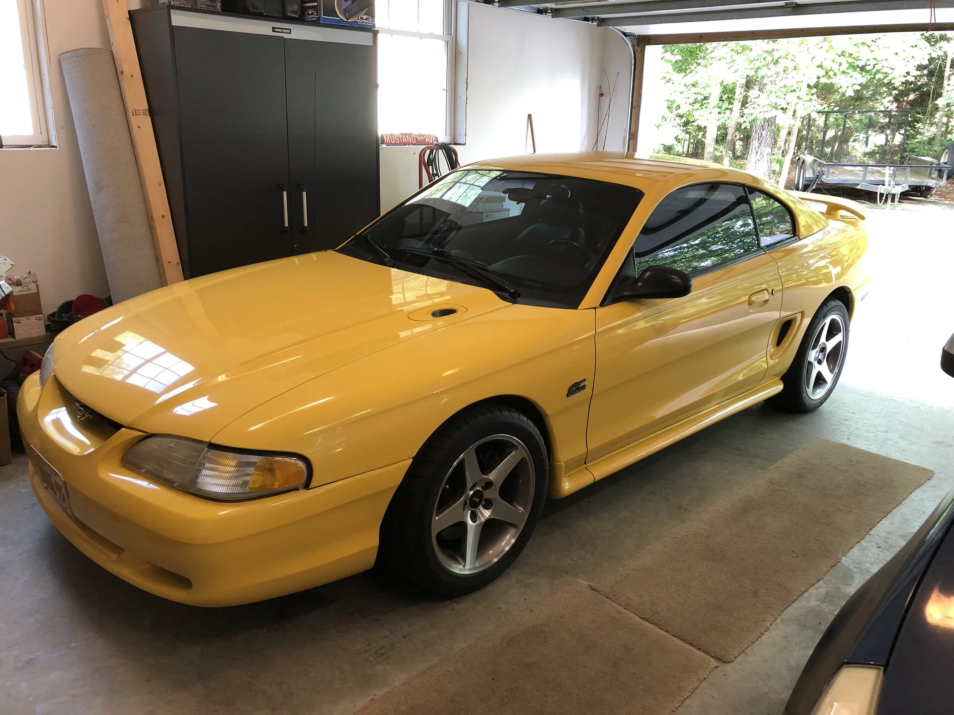

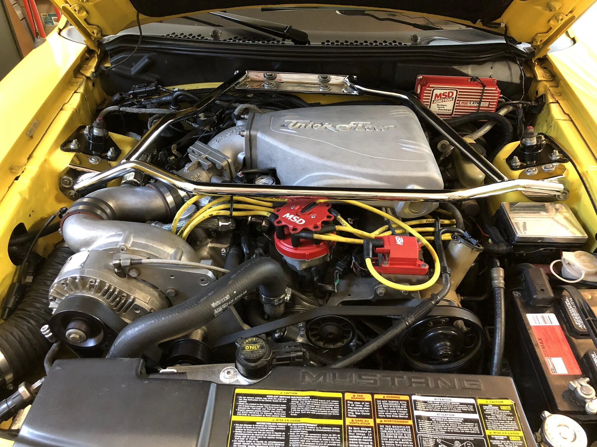

I won’t call myself a guru, especially about suspension but I have owned a few Mustangs and have a ‘95 now. Mine has a Steeda suspension that has been in the car for about 15 years. It handles good to me and the ride is better than stock with Steeda’s sport springs and Tokico struts and shocks, even though the springs lowered it about 1 1/2”. Nothing in my car’s drivetrain is stock anymore and it makes about 600 FWHP. I built it as a fast street car that would handle well also. All of that being said, if I had not started on a project car yet, I would go with the ‘70. I know nothing about making a ‘70 handle well, but the older cars have more appeal and always will in my opinion. I think the reasons you want the ‘70 outweigh any edge in handling the ‘95 may have. Look up a shop called “Mustang Don’s Garage” in Richmond VA. He swears by Grigg’s suspensions and installs them, but they aren’t cheap. He has a ‘70, I believe, that is his own car and he takes that one to road racing events. Tell him Ronnie referred you. He is a wealth of info on the older Mustangs and does full restorations for people also. I will attach a couple of photos of my car. You will see it on his facebook page.
