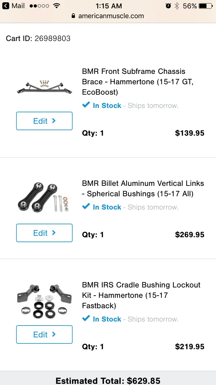

Hey thanks for your help everybody. So I spoke with my shop, really good guys, they said if I can get everything to go ahead and do so, eliminating the trial and error along with extra labor. "Everything " is a loaded gun so I'm trying to narrow it down to what I'm absolutely confident in. So so far I've chosen:
1 BMR IRS Cradle Lockout Kit
2 BMR Billet aluminum vertical links - spherical bushings
Any other suggestions? Also looking at
http://www.americanmuscle.com/steeda-irs-subframe-bushing-system-2015.html
http://www.americanmuscle.com/steeda-irs-subframe-alignment-kit-1516.html
http://www.americanmuscle.com/steeda-irs-subframe-braces-2015-coupe.html
(Somebody in the reviews says you can't use this with cradle lockouts. Anyone know if this is true?)
http://www.americanmuscle.com/bmr-front-subframe-chassis-brace-hammertone-1517.html
(Front end is squirrelly so hoping this tightens it)
Is any of this overkill? Do I need to buy bushings separate from the cradle lockout kit? Do I sound like a complete idiot even asking these things??

Any other opinions? This is my list so far. If nothing else hopefully my gt will be safer off the line. Am I leaving anything out?
D
DZ408
Mar 11, 2016
21
Jul 18, 2017
#14
  • Jul 18, 2017
  • #14
Do I need bushings or is this stuff enough?!!

I supported or replaced all the rubber in the rear assembly, I no longer have wheel hop.
Add spherical bearings in the arms to your list.
BMR has them. You can call Kelly over at BMR and run this past him. He's really helpful and knows his stuff.
