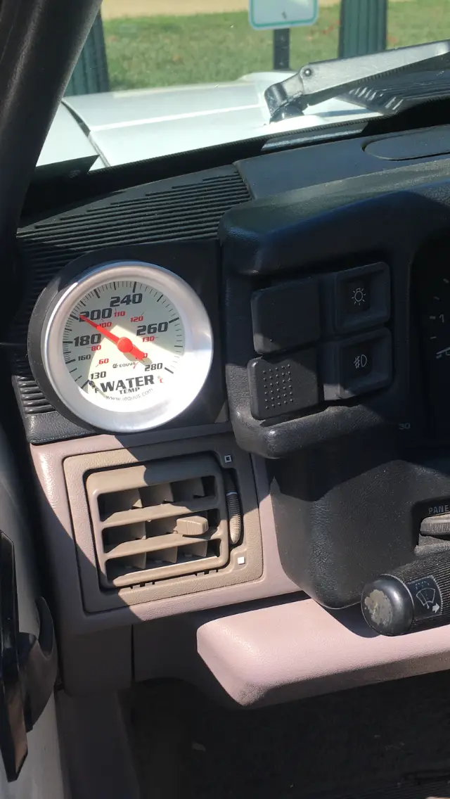

My car is a all stock daily driver - with historic tags , so no emission testing - it has some borla mufflers on it that sound like a quieter version of 2 chamber flows ( without the drone or popping ) the cats seem original ( 105k miles on car ) looks like 4 cats on there ( I heard the front 2 are actually “pre heaters “ for the real cats closer to mufflers - can the front 2 get removed without causing the ECU to go into safe mode and cause the car to not run good ? I am looking to drop the operating water temperature down a few degrees and have heard a free flowing exhaust helps engine run cooler - got a new 192 thermostat , new fan clutch and stock shroud - I imagine the exhaust will get a bit louder too , but that is ok .
A couple of things. Is that temp reading on the gauge you are showing the temp you are trying to make lower? That is a very normal level. But, I looked at all my thermostats the other day so this is fresh on my mind. I run a 180 in mine. In the old days, I ran the must have 160 which did nothing for me. Then I went back to the 192. I've settled on the 180 now and it's working fine for me. Depends on your car though. As far as the cats go, I've knocked tons of them out when we used to do that and never once seen any difference in the front two compared to the rear two. But to answer your question, I knocked mine out and ran it that way for 20 years until I finally got an aftermarket x-pipe. Actually, I had a MAC Prochamber first then an X. Never caused me any trouble but didn't make the car run any cooler either.
I can maintain 190-200 on 85 degree days - but when air temps in high 90s it goes to 220 after 45 min drive ( I can knock it down to 215 by running heat - with top down ) do you think a 180 degree stat would help - my view is the 192 would be fully opened anyway , so I can’t see that bringing temps down . If I cut the front 2 cats off it will still have back 2 - I think the air feed and O2 sensor are in the rear area ( can’t remember off hand ) the ECU should not notice front 2 missing correct ?

1st, there is no issue. 220 is perfectly fine on an all iron motor. Hell, on aluminum motors, the on-temp for fans on the LS1s is 226*. Goes on high closer to 240*.
2nd, if you want the car to run cooler, you have an air-flow issue, or a heat exchanger issue. I would recommend a griffin 2 core radiator.
Cats aren't going to bring temps down unless they're clogged.

That's pretty conservative, and it's a parroted rule of thumb, and not a bad one, as people will push it, anyways. That's also where I get concerned on my own setup with aluminum heads, but it's because my car runs from 188-213, and it has a LOT of cooling capacity beyond what the motor generates at anything but sustained high loads. So, when it gets to 220*, something has gone wrong. That's by my design. 185* t-stat, fan kicks on at 205*, have only seen 213* once, and drops back down to 195* when the fans shut off. When I cruise it drops to 188*. That gives me almost 20* for the car to get through a red light without kicking the fans on.

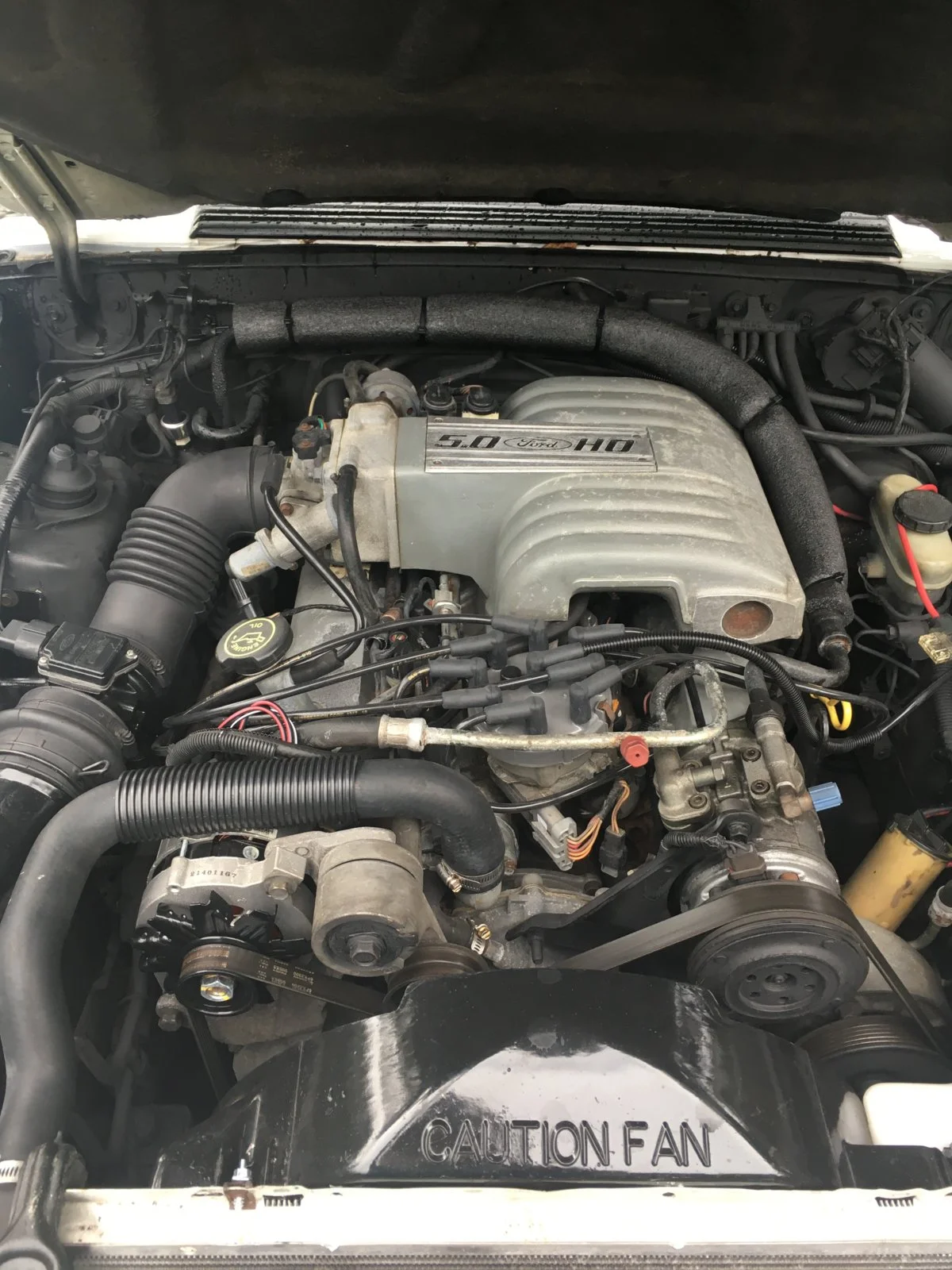

If you are really concerned, then address the cooling system with either a new coolant flush, or a new radiator, or install deflectors alongside the radiator to channel flow through it better. Also, make sure your fan clutch is in great shape and has resistance when you spin it by hand (engine off of course). When those go bad, they tend to freewheel loosely and don't pull as much air through the radiator.

A good radiator, fan clutch, shroud and the air dam under the radiator support should keep the temps at reasonable levels, I would say 195 to 220* or even 230* sitting in traffic with the ac on is reasonable.

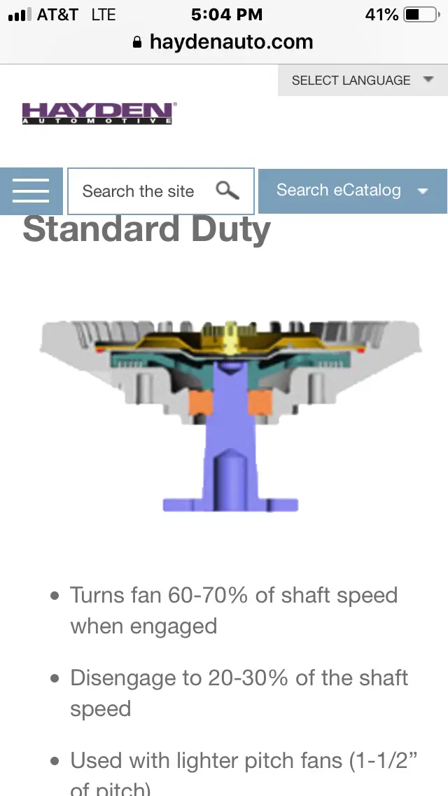

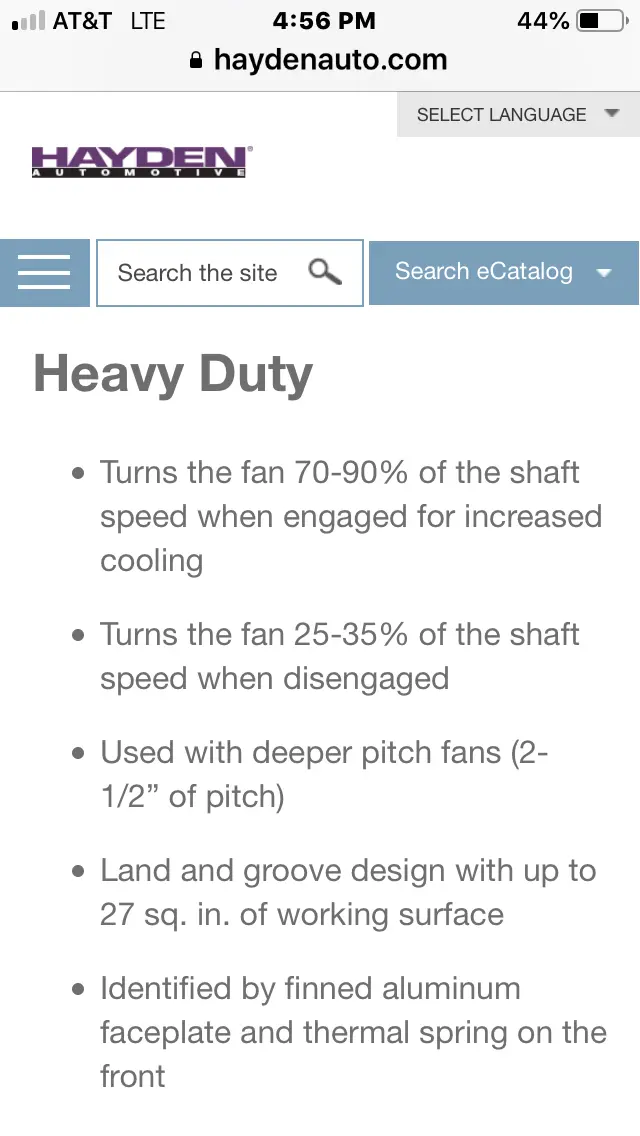

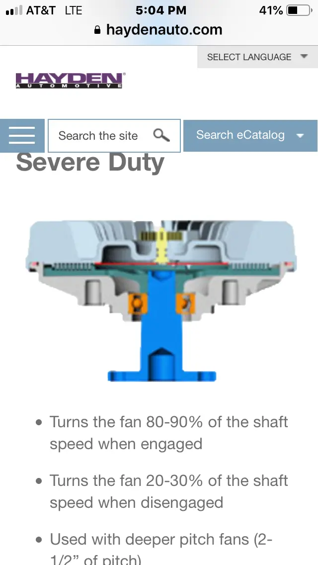

Thanks all for your input ! Highway cruise at 1900 rpm for 30 min at 65 mph yielded 230 temps in 95 degree air temps / high humidity ; same trip today yielded 218 temps but air temp was 82 degrees . It seems higher rpm and higher speed makes my car run hotter than low rpm stop and go city driving . It has a new Hayden heavier duty fan clutch , so I would think the fan would spin hard as rpm rise .i am thinking either radiator not flowing enough or water pump not circulating enough , could be a sticking thermostat ( but that is a new Stant 192 ) maybe this is how stock mustangs temps run with OEM style parts ( probably not many stock mustang people on here , lol )
Don’t know what timing is actually set at ( seems to run good - no bog or stutter - crisp throttle response , no ping or knock on 87 octane ) as for free flow spin , I know it does not spin at full speed of rpm - it’s next step up from standard duty ( heavy duty ) but below severe duty clutch
