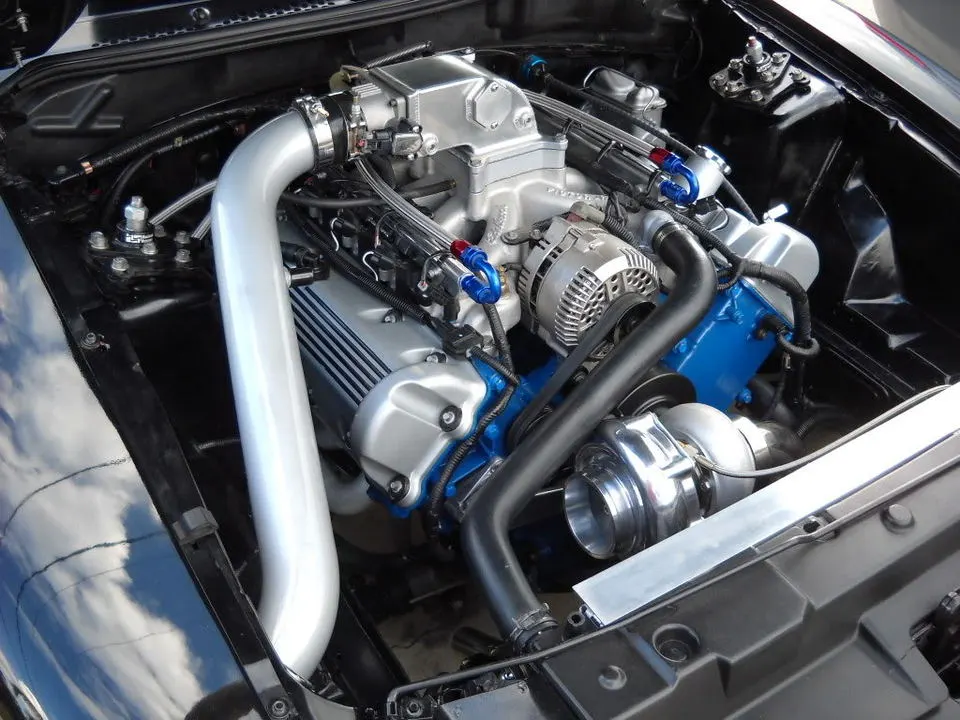

ill bet it could make over 700whp, on 13lbs i went 10.53@131 spinning with not a great 60' 1.66. im running the master power 76
BTW. it made 525rwhp on 10lbs, shutting the pull down at 5600 rpms becasue it was blowing the spark out. and pig rich!

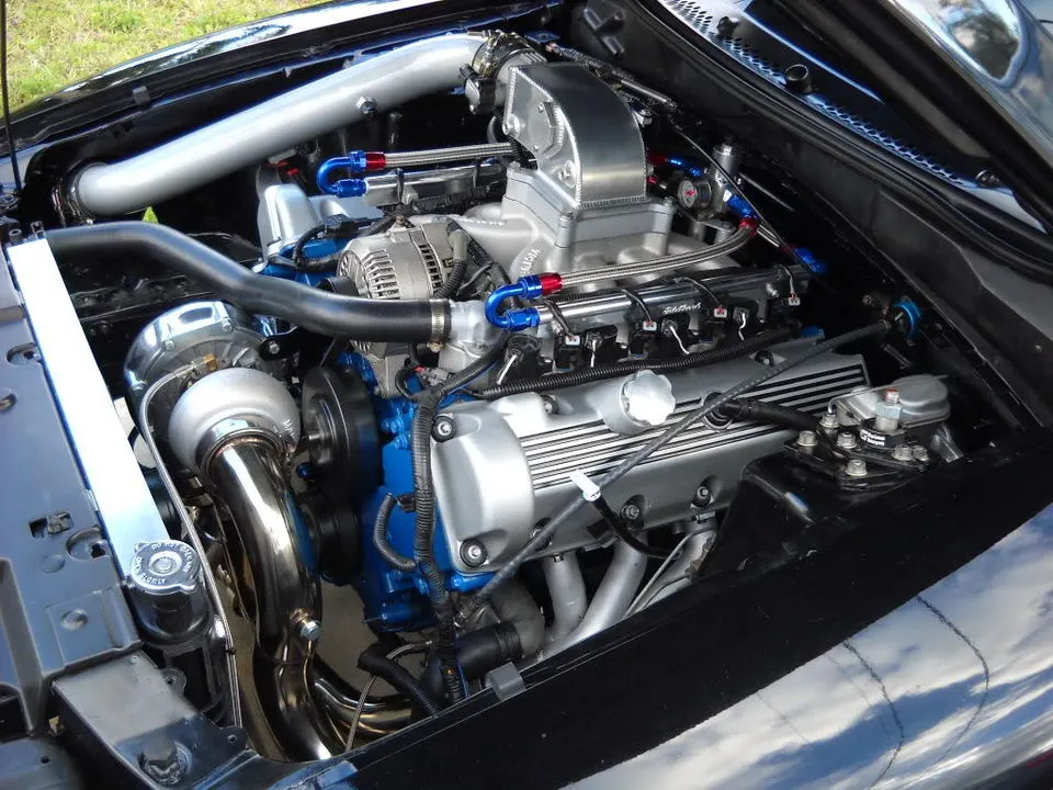

Wow, dude that thing looks awesome! Did u coat ur headers?
So, did u run into any issues with the install?
i will eventually coat the headers, thats the rattle can VHT but it works awesome!! at the time of the build i didnt wanna put out anouther $350 bucks for the headers and turbo hot side coating.
i had ZERO issuues with the install!! nothing!! its 3 simple Vbands and done! and i only have about 2700 in the kit and turbo!

i only know of a few people over the internet with the kit and all have had great results, i gaurentee it will make 700whp, a local buddy runs a 331, my my same turbo t76 Ptrim, car has went in the mid 9's at a best mph of 146!
car is a 331, but very close to my setup, same turbo, c4, gears and tires. he runs 20lbs on boost with a meth kit

hey i was reading about some guys having issues with leaks at the vbands, have u ran into any of this?
yea they do, cause there just cheap vbands. good ones are about 30 bucks each i just havent got them yet. they only seep a little, no loud ticks

When u say "vbands", are u talking about just the clamps or both flanges and clamp as a whole. I was reading that guys are buying 2.5 obx gaskets, trimming the bolt holes off, and putting them between the flanges making a good tight seal. What unthink about that? Btw, I sold my s trim today! I'm calling poweraddersolutions Monday to order my kit!!!!!!!!!
just the clamps! and yes ive been planning to do that for a while! lol
