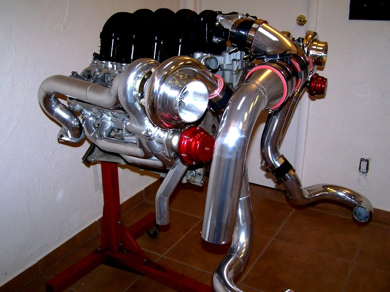

Long tube headers are the last thing you want on a turbo setup. With a turbo setup you want the exhaust as short as possible into the turbo. Long tube headers are great for NA and Supercharger setups but are not for turbo's. There isn't anything wrong with the hot piping on the S&H kit. A single kit, with rear facing exhaust manifolds, will require the exhaust to come back to the front and merge into a single pipe for the turbo mount.
The only other option with a single turbo is froward facing headers, which shortens the path but still requires a merge to a single pipe. Now if you want to talk twin setups, then you can have froward facing headers into each turbo like this.
This is the setup I have on mine. If you dont like the S&H kit then give Jim Napier at Turbohorsepower a call. Jim also makes a single kit and it is a very nice kit. He is a great guy to work with and will answer all your questions.
