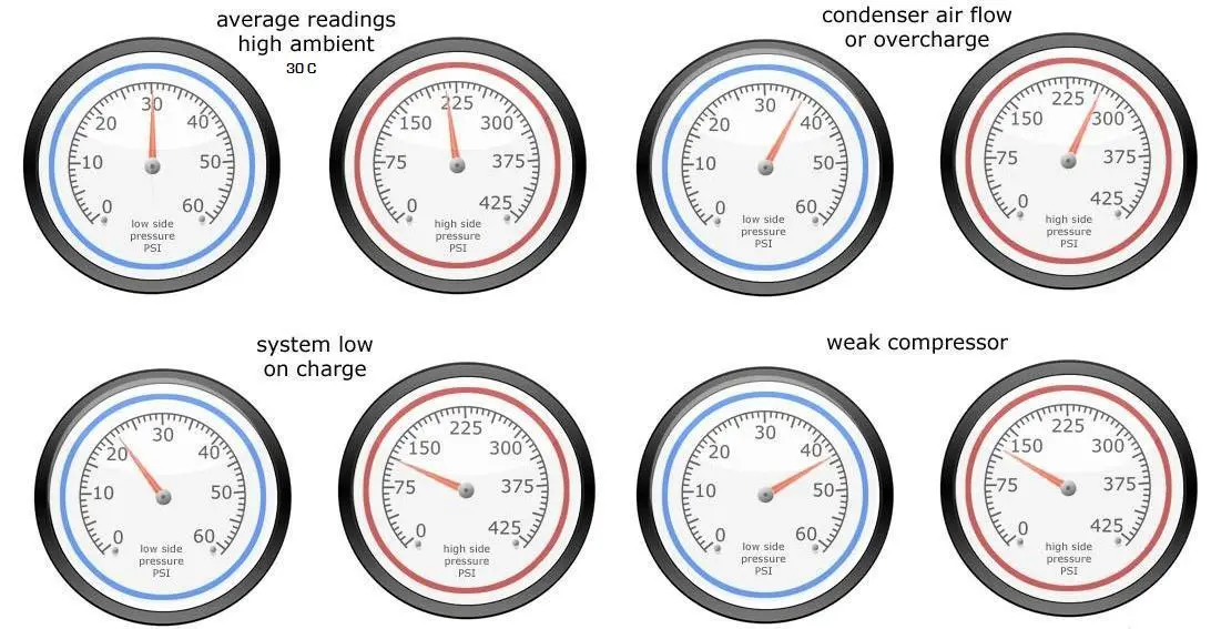

Ok seems the compressor is operating normal. I put a gauge on the low side no high side gauge, pressure shows about 45psi. I put the thermometer in the center vent and it read 60 deg. outside air temp 100. I believe it should be lower than that. I checked it on ac max, fan on high top down. No oily spots around any of the connection points. I think I will take it to an AC expert and have them evac the system and re-fill it. Thanks for the info everyone.
Reactions: Davedacarpainter
I do believe there is an error in the chart. Don't just take it for granted that whatever fancy chart you saw is correct.
If the high side orifice or expansion valve is clogged, you will have higher than normal pressure on the high side and lower pressure than normal on the low side.
