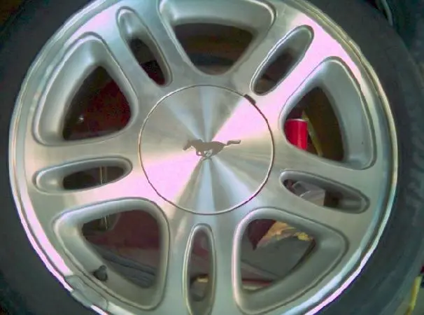

i picked up these rims for $100 for my 87 gt fox! Should i polish them? polish just the face? any opinions?
they're not bent, just a bad pic i took w/ my cell.

no i still need to convert em to 5 lug. Is there a cheaper way than buying a kit?
I remember reading a back issue of Car Craft where they used rear axles from a Ranger or Aerostar (same rearends) to convert to 5 lug. They had to use two of the same side axles for some reason (I think two lefts).
For those wheels, yes, you need the sn95 up front. However the ranger/aerostar stuff will work on the back until you decide to go 4 wheel disc.
See sig for the ultra buget 5 lug conversion look. SVO fronts - ranger/aerostar rears w/drums.
