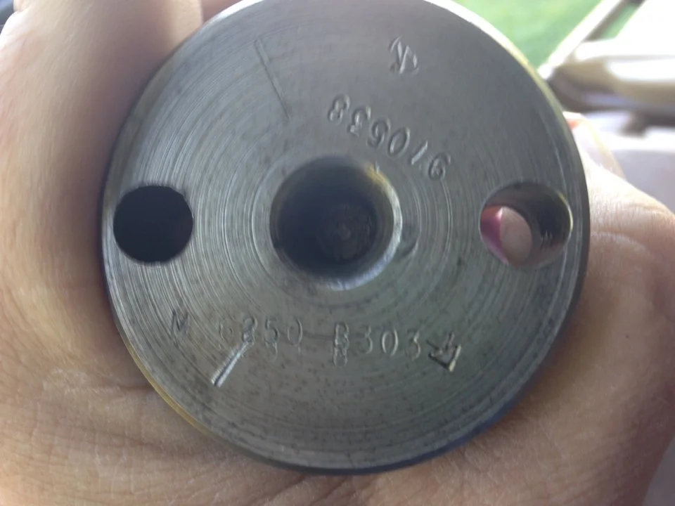

If you want to go through the hassle...if it's an alphabet cam it will have its designation stamped onto the end of the cam. You just have to strip it down and look lol. Waste of time really but just a FYI B303 for example. But like Mike said go with a comp 258,264,tfs 1,AFM n41,and Lunati has a good grind for gt40's(I can't remember the designation). Any of those would be a better choice but with your other parts there isn't a big performance difference.
