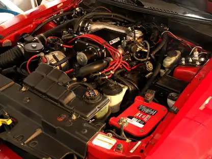

I've had my battery for 3 years and just noticed today the battery cable neck was warped because my battery has been moving side to side while driving and I found these today that can be used to keep it snugg in the stock battery box, just wondered if I could find one that is cheaper or if this is a good product, I measure my red top optima and I have i'd say 1/2 inch from stock battery holder block....... heres what I found to replace it with
I never really paid attention to it till i saw where my battery cable was warped where it been moving around than i pushed my battery to see how loose it was in the battery box and I could move it side to side so its not held down tightly so I hope that peice works, i'll order it tommorro unless you guys have a cheaper alternative than $25 lol

If you can find a galvanized metal strap, the kind that has a series of holes in it and is used to support the back side of a car stereo, you can make one for free. A few years ago, when I installed an Optima in my car and noticed the stock hold-down didn't work, I cut and bent a metal strap to fit. It has worked well, with no problems since.
