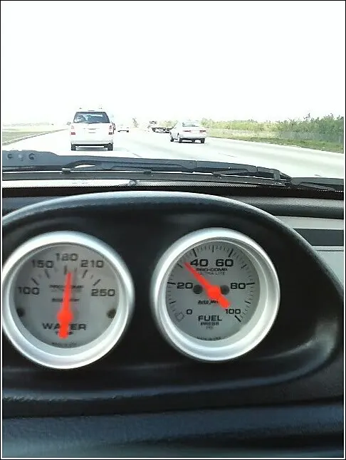

It should at least run at 180-190. That's where my 347 ran but never once got over 195 ever. I kinda had the same thing, I thought it ran too cool for Florida summers but 185 is optimal. I'd change your stat and if still it's running cool than install the 192 stat.
Posted these pics in the radiator thread but tells the tail of my temp during the summer.
