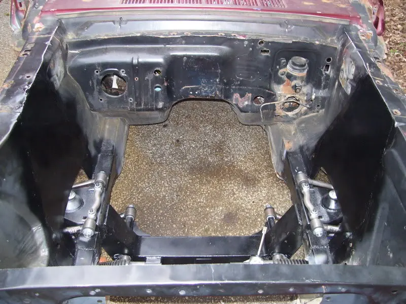

well, the bed liner I hear, being urethane based actually melts under high heat, is this true? at some point the car will be twin turbo(when I get to that point, a year or two away) I dont need my engine bay melting, or even worse catching on fire, I think I'll be going with some type of textured paint....I guess it depends on how clean looking I can get my sheet metal to look(heidts mustang II kit, welded in the patch panels they sell to be bolted in and filled the holes, have a lot of grinding and sanding to do yet) heres a picture of my engine bay currently...planning on doing a lot of work to it this weekend, filling quite a few holes all over the engine bay, grinding, sanding, etc
not too worried about cleaning up the welds...that will be fairly easy...the worst part is at the top of the inner fender where the metal is somewhat crumpled(was that way before the install too...I think the car was in a minor accident...no frame damage, but certain sheet metal damage
