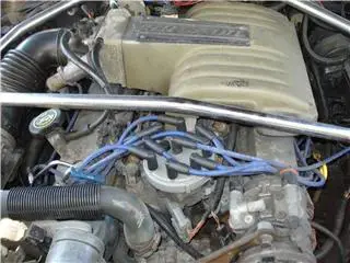

I have a 92 5.0 and it has 8.8 rear end aluminum driveshaft upgraded suspension
I would like to do some mods on the motor, bene looking at the trick flow stuff
I cannot afford the whole kit however, and want to do it piece by piece, which order should i install the components?
can the car be run between modifications? I know theres guides all over maybe for this I jsut want to know which order to purchase and install these parts and still be able to drive car between mods...
also, are these parts hard to put on? I have some skill with gettin the hands dirty but not alot
I have another car so its not my daily driver

It has headers and h pipe and flowmaster exhaust and knn cold air filter also has 3.73 gears
not sure if it has a good distributor
has 31 spline something i dunno what if you know tell me?
it has king cobra clutch and pretty sure its just a t-5 transmission
90% street 10 % strip
I guess if cheaper parts can be gotten that perform better let me know what they are i just thought trick flow was easy and already tuned and such
in the ultimate end i would like to put a supercharger on it, nothing big though
I forgot, it also has underdrive pulleys and some hyperdrive chip in the computer

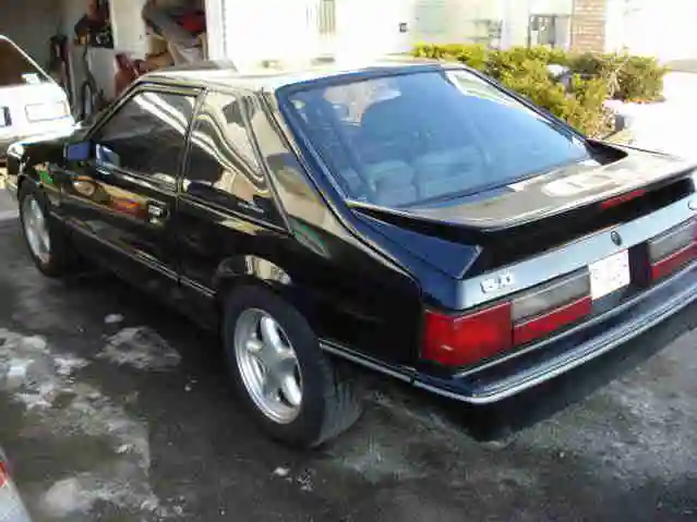

Ok thanks for the answers, looks like i should just wait and buy the entire kit at 1 time. I think the first order of business will be a repaint tho, I was recently involved in an accident and my suv was totalled, out of work for 3 weeks so im just waiting for my lawyer to do his job
How much should i expect to pay for a good repaint? car has basically no rust, only 1 small sport where paint chipped off and surface rust developed the size of a dime
do you want it painted black? like, touch-up in some areas and get rid of some fade? or totally different color? if you dont give them a rolling chassis, and you want a totally different color, there will be some black leftover, namely in the engine bay, door sills, gas cap, hatch lids, etc. If you want a different color, nows the time to tear it all down, plop the motor on a stand where you can work on it standing up straight (not hunched over a low-riding car), and send the paint shop a roller.
I'de go as far as buying differnt parts here and there when you have the cash, but I cannot see buying either of the 3 major componants of the H/C/I and installing them one at a time. Do it once and do it right:nice:
i want it painted black again, want all paint stripepd off and rust sanded down and painted all black again
1 place said 2500 for all dents and stuff removed
another place i talked to said 1500 for stripped and just the paint and a clear coat
Ill take your guys advice for just waiting to buy the entire kit depending on how much a repaint is will determine how soon i can get the kit hopefully within a month or so
