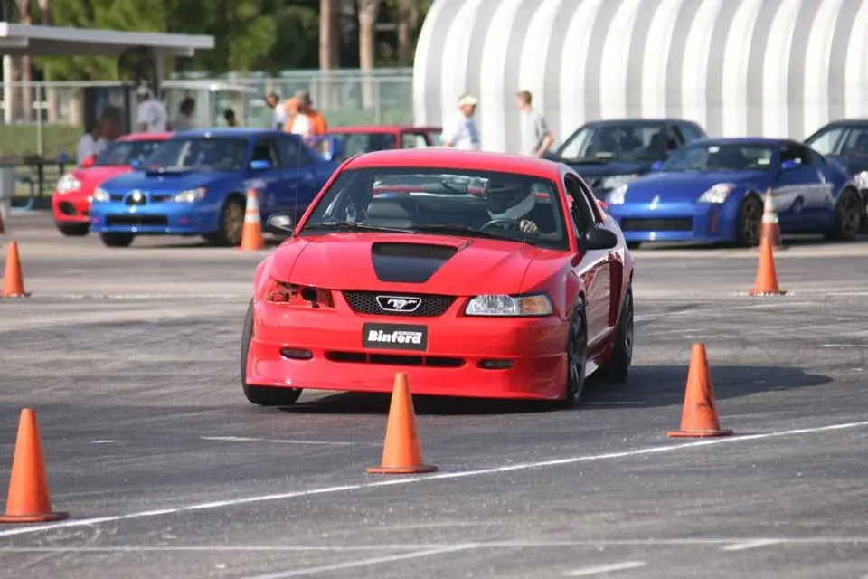

This is my car running NASA class "D", we were very limited in what we could do to the car since it was a "stock " class, this is a lowered car with otherwise stock suspension.
Tell me, do you see something wrong in this picture? This is one screwed up suspension, just like most other lowerred cars out there.
The bumpsteer kit and taller front ball joint made all the tires stay on the ground and made a huge-massive-explosive-excrement producing difference in the way the car hooked in the corners.
and can some mod resize that photo please.
