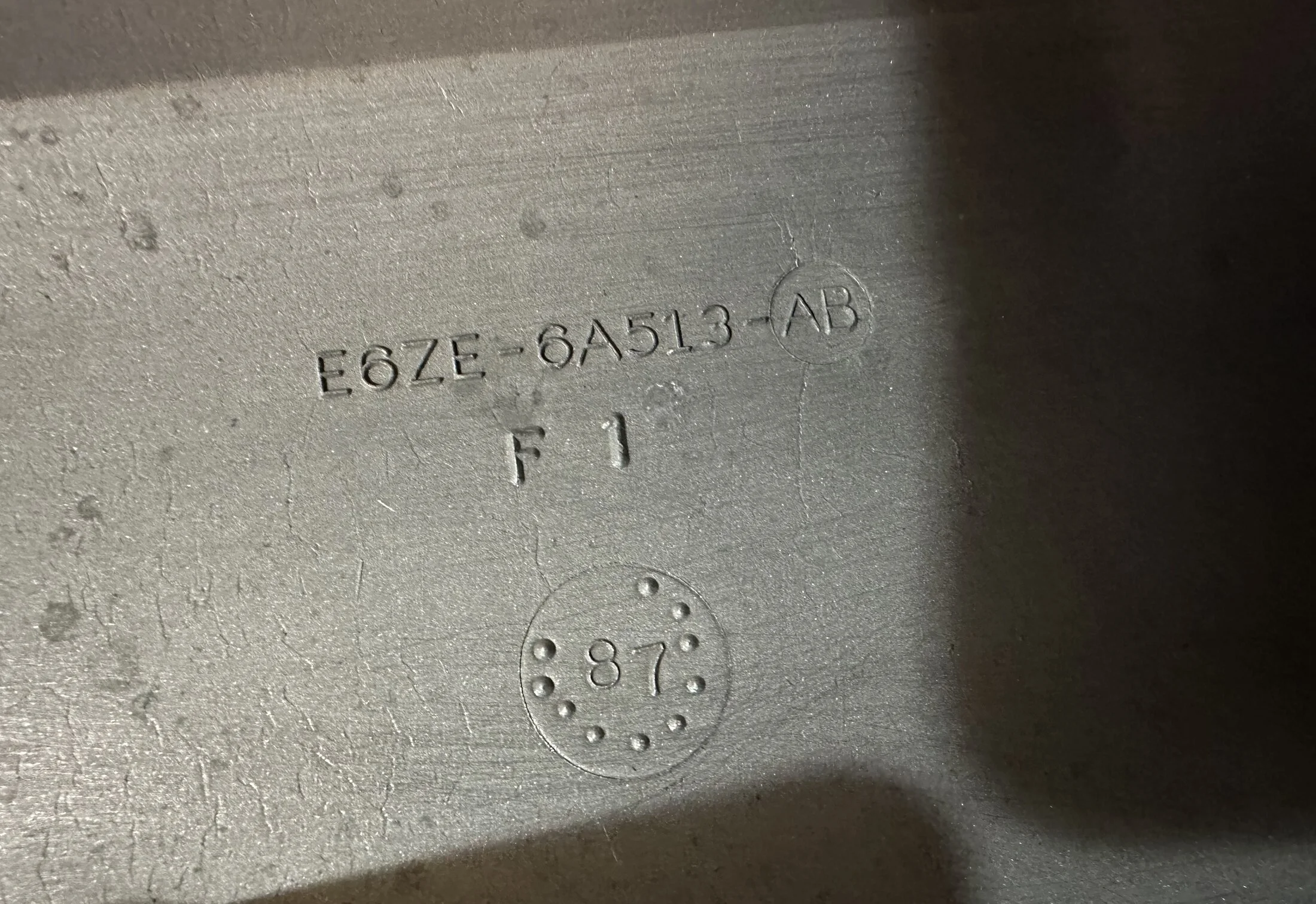

Inside the valve cover will be a part number E6ZE signifies a 1986 Mustang engineering part number, and the 87 in the circle is the actual year the valve cover was cast and the dots are the months. In this case, october of 1987 and these valve covers were on my ‘88 built in early 1988
