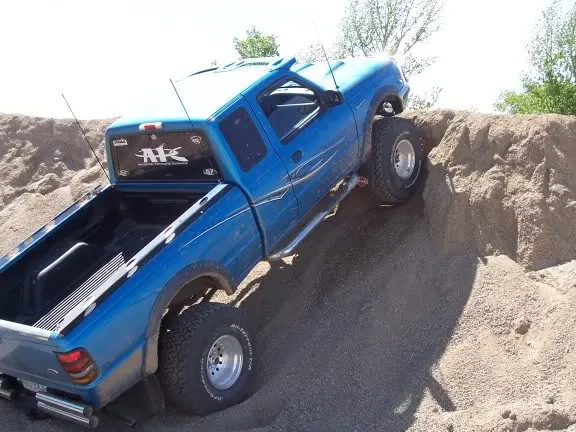

The clutch, flywheel and pressure plate for the pre-98 4.0 is actually an upgrade over the 2.9 clutch, and is pretty much a direct bolt in. Could be interesting to work a 4.0L into a II.
http://www.therangerstation.com/Magazine/May06/40_clutch_swap.htm
:nice:
