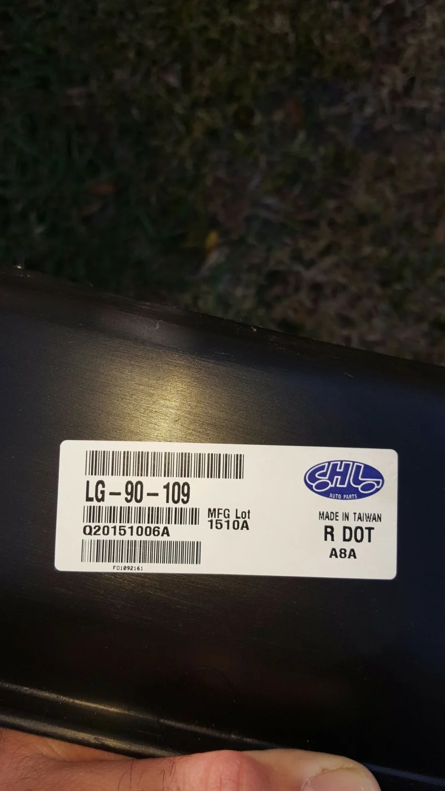

They are crazy cheap new, I think I paid $35 on ebay shipped...
@wiseguyk just got one cheap on amazon
I looked on amazon but didnt see. Can anyone post an amazon or ebay link for me? thanks
