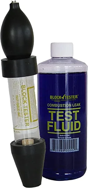

This will tell you if you have combustion gas in the cooling system. I believe it is what’s mentioned above. You can rent it at autozone. 7AF70836-887B-4A22-BB8E-814EC52C5B28.webp

Update: I rented the combustion test tool and bought the fluid. No emissions showed up. Thank goodness! So I tried to burp the system for the 4th time. Tons of bubbles and then suddenly... None. :O_o: must have had a pretty large air pocket.
What's strange is the car was running perfect for 500 miles after I installed the cooling components originally. Is it normal for an air pocket to show its ugly face so long after the fact? If not, what could have caused that air to enter the system if not the head gasket?

Bad head gaskets?
A good way if you have access to I/M test equipment is to smell for HC'c in the radiator
The block tests are not inaccurate but difficult to read correctly
I helped read several thousand tests at the dealer back in the day
By the time you get 5 technicians looking at a test liquid or a strip
You are getting sold head gaskets or worse every time!
Best test is from cold
Remove the radiator cap and start the car
Watch the coolant in the radiator (any bubbles = bad)
Old Faithful = very bad
Monitor air above coolant in radiator with I/M probe looking for hydrocarbons ( any = fail )
