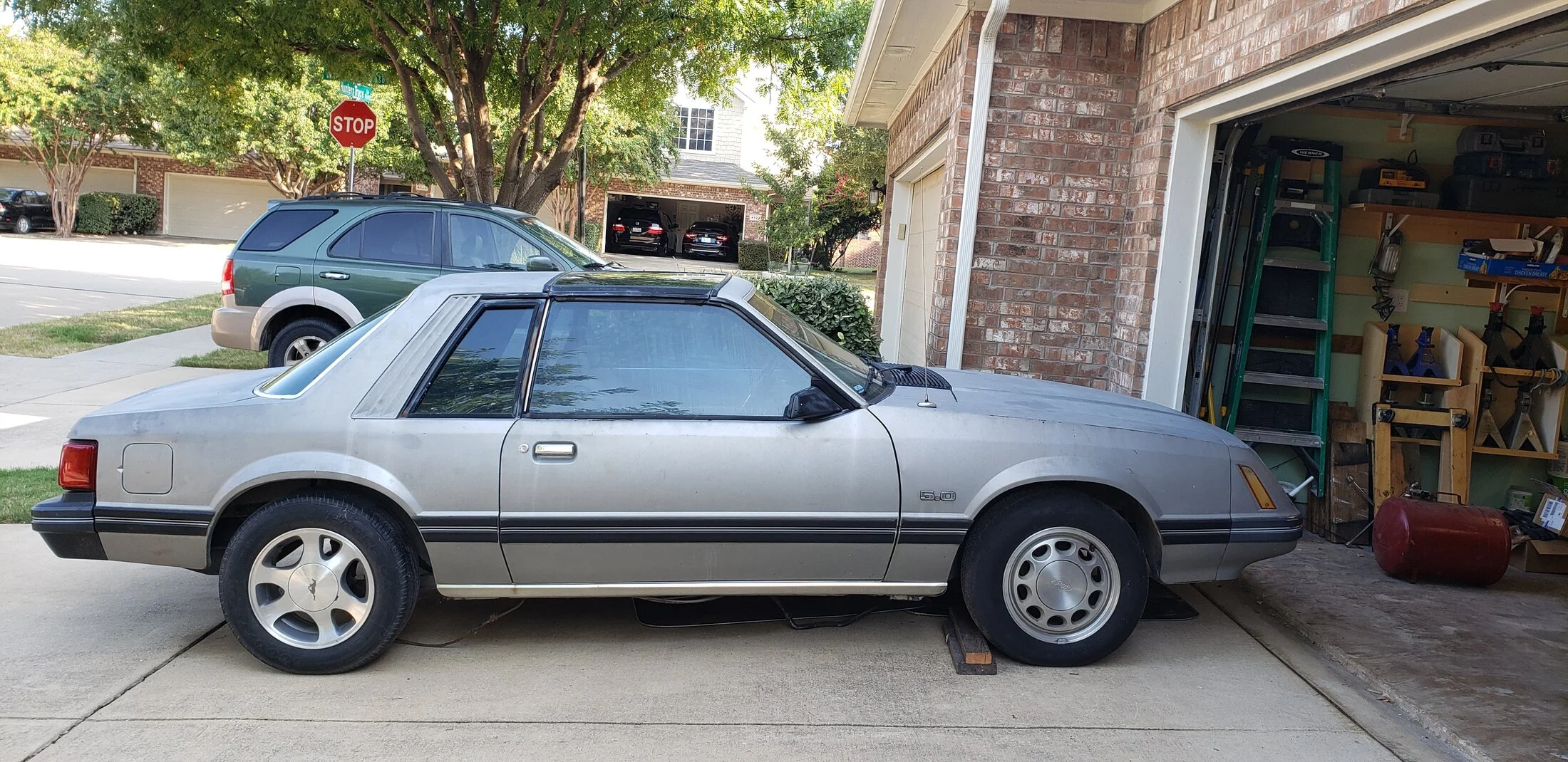

Silver 1984 Mustang LX 5.0 CFI AOD T-top coupe
Repainted cheaply in the mid-'90's. Badly faded soon after.
This picture taken in September 2019 after completely rebuilding / installing a 1995 disk brake 8.8 with 3.73's. Rear wheels are vintage 1999 V6 Mustang rims.

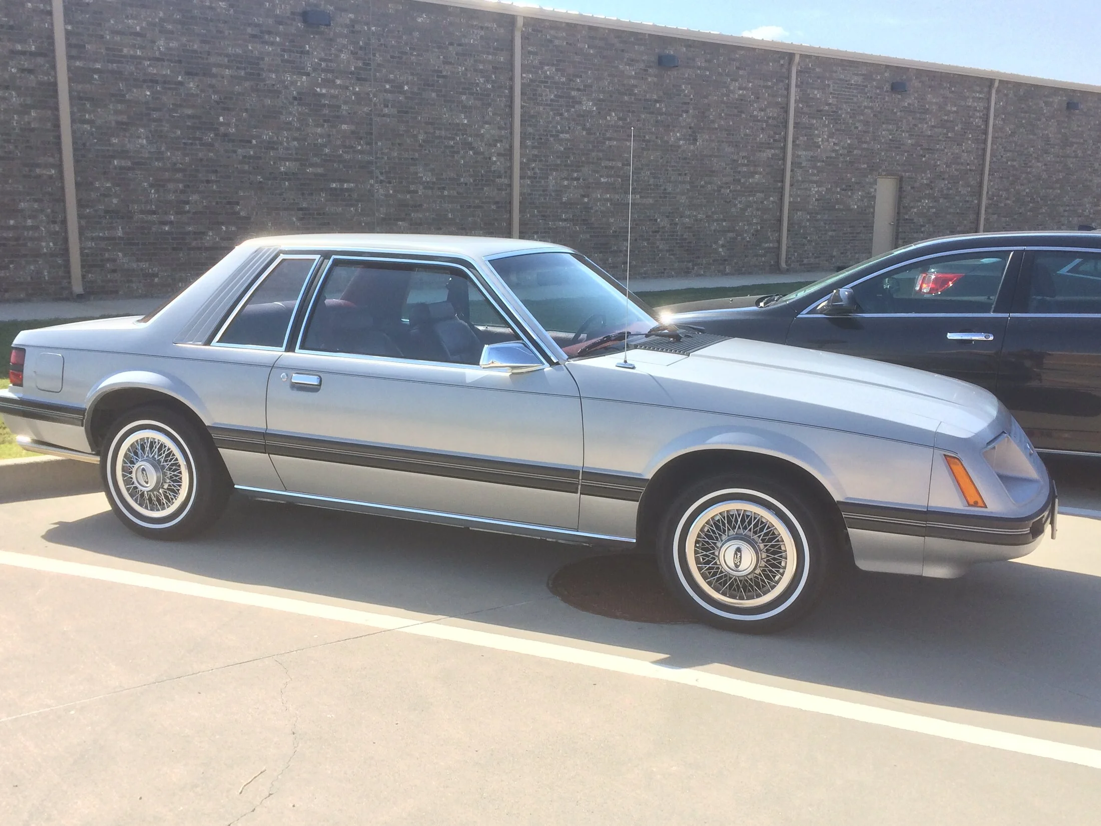

This beauty was found in a grocery store parking lot in Wylie, TX in 2016. Other than the whitewall tires and lack of t-tops it looks just like my car did in 1984 right down to the factory plastic wire spoke hub caps. My car was originally equipped with Goodyear Eagle GT black wall tires.

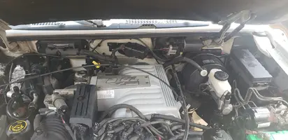

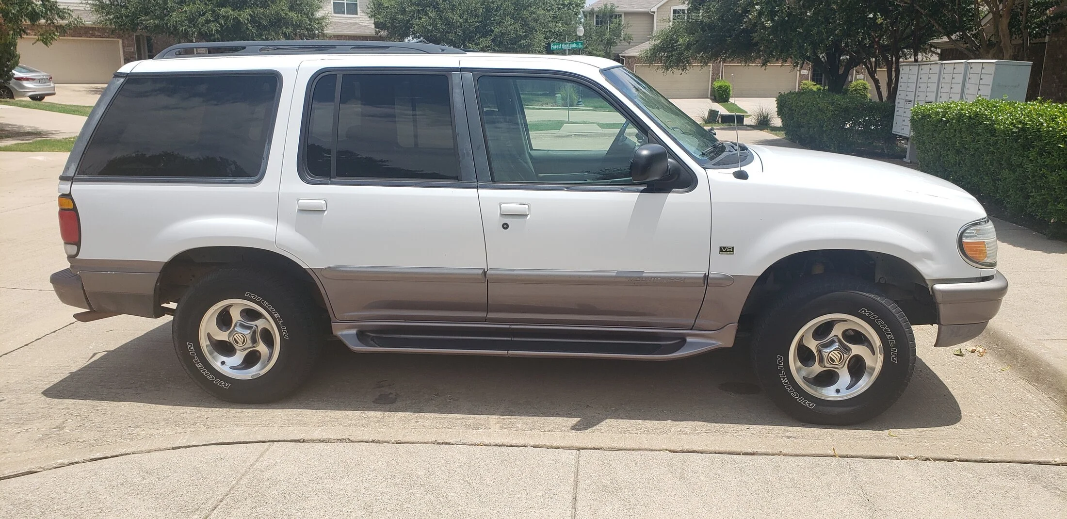

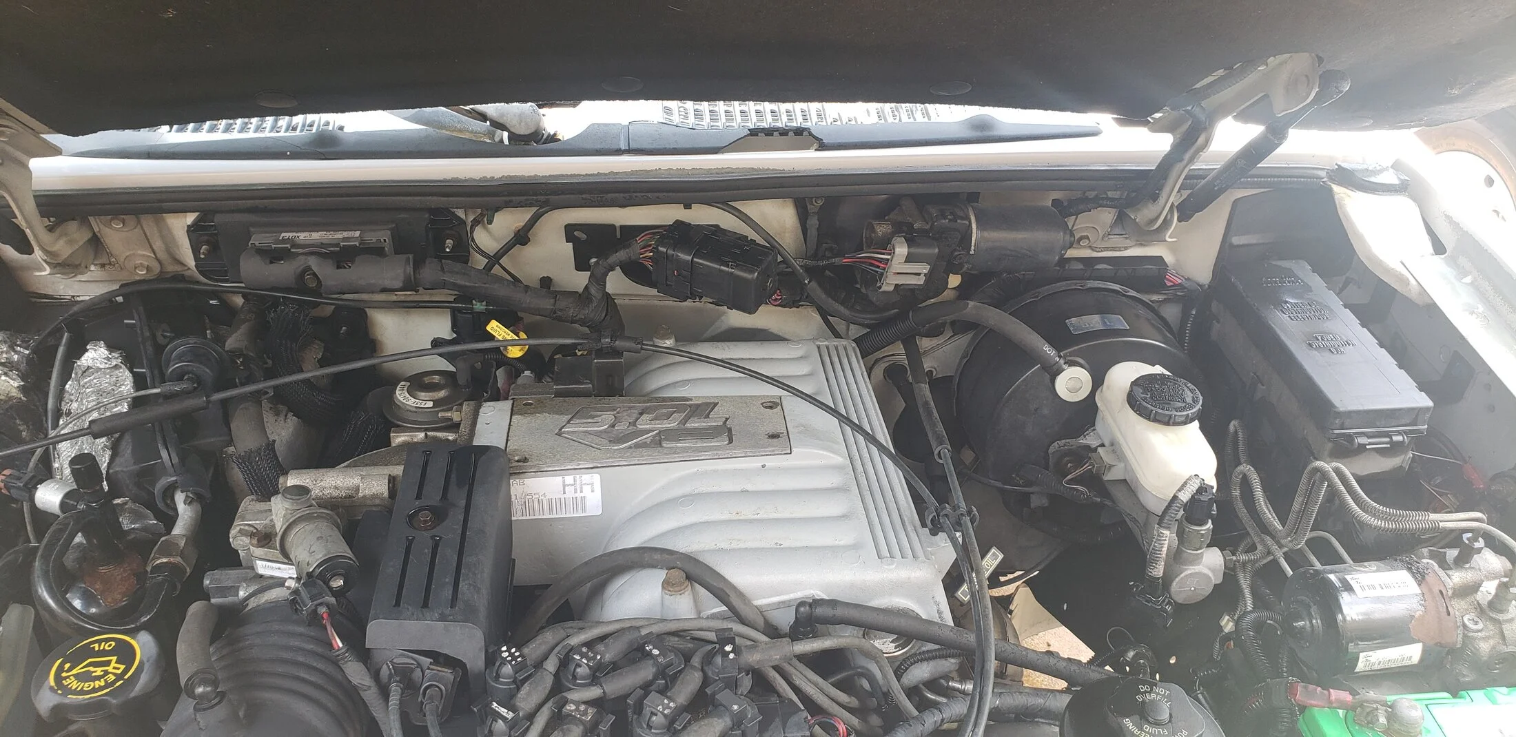

Picked up a new engine for the coupe this week. My neighbor and friend inherited this 1998 Mountaineer from his Mom. He isn't mechanically inclined at all so it has sat most of the last 3 years with very minor problems that he can't fix himself and are too costly for him to have a shop take care of. I've helped him with these kind of things many times over the years but work has me traveling most weeks now so time is limited..
This car lived its entire life in California & Texas so no rust. 155,000 miles. I spent the morning washing / vacuuming / cleaning as I prefer to work on clean vehicles. It was in dire need of all 3. When he mentioned that he was going to donate it to an animal charity in exchange for a tax deduction I asked him if he would rather have some cash vs. a tax deduction. We agreed on a price that he was more than happy with the next day.
It fires up as soon as the key is twisted.
It's 100* today. Blazing hot!

General, this is a clapped out AWD with the front driveshaft removed. He had some problem with the car 8-10 years ago and the shop he went to fixed it by removing the front shaft. It's been otherwise fine for him. Well, except that you have to set the parking brake everytime you park or it will slowly creep downhill.
2wd would be preferred but this was available the price was right!

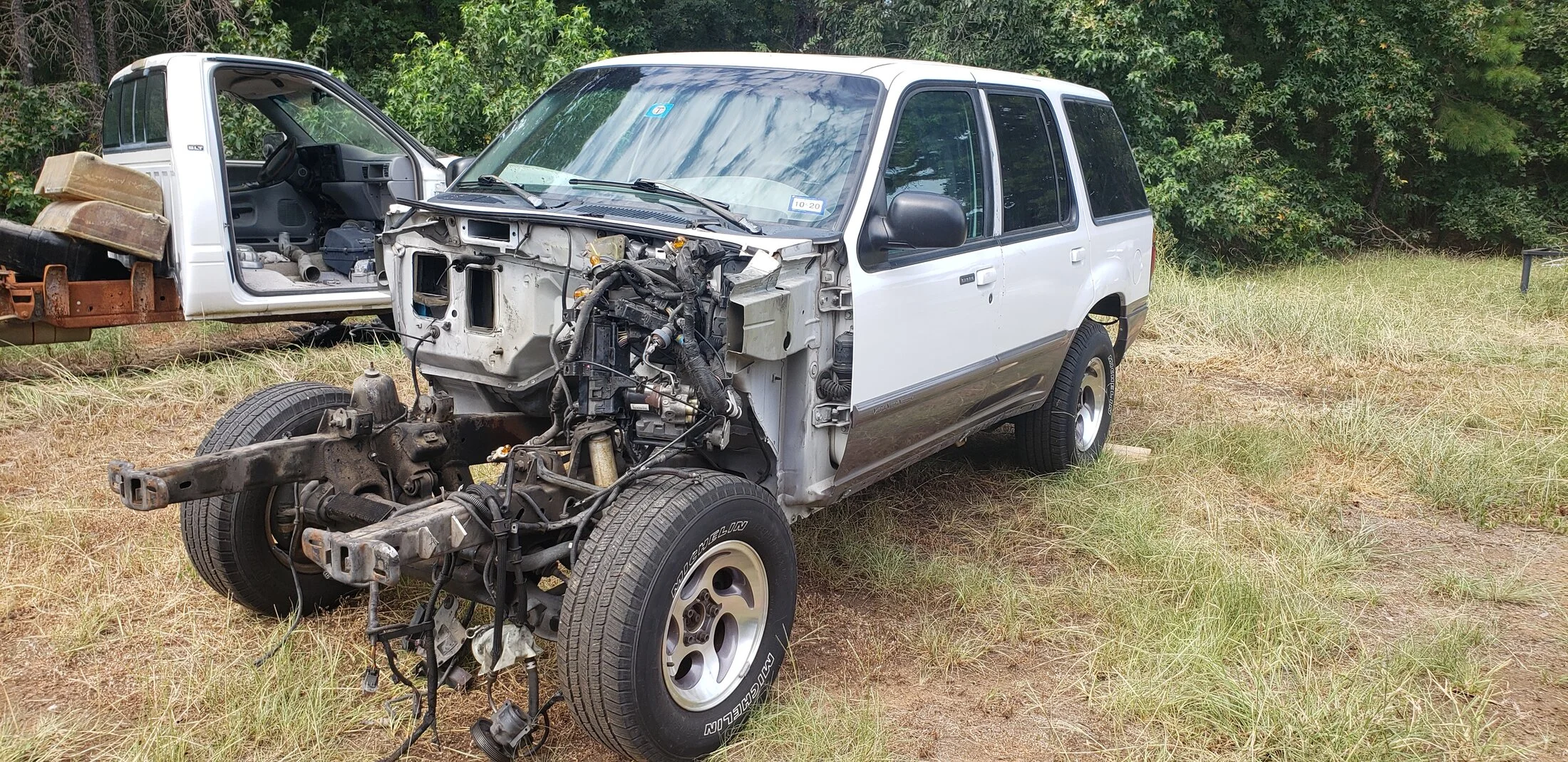

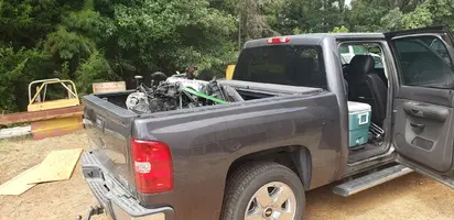

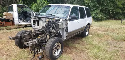

The last few weekends were spent with the Mountaineer. It got a good cleaning because I don't care for working on greasy cars, and then started taking off all of the easy stuff while it was still at the house.
Towed it out to a friends barn in East Texas for the rest of the work. It's a 2 hour drive each way and can usually only get 3-4 hours at a time in before I've had enough. The car is in full sun behind the barn and we have had 18 straight days over 100* It's hot!
This is the 4th car that I've personally disassembled over the years, all Fords, 2 were Mustangs. By far this has been the most difficult. The engine bay on this thing is tight for space. I cannot imagine doing this job in the summer in the middle of a U-pull-it type yard in just a few hours. I took the time to take apart connectors and all plastic parts without breaking so that they could be reused.
The Sawzall has become my best friend. Knowing that it wasn't going back on the road I used it liberally for access. Its much easier to break loose the driveshaft bolts when you are standing up looking down. :jester:

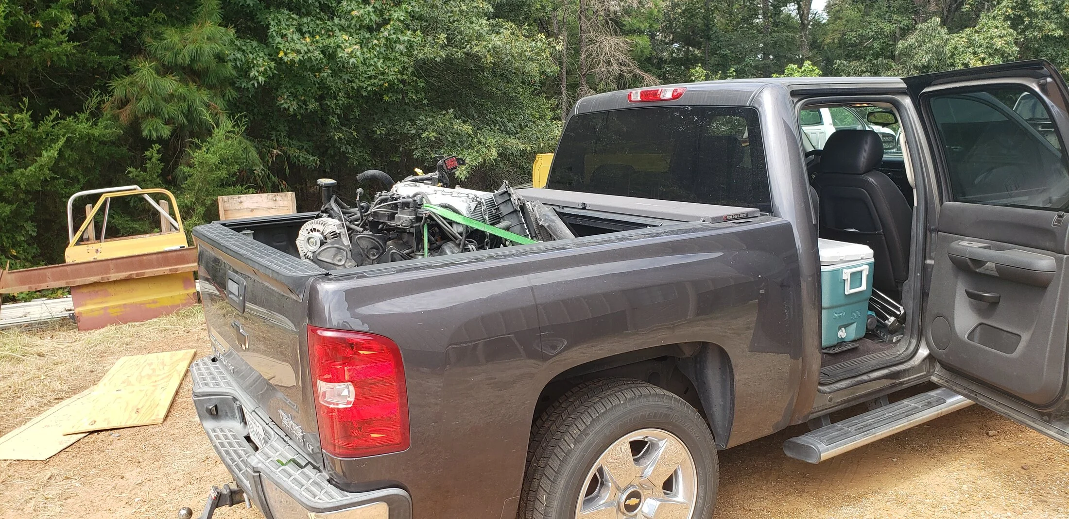

My buddy who own the barn and I decided to pull the engine / transmission together as a unit. With the core support cut off along with most of the front end sheet metal coupled with the large access hole inside it seemed that would be the cat's meow. Wrong! The transfer case sticks out and hooked everything. The Sawzall was up to the task and we finally got it out & loaded in the truck.
There are probably 2 more trips to east Texas to pull parts, haul the shell to the scrapper, and transfer the sellable parts to Plano before any meaningful work to begin preparing this engine for the Mustang can be done.

I think those 8.8 rears in that body style had 31 spline axles and carriers.
But the housing is offset
I think that you are right. I haven't checked this one yet for gearing / traction lock. It'll get pulled last, after it is on the trailer to haul off for scrap.
It seems like these were sought after by the classic Stang crowd as an easy upgrade to get an 8.8 w/ disc brakes. I think it was common to shorten the long side?
Wonder if these are still in demand?
