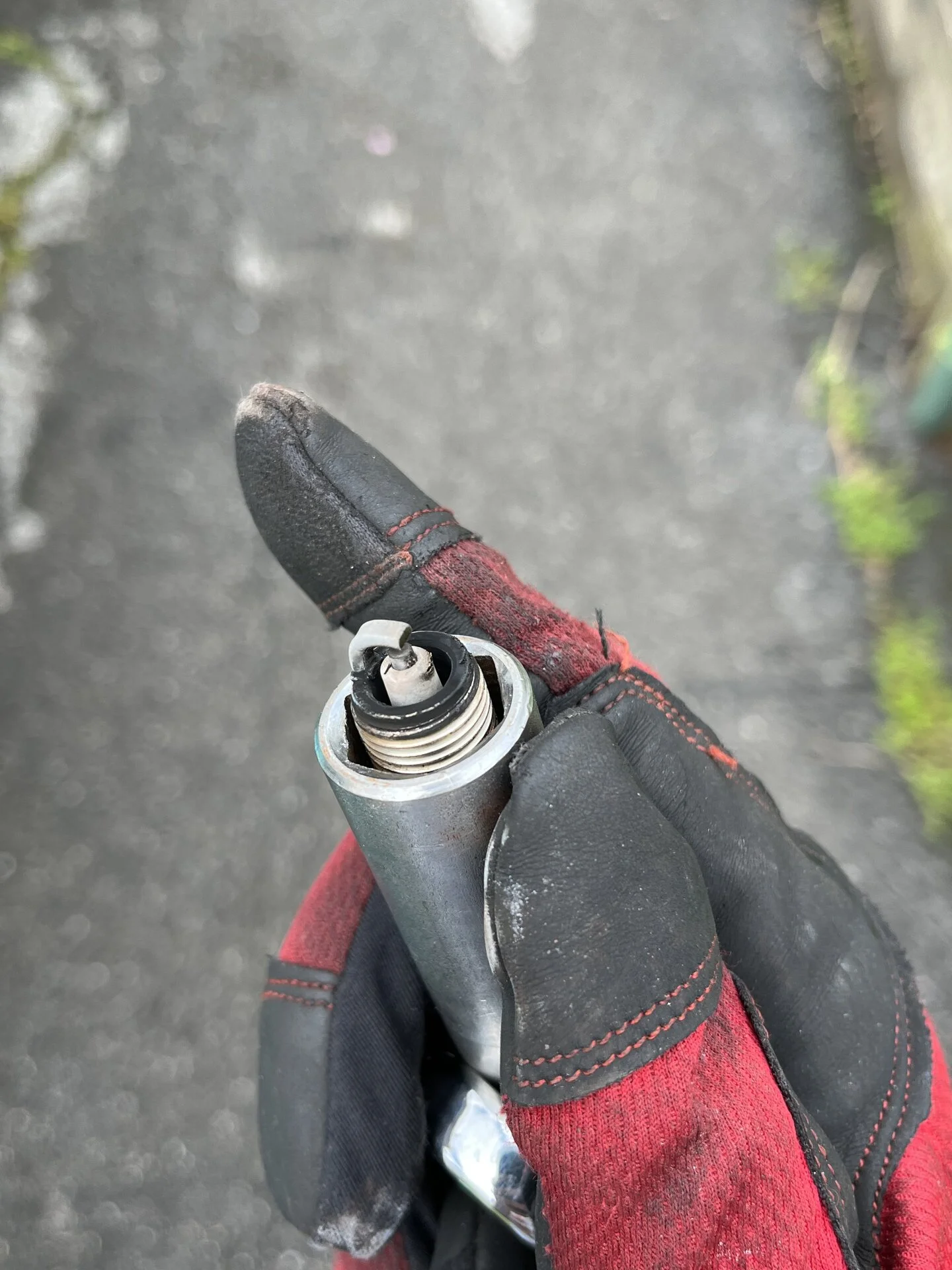

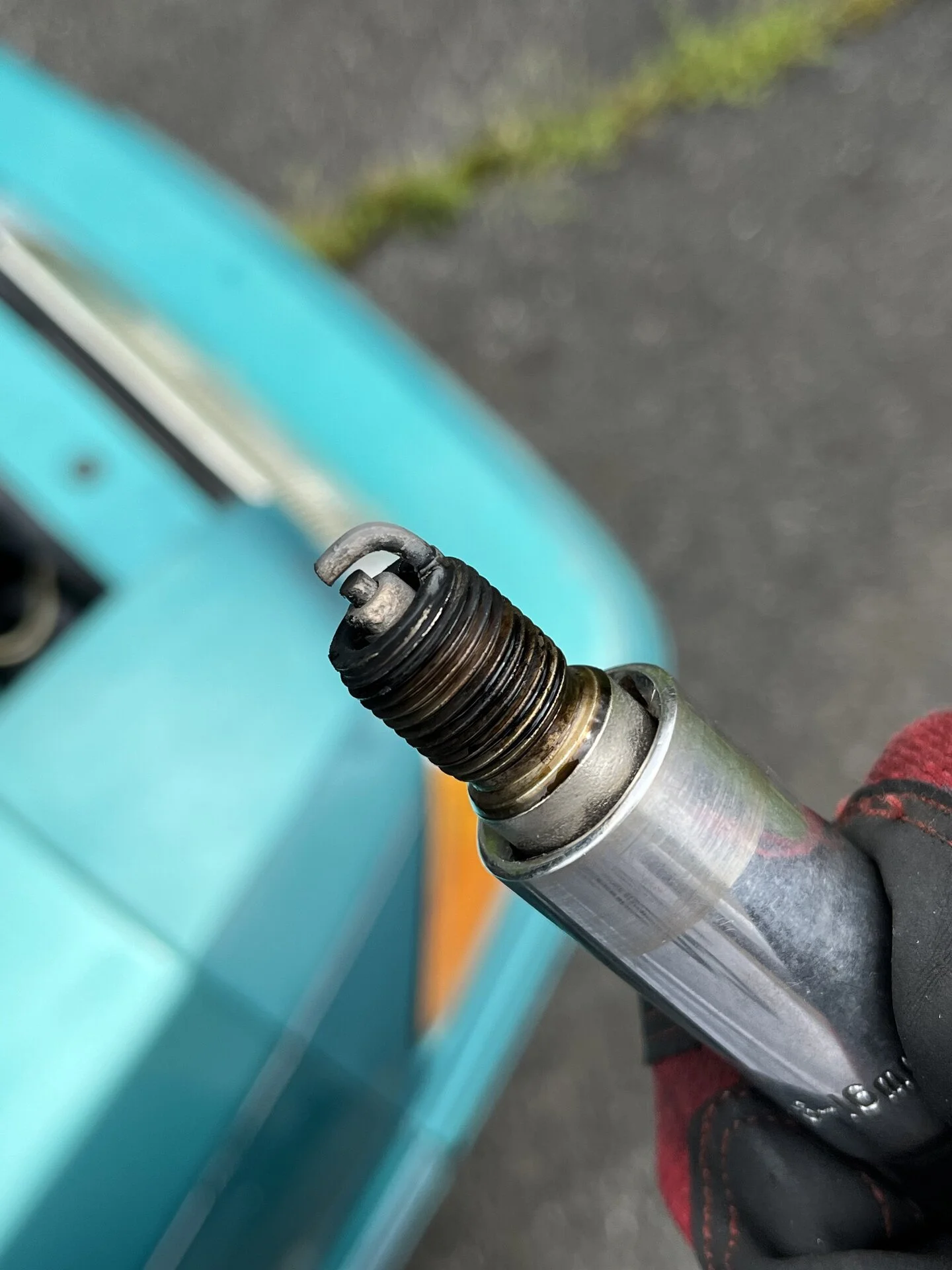

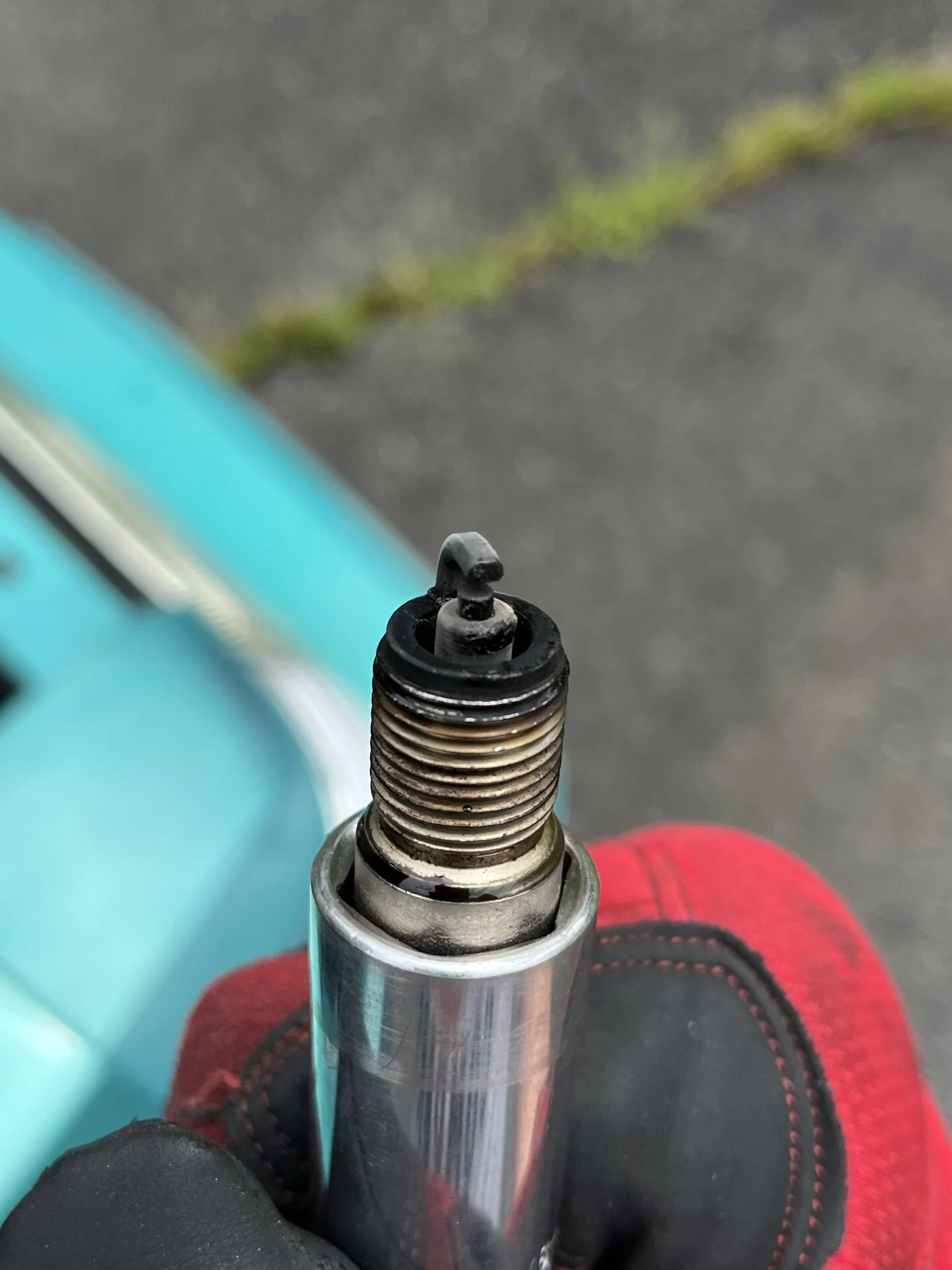

Here are some of my plugs. I don't think its a rich/lean problem

to me the white ashen look means too lean (hot) + the middle pic w/the lill mark on ceramic of center electrode ? The last of the 3 looks fouled (all the black soot inside the plug) which would B 2 opposites? 1st plug also a lill hot burning? I know this is not ur Q but did U use correct plug (did not take a colder or hotter plug for tuning or smething)?

Looking at those plugs and you can see theres differences in the cylinders and thats indicative of cylinders that are operating at different temps...

I should state that all the plugs are fairly similar looking. They all have a soot mark on them. It is where the plug is facing the cylinder. The last picture I posted shows the soot mark facing the camera. The second picture also has a soot mark, it was just facing away from the camera.
