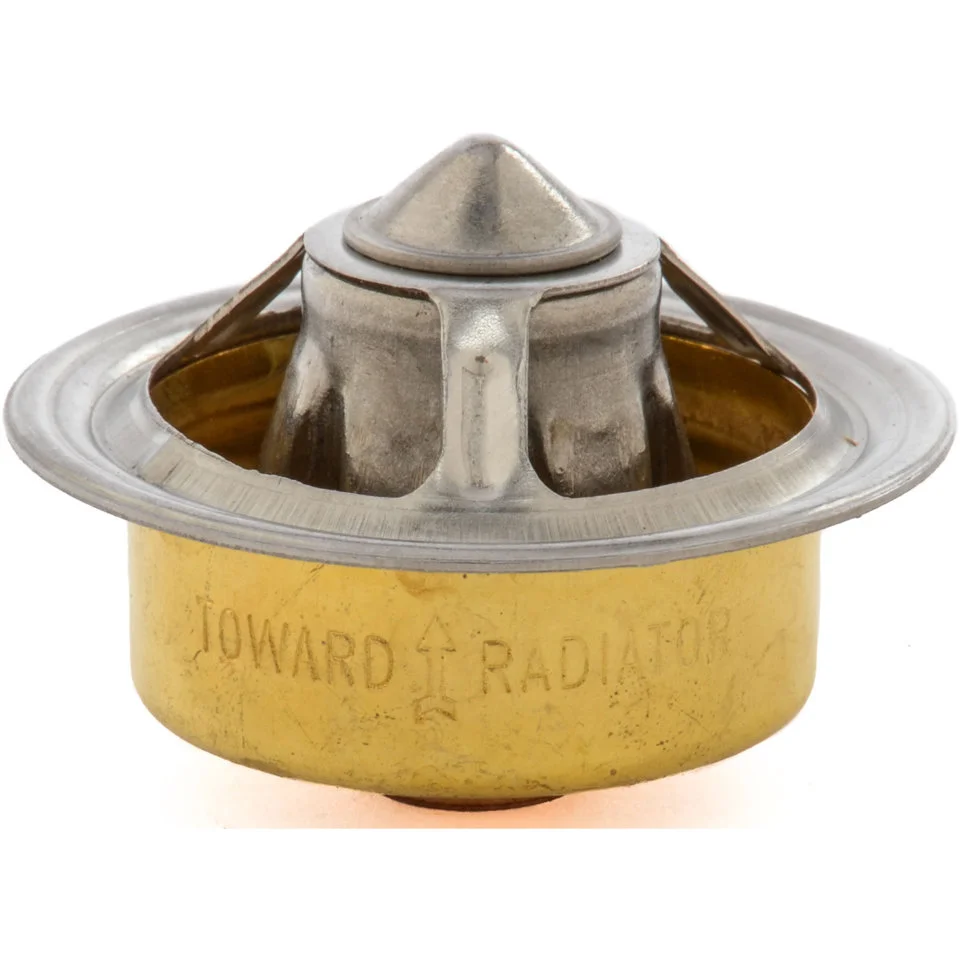

I have a high flow 165 thermostat that operated perfectly before the housing change.

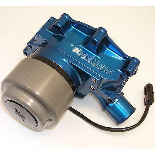

VERY IMPORTANT TO NOTE that this car came with a MEZIERE electric water pump & electronic fan (BOTH WORKED PERFECTLY BEFORE HOUSING SWAP)
The car starts, and overheats... I know the thermostat is opening because I'm getting plenty of heat.
I know the electronic water pump is flowing because I can see the coolant spilling back into the top of the radiator.
The car continues to over heat and fill the puke tank.
As soon as I kill the engine, the electronic water-pump sucks in the coolant that is in the NO-SPILL funnel...
But when I refill the funnel and run the car, it spills the coolant back out and overheats again.

2) If I can see coolant being pushed back into the top of the radiator the pump is operating correctly, right? In the proper flow direction.

so the rubber washer didn't magically vanish, It is somewhere whith your radiator, or water pump, orthermostat.or engine. You do not want to continue to overheat your engine That is when bad things happen. YOu should have never run the engine wiht that piece of rubber still in there. It either most likely clogged the flow tubes in the radiator or flowed through the upper radiator hose to the thermostat and hopefully didnt make it past the thermostat.
If it were me, I would pull the radiator out and hook up a garden hose to it and see if it is clogged., then remove the thermostat housing and thermostat to see if it is there and pray I found the washer in either of those places.
I understand it's in there somewhere... It just seems strange that a hollow rubber o-ring could cause that issue. I'll have to take the housing off and snoop around tomorrow I guess. Given the flow path, it would be on the intake side of the housing, correct?
