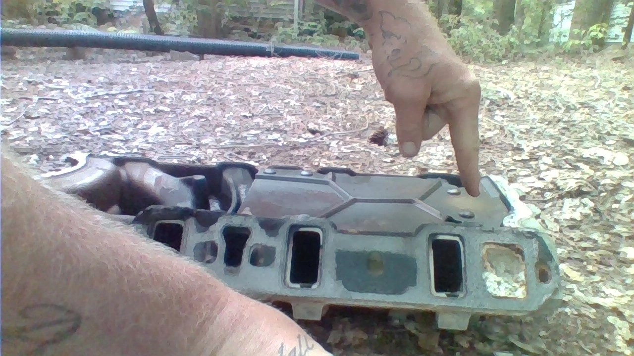

i have flushed system already just got done doing so. no head work but had a gt40 intake swap done but went fine like i said over heating came about after hose blew when setting timing ever since it over heats passed all head gasket test as well im stumped only thing i noticed i went back and looked at the old lower intake and one of the holes is clogged with white gunk its not a runner hole tho i cleaned the one out on the other side and its just solid behind all the gunk i will post picture

Pretty Nasty! The mystery sludge in your coolant passages is inorganic salt, separated and solidified from & within coolant, & possibly “hard” H20. Occurs in non-coolant changed Motors. Coolant containing inorganic salts, nitrites, phosphates and silicates.
Excess minerals accelerate the process. “Hard” water, an example.
High Silicate #’s cost less than running Ethylene Glycol, it lowers boiling points similar, & low temperature protection similar to Ethylene Glycol based Coolant. Cheaper.
Inorganic salts deplete within a couple years. Once depleted, they become slimy, pasty, cause restrictions, blockages.

The salts breakdown, slime to chunky masses, a pasty-like buildup shown in your Pic’s, that’s what’s inside your motor, now, narrow coolant passages most vulnerable.

Seen this before, only similars that mimic it are adding large amounts of coolant system “stop leak”, barrier at a leak, & wherever else it travels, any coolant lines..

Pull the Intake off & view the condition of the passages (Borrow/Buy a small tipped Borescopes for best views).
Just Heads up, next.
-If the Intake came from the same motor as the one pictured, Remove the buildup and spray out the passages with compressed air, pull the steam plugs out of the Block & flush it through (Plastic in the valley with rags laid atop, flat). Keep Other clean rags close.. Don’t want any getting into the valley, Oil.
-Run a high-quality coolant using organic-acid technology; “OATs”. This coolant type eliminates inorganic Salt issues due to their composition, eliminating corrosion, formulations May be used in many different app’s, and adding dissimilar coolant types if low(Use after doing tests, pulling Intake & viewing inside crossovers.

so i did a gt40 swap lower and upper intake swap 2 weeks ago car ran fan i was messing with timing when i didnt have the fan hooked up and lower rad hose blew off so i had a brand new upper and lower intake when it happened so no chunks could have fell in i go the combustion tester passed with flying colors. ibe yanked all p-lugs look great gonna yank them one by one might post video later of what car does i start it up and less then 3 mins shes nailed on the gauge and my IR reader says 274 degrees at the thermo housing

Well, using the same motor may have the same deposits, you flushed it, hopefully ran good Glycol Coolant, will eat away at what’s still in the Block. Is the Heater core clear- (garden hose), or temporarily bypass it with a lazy loop.

hey man thanks for all the info i got the upper and lower intake yanked also have the head on passenger side off now boy what a mess cylinders filled with coolant blown head gasket i assume now from here i will clean up all parts old gaskets etc and do one side at a time is there a drain plug anywhere to drain block of existing coolant? i need engine clear and free from all coolant thanks
