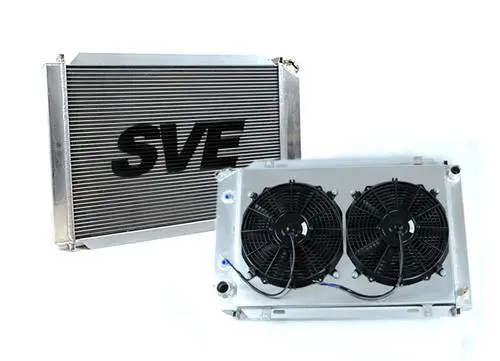

Wednesday, I have bought the Derale Fan cooling kit (#DER-16749), aluminum radiator, and upgraded the electric fans that LMR had. I am hoping this is the issue, but I am here asking if you fellas have any other ideas of what it could be.

My pretty setup on the way! Should be here tomorrow!!!

Well, that settles that, time to get rid of my AC!!!! Lol yeah right, I actually enjoy having it lol. I am hoping this new radiator, and electric fan (whenever LMR gets it to me) will take care of all my issues.
On a related not to the fan, LMR was able to replace my fan with the correct one, and I should have it by Friday!
Just an update, since it seems like its not done a lot lol. I put my starter solenoid in my inner fenderwell, and put my fan relay switch in place of the solenoid. I started the car, front up high up in the air and added the coolant. All air bubbles out and let the car war up for like 20 minutes and didn't get hot at all! Got the car down, and realized that my tire was going to hit my solenoid, so I moved it behind the strut, where it should have been in the first place lol. I starter her up, drove her home and on the highway, guess what?! LOVELY, its getting hot, but wouldn't "overheat". I got home, was trying to listen for the fans and I couldn't hear them. Popped the hood and realized that my positive wire had came loose and had no connection lol. I reconnected it and have been driving it for two days with no issues!!!! WOOT!!!
So in this case, replacing the radiator and fans and a proper purge of the system, it has taken care of the overheating issue!!! Thanks a lot for the tips fellas!
