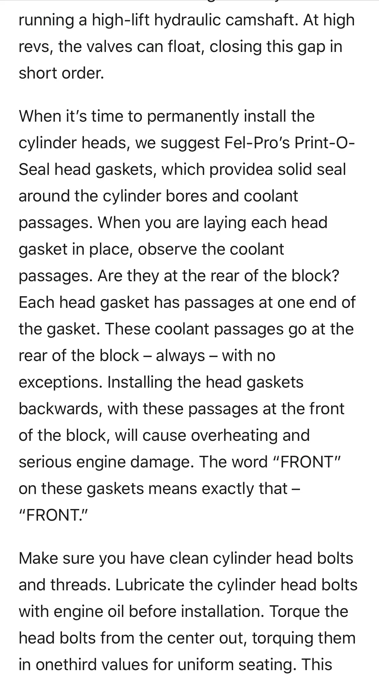

First off even a competent mechanic can make mistakes, but I would think that you would have an overheating problem from the first startup. We had a car come in with the backward gaskets and it would overheat within a few minutes.
