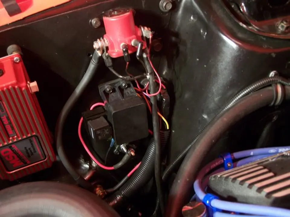

In the course of adding accessories to the car (Taurus Fan, MSD, 3G, Battery Relocation) I've made it very difficult to get all the wires I need running to the positive post on the starter solenoid on and tightened. I can barely get the nut to thread. Do I risk any damage to the solenoid like this? Also, what would be the best solution for fitting all the wires on there? some sort of standoff post?
Thanks
Hmm that sounds like a good idea. Do you have a link to a part or part number by any chance?
just something like this, with or without fuse.Usually about 10-20 bucks
3158736
I had a similar problem.
An easy fix is to use 1 crimp connector for multiple wires. Take off all of the existing crimp connectors and replace with 1 larger connector.
