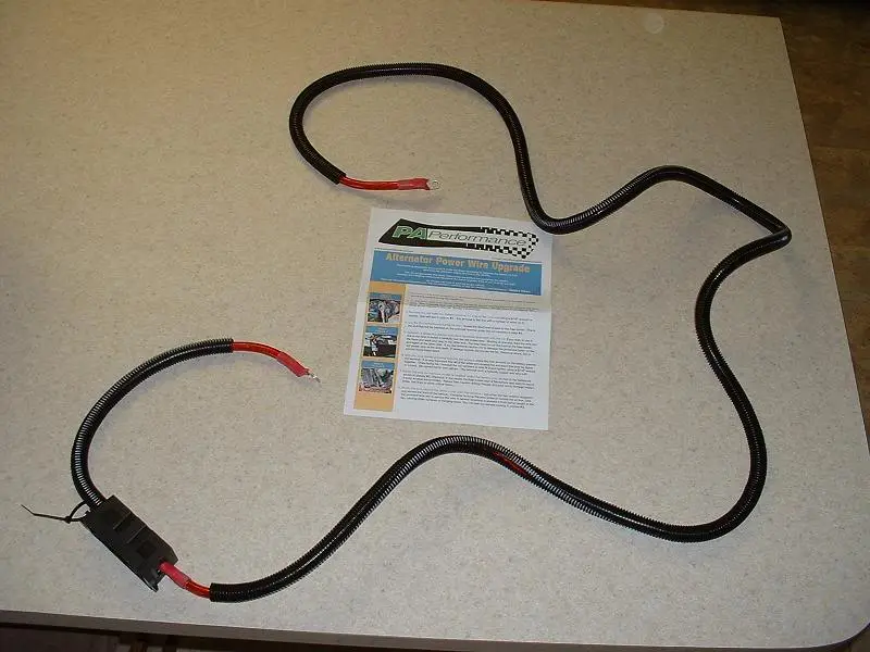

the PA power wire is nice, but it's nothing you can't make. it boils down to if you feel like messing with it or not. i decided not to mess with it as mine died before i was ready for the project so i just bought it to avoid hassles, but it looks fairly simple.
PA does include instructions but the damn instructions say to re=connect the black and oranges to the alt in addition to the new 4 ga wire, which i think by now has been proven to be a not so good idea..........other than that.......it worked just fine.
it is basically just the correct length of 2, 4ga wires with lugs(eyelets) on the ends, the fuse, fuse holder, and that black wiring tubing/conduit/wiring loom stuff.

Do not by any means reuse the stock power wire. It's only 10 gauge and could overheat leading to some bad things for your car. That is why PA sells the new power wire, it's 4 gauge so it can handle the additional amperage of the 130amp alternator compared to 65 or 75 amps from the stocker.
