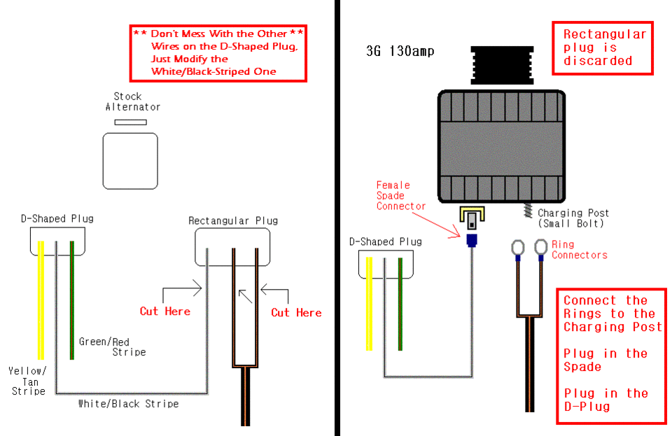

this may help some. just don't hook the 10ga wires back up though.

ok so that diagram kind of confused me. so i cut the black/white wire and then that plugs in to the back of the 3g? or am i missing something? so what goes over to the starter relay?
Yes, that wire gets a spade terminal and gets inserted into a dedicated plug on the 3G (your 2G did not have a separate dedicated plug for this wire).

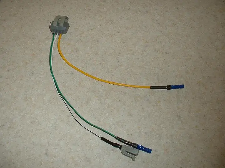

yes thats correct, what hissin said about the wiring. if you decide later on down the road to disconnect or remove the old wiring you then buy a 3g connector like this one in the pic, or theres another plug available from www.fordfuelinjection.com.
the one in the pic came from www.50resto.com.
these plugs basically when spliced in eliminate any need for any of the old wires.
the regular way with out using the plug, and just leaving the one plug disconected works fine. my stock plug went bad so instead of just replacing it i bought the 3g plug.

ok so let me recap, this is what i have sofar towards this project. new 130amp alt, 12ft of 4 gauge wire, a 100amp circuit breaker, and the rings for the end of the cable. what am i missing? and all i have to do is clip the white wire and splice it into the spade connector and other than that all i have to do is run the 4gauge wire for the power wire. so there should be nothing running to my starter relay right?
yes you'll have the other end of the 4ga wire going to the selenoid. thats where the black and oranges go too. those black orange wires turn into another color wire that hooks to the selenoid. this wire must stay connected at the selenoid in addition to adding the new 4ga charge cable. however, at the alternator end, you only connect the new charge cable and not re connect the black and oranges.
basically, the stock alternator uses two electrical plugs. the 3g uses one big plug from your original 2g set up, a small plug for the stator ( white.black) wire, and the main 4ga power wire from the alt to the starter selenoid.
one of the 2g plugs right into the 3g, the other one has a white/black wire and 2 black.orange wires. you clip that white.black wire from that plug, put the proper connector or use a spade terminal on the end, and plug that wire into the small wire connector on the new 3g alt. then run your power wire from the alt lug on the back of the 3g to the positive side of the starter selenoid, and thats it.
as mentioned previously thats the basics, after you get that done you can choose if you want to clean it up any by using a new 3g plug to replace the old modified 2g one......
