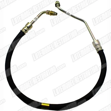

Does anyone happen to have the part numbers and a little insight on the hose swap for the power steering?
I got to work yesterday and probably half of what was in the reservoir was sprayed up against the underside of my hood. No mistaking what it is because I run the Royal Purple.
I've not had the chance to clean everything up and pinpoint the leak but when I got to wrk the whole driver's side of the negine bay was sprayed with the exception of the pump housing and lid.
So... I'm pretty sure it's in the upper loop of the pressure line somwhere. I follow the line down as far visually, as I could without crawling under the car and see that is disappears somewhere over the k-member.
How far back does it go and what type of fitting will I find at the end?
Guess I can't gripe too much. Those hoses been in there since Mid-year 85. :eek:
Thanks,
The pressure line just connects to the rack not too far under the k member.
Looks like this:
Not sure if your car has AC or not but here is a link for without AC:
1983-86 Mustang Power Steering Pressure Hose, Exc Svo, Also Fits 87-89 5.0L Without A/C at LRS - Same Day Shipping!
