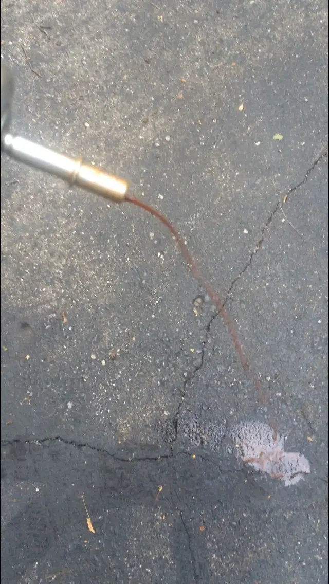

I was hoping it would only be a clogged fuel filter but upon replacing that I found the fluid that poured out of the IN-side of the filter was very rusty.
I dont want to give it to the shop and have them replace the fuel pump.
Anyone has an idea what is going on here? Should I just start with a tank cleaning?
THanks for your support, if it will work I could also upload a Video of me pouring the fuel from the filter....
Attached a picture of the rusty fuel:

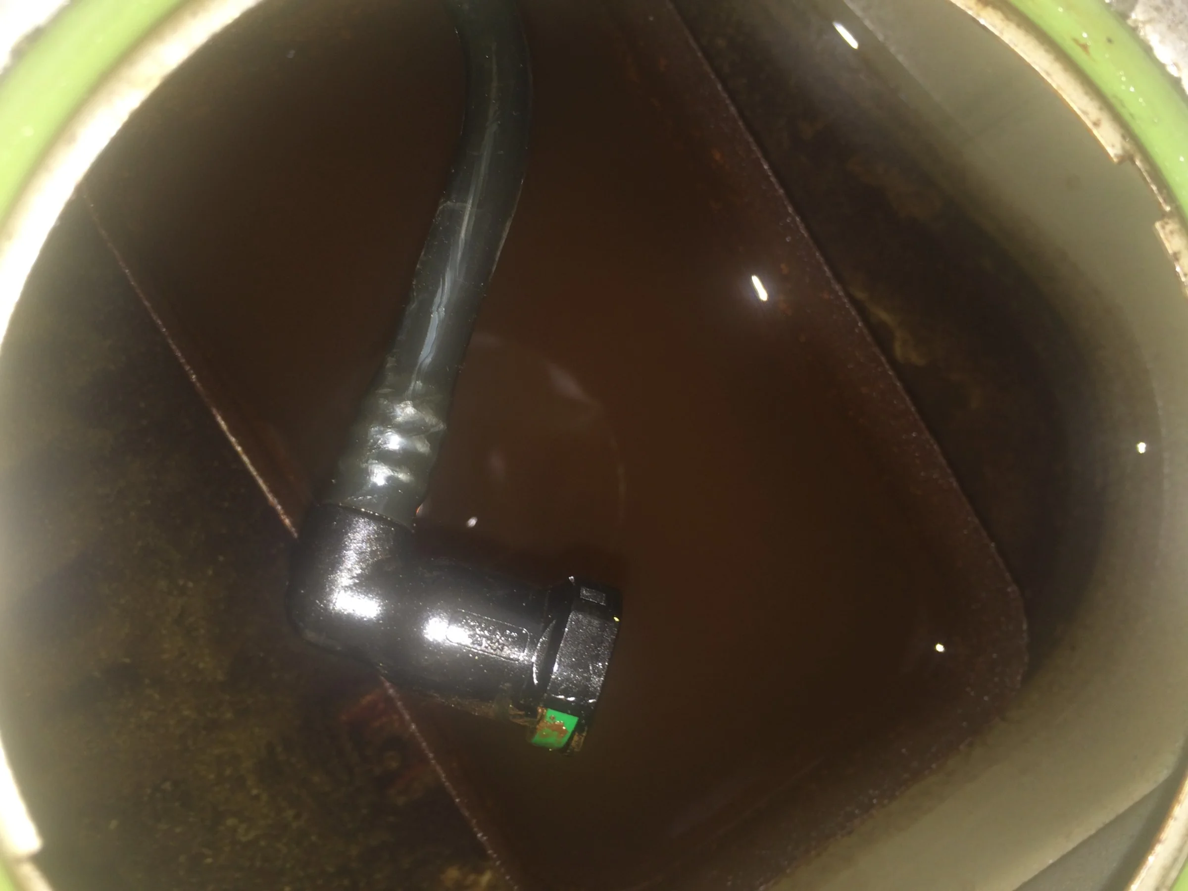

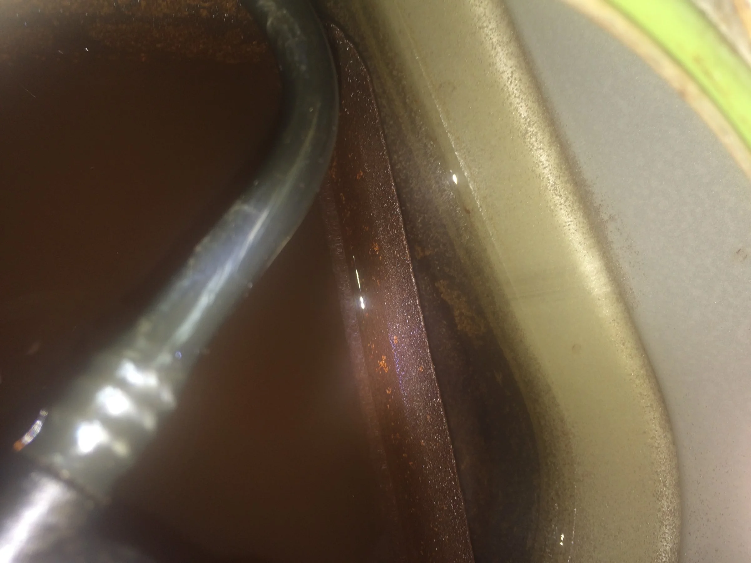

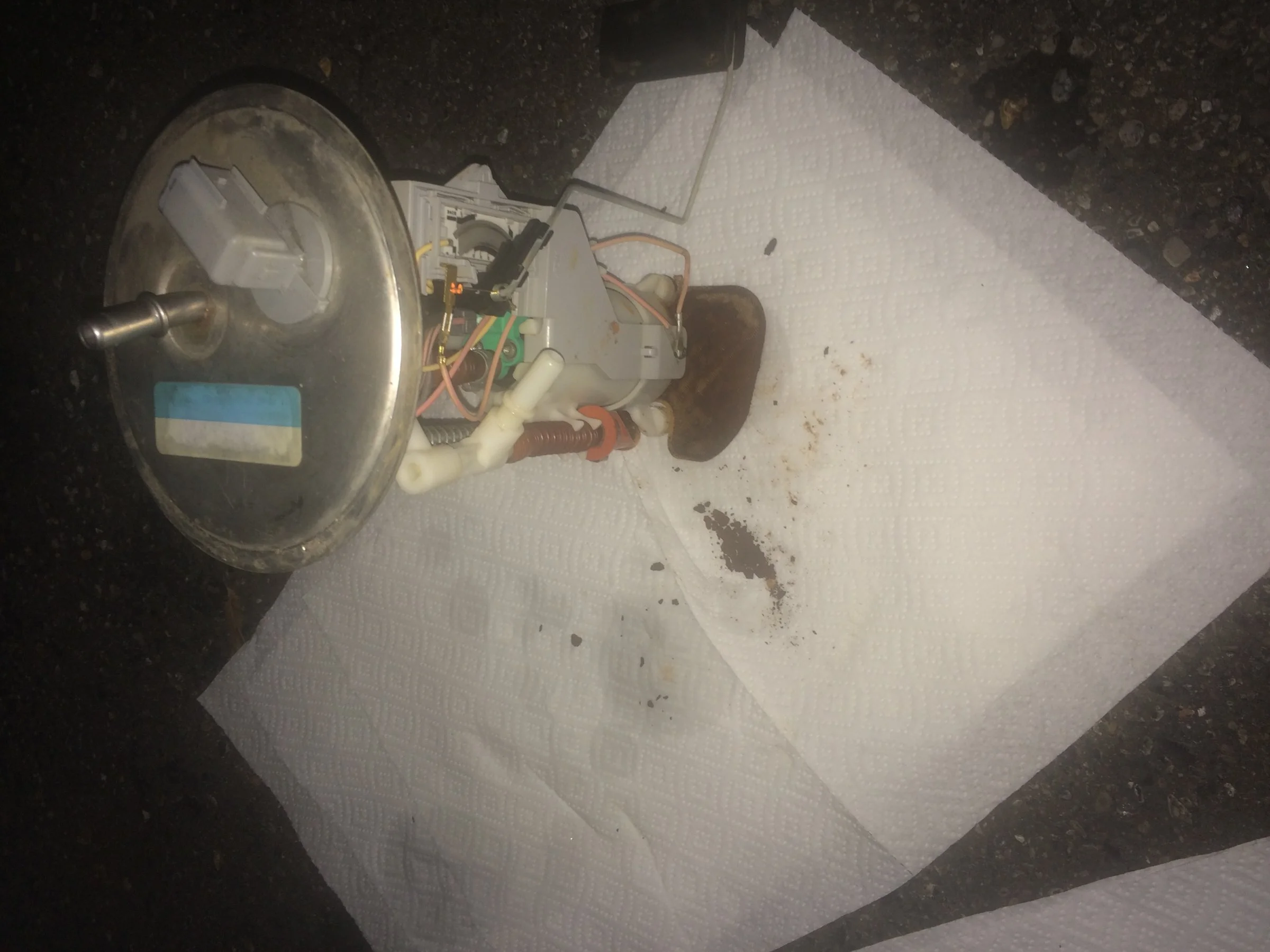

Ok, Took out the fuel pump to check the inside of the tank. the tank is a bit corroded and the filter Mat of the pump was partly clogged by corrosion particles....
Has anyone ever seen something similar?
New tank , new pump or what should I do?

Found similar condition on a customer GrandNational the we opted to replace the tank it was inexpensive enough. I'm not sure what a tank costs to replace for an S197 but they can be sent out to be cleaned hopefully it will solve that concern. BTW I would also change gas stations
