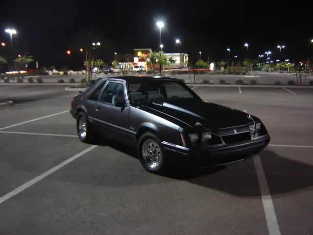

Im 18 currently but i painted my car. It was my first time, i did it in the garage, and everything including paint,sanpaper,paint thinner was only 34 bucks lol. HEre is how it came out
