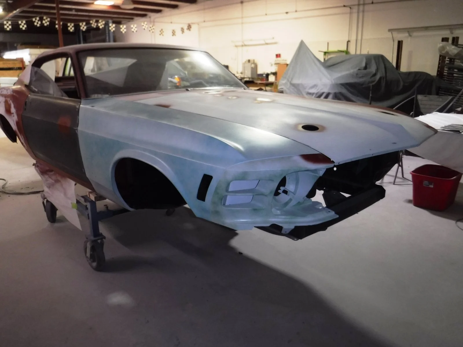

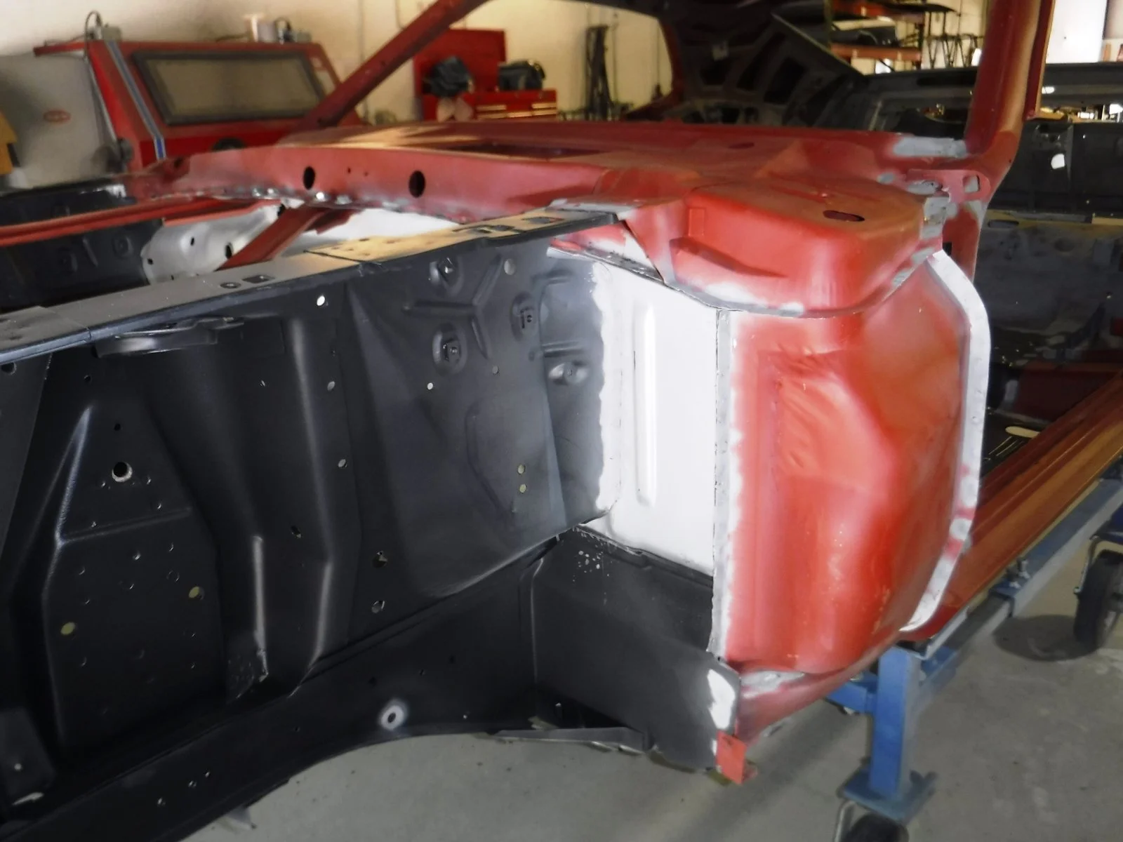

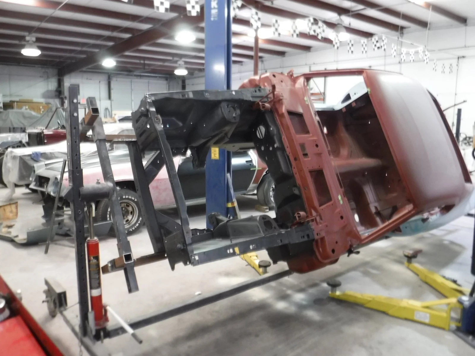

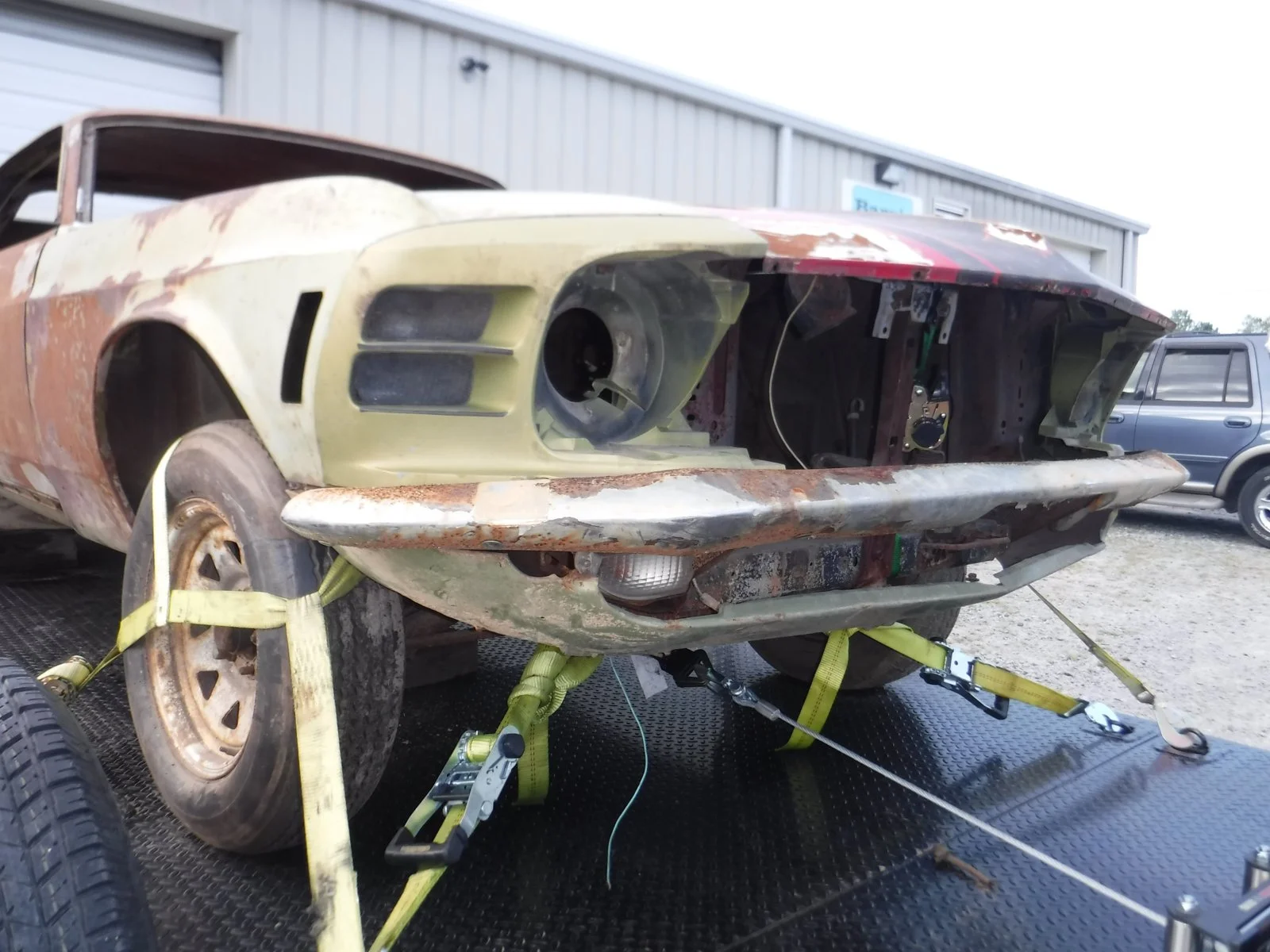

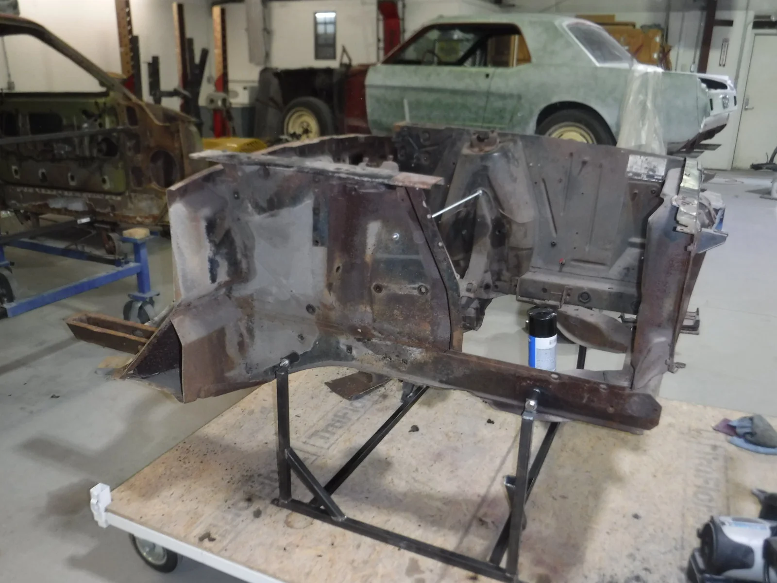

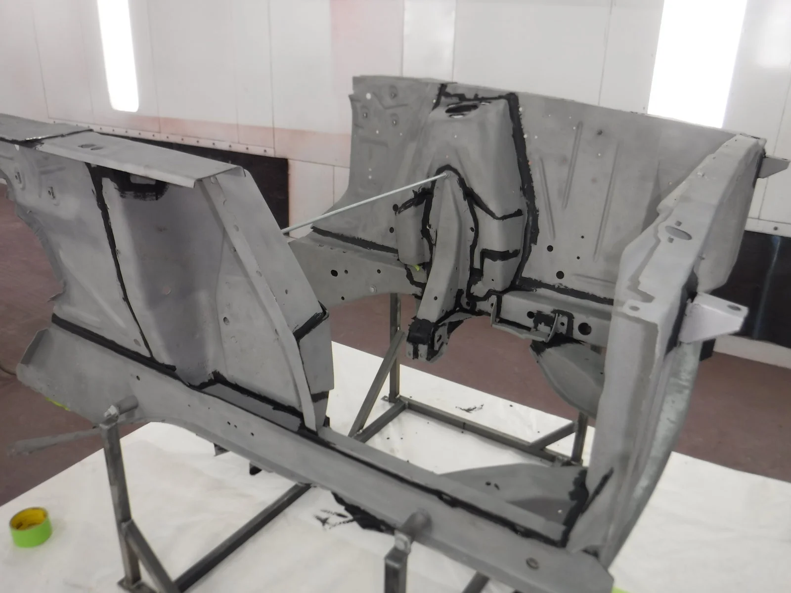

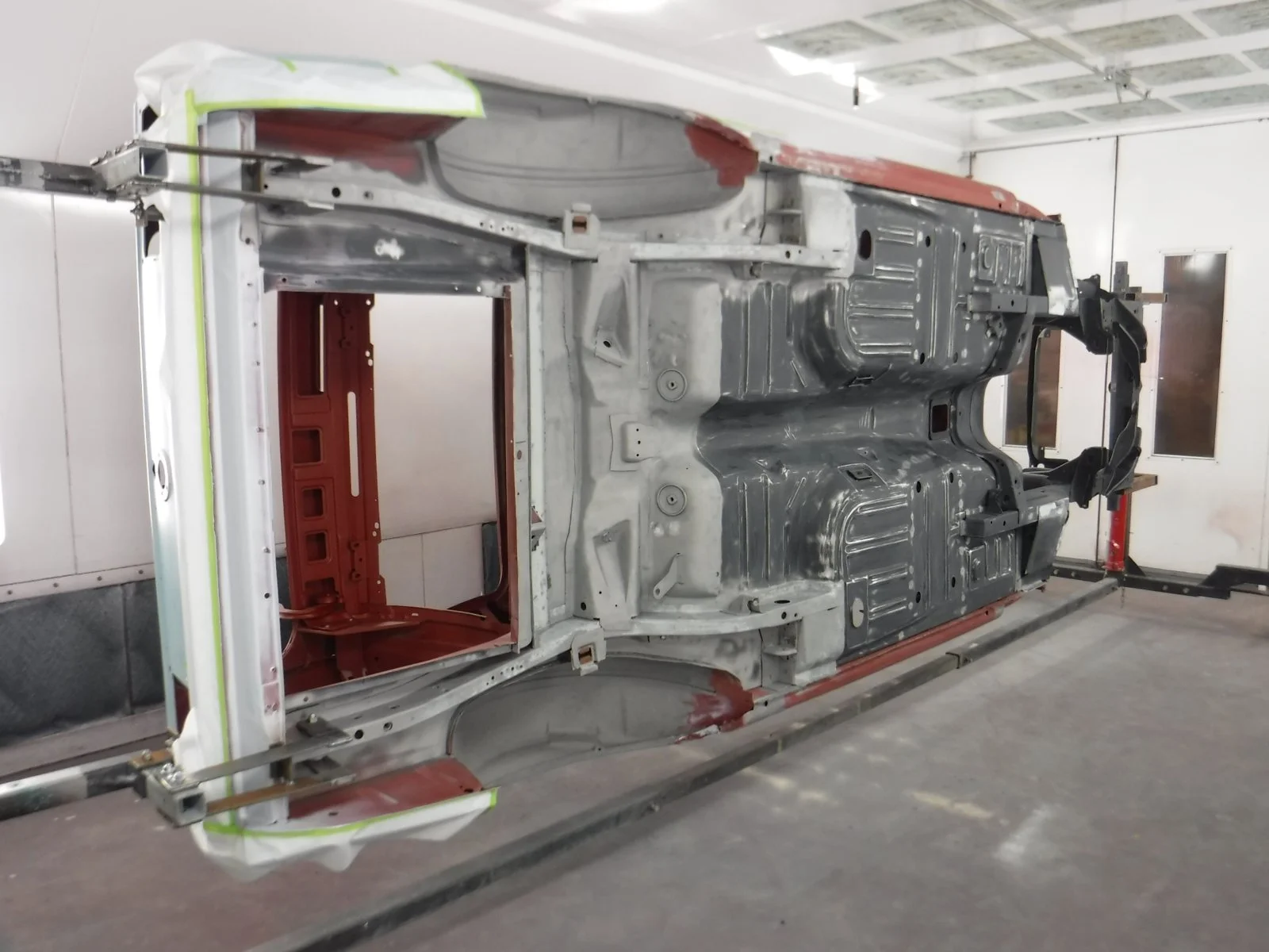

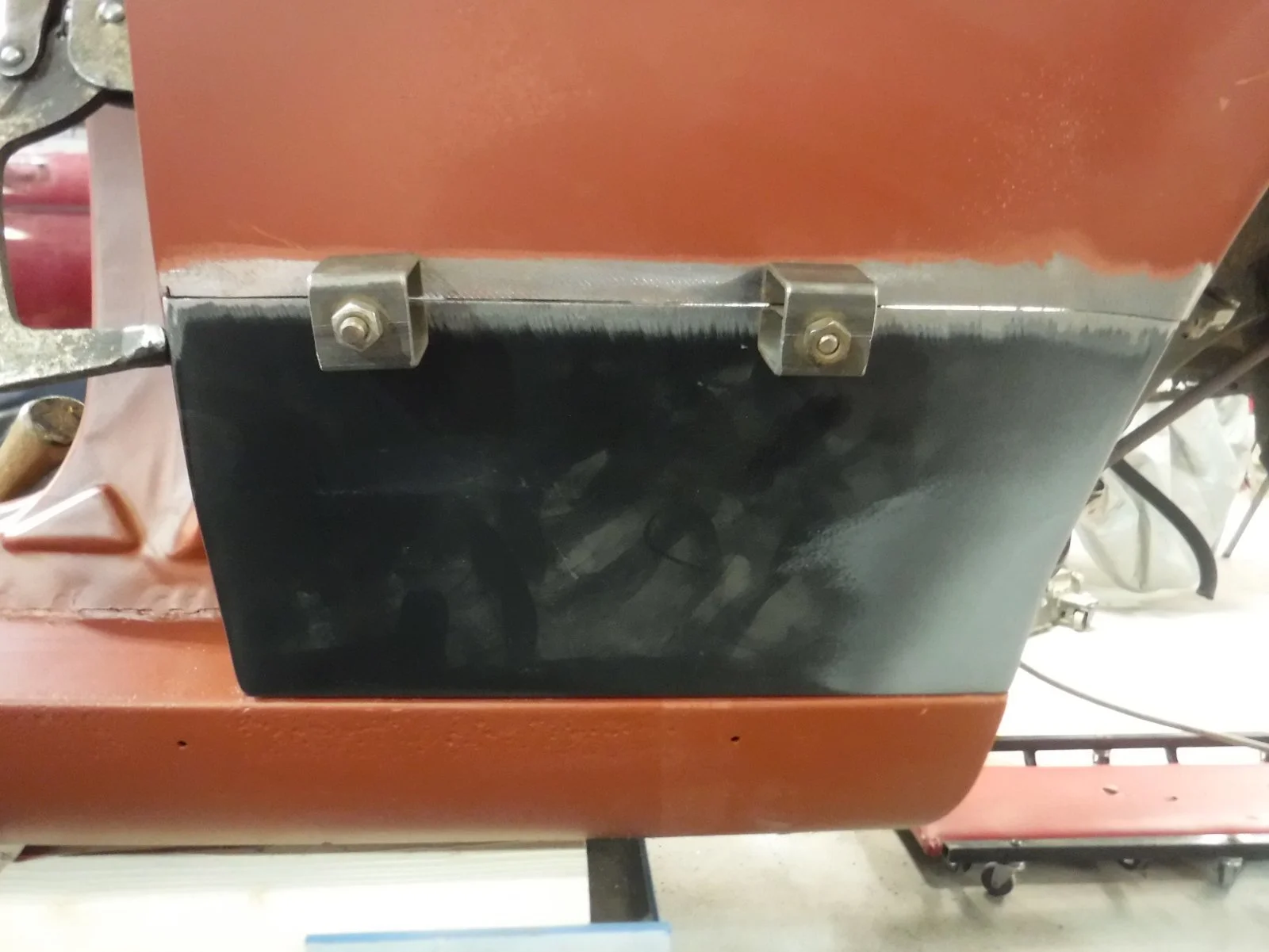

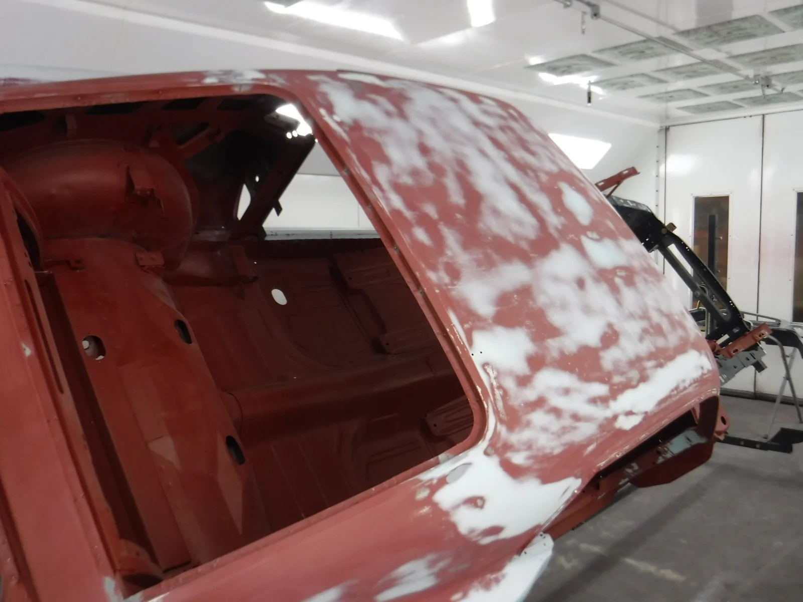

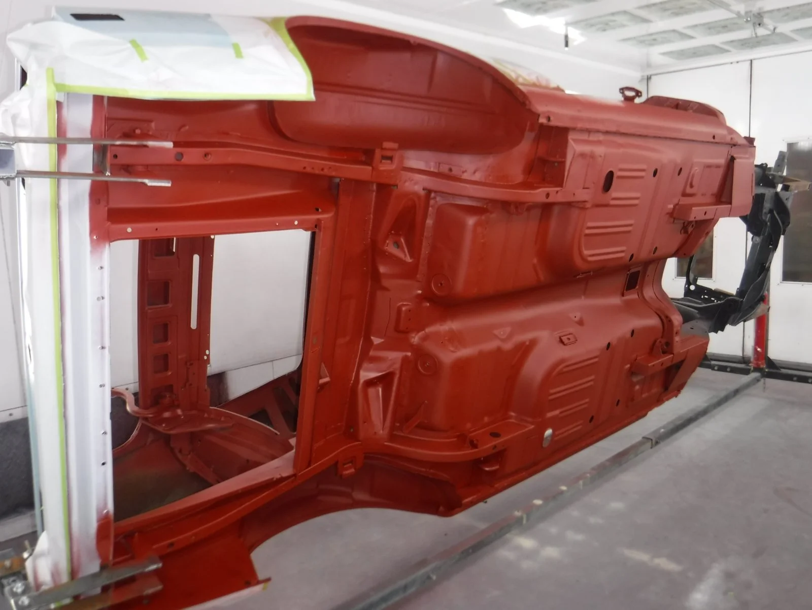

Here are a few pictures. Hundreds of labor hours between these stages.

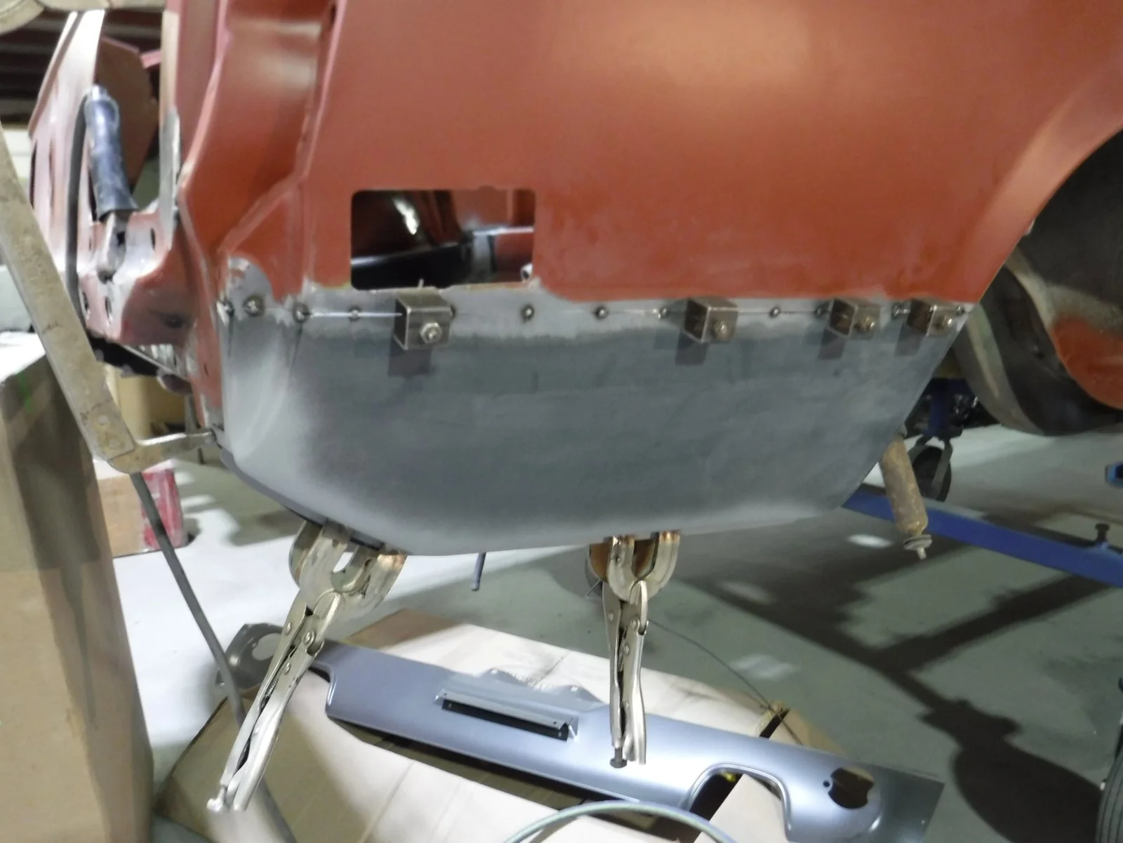

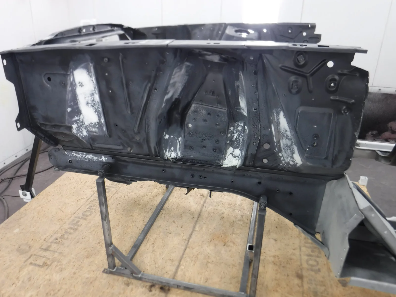

With DP90 epoxy brushed into every crevice, then sprayed with 2 coats and minor pitting smoothed out..
Then time to install.

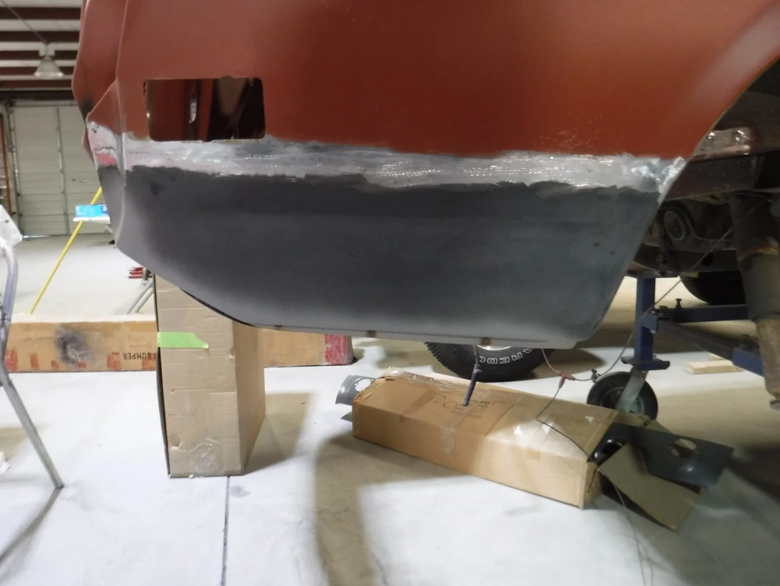

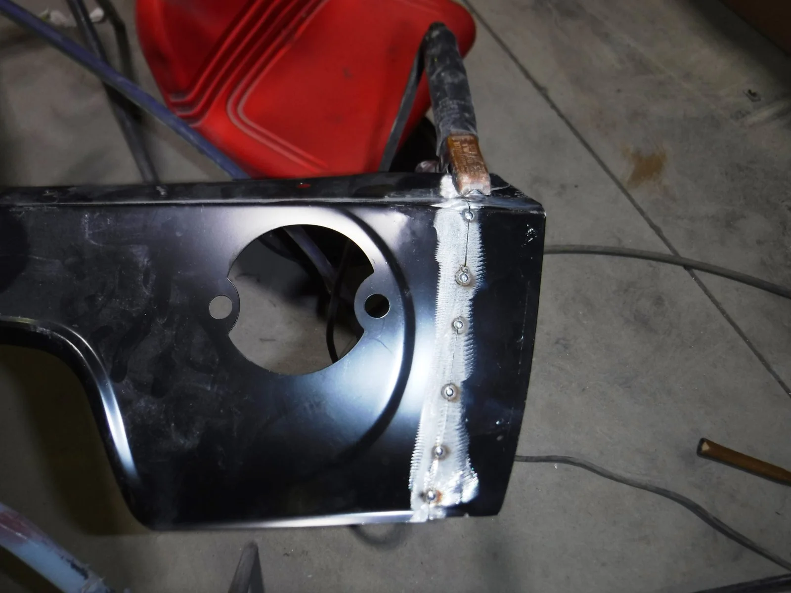

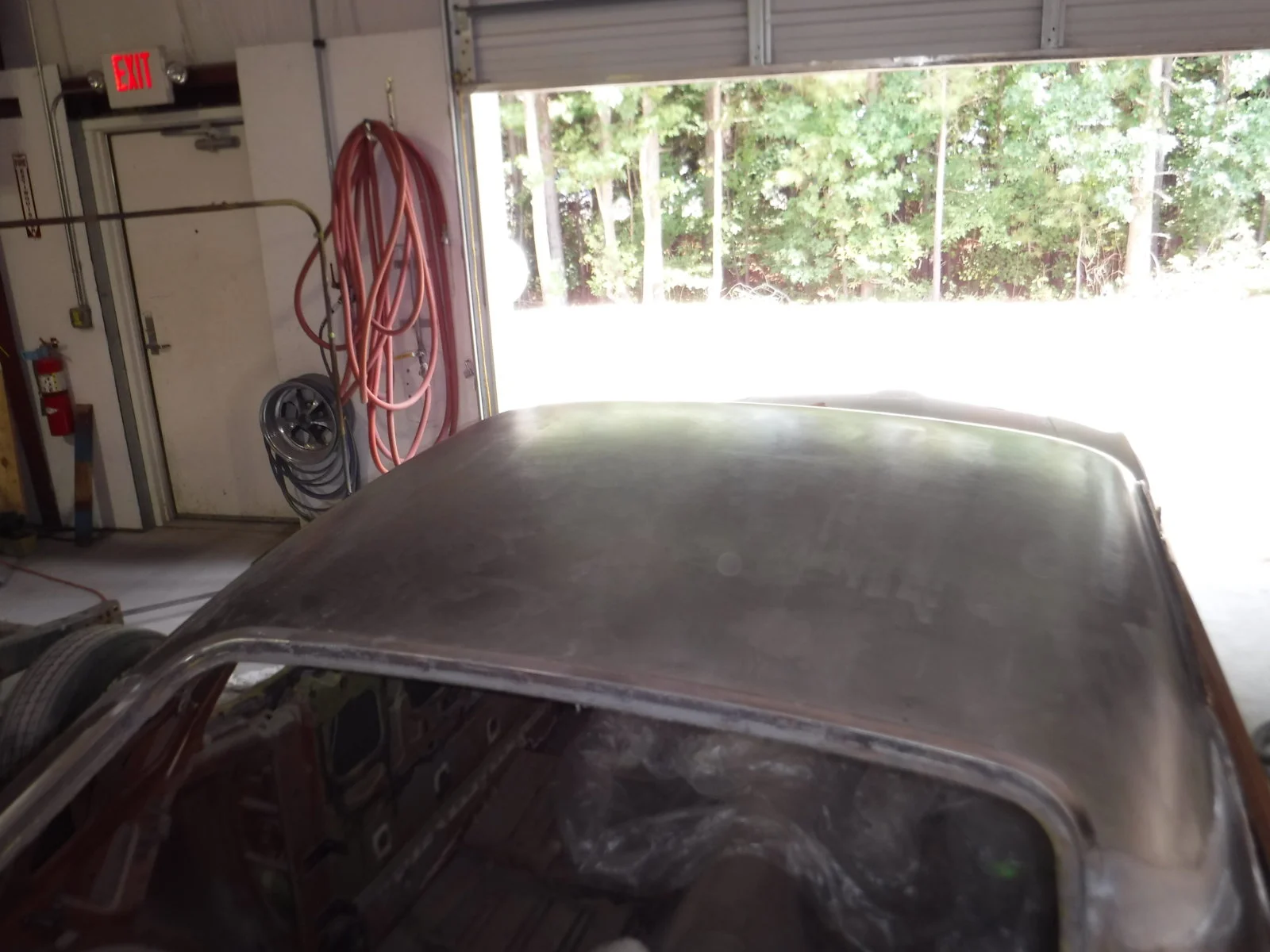

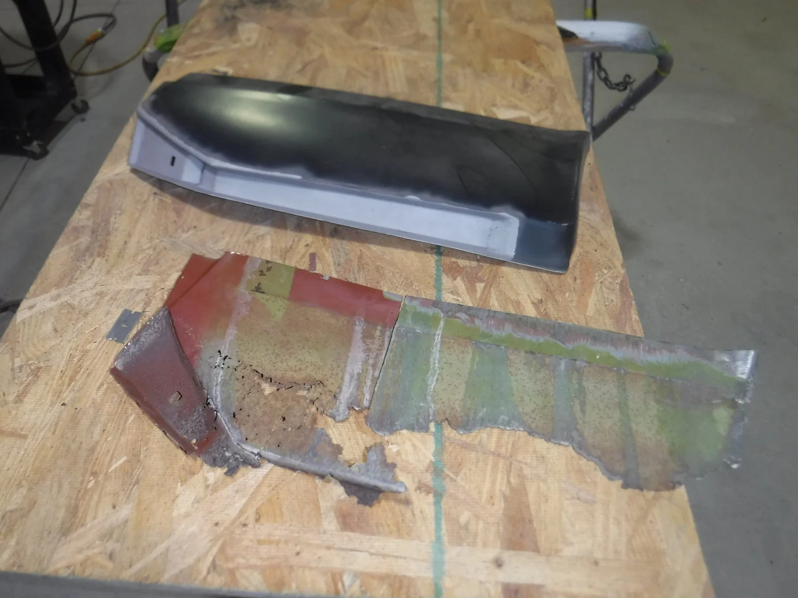

"New" parts after substantial contour modifications. I've never had a Mustang rear valance that was made correctly on the ends....is it just me?

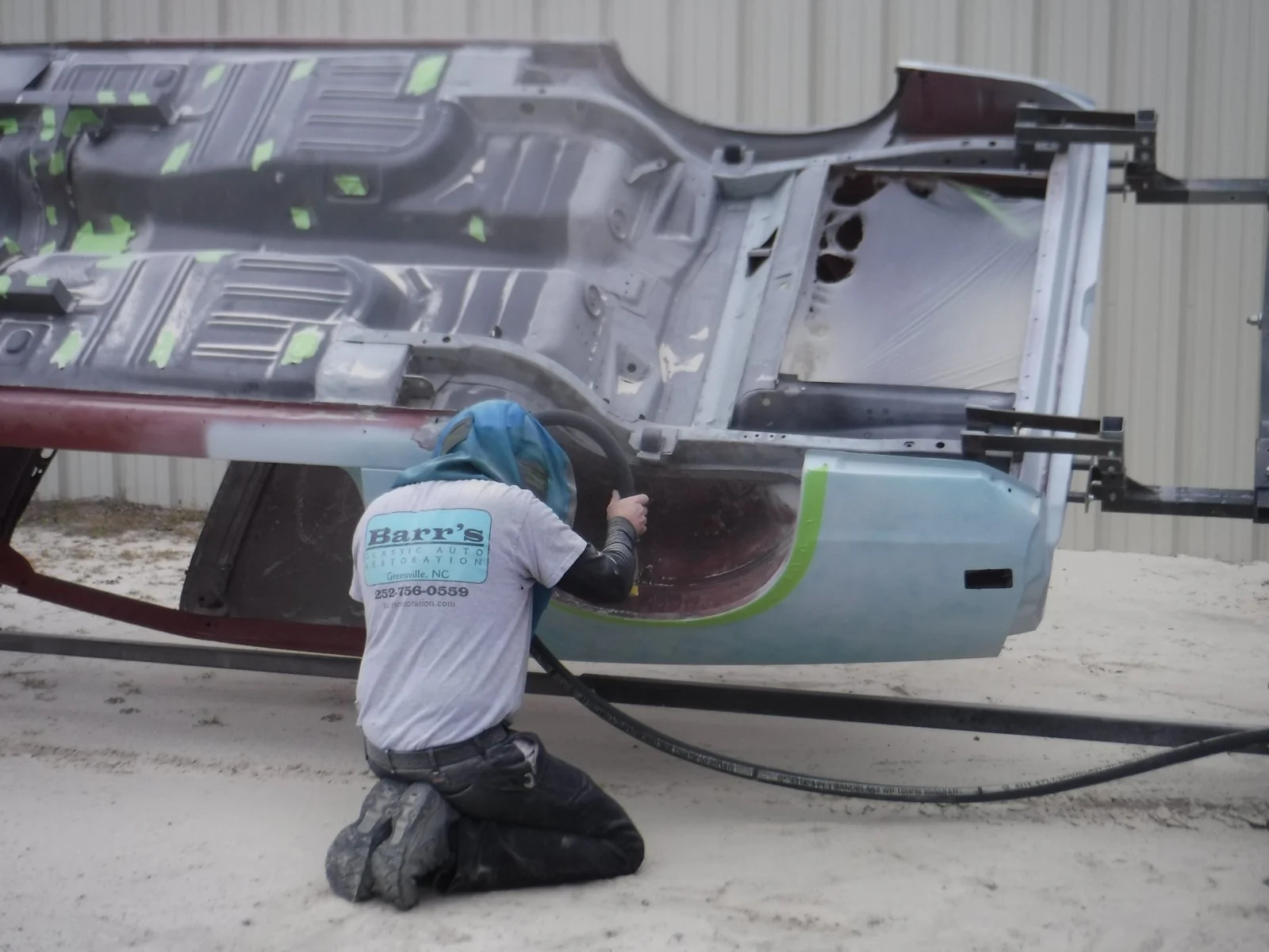

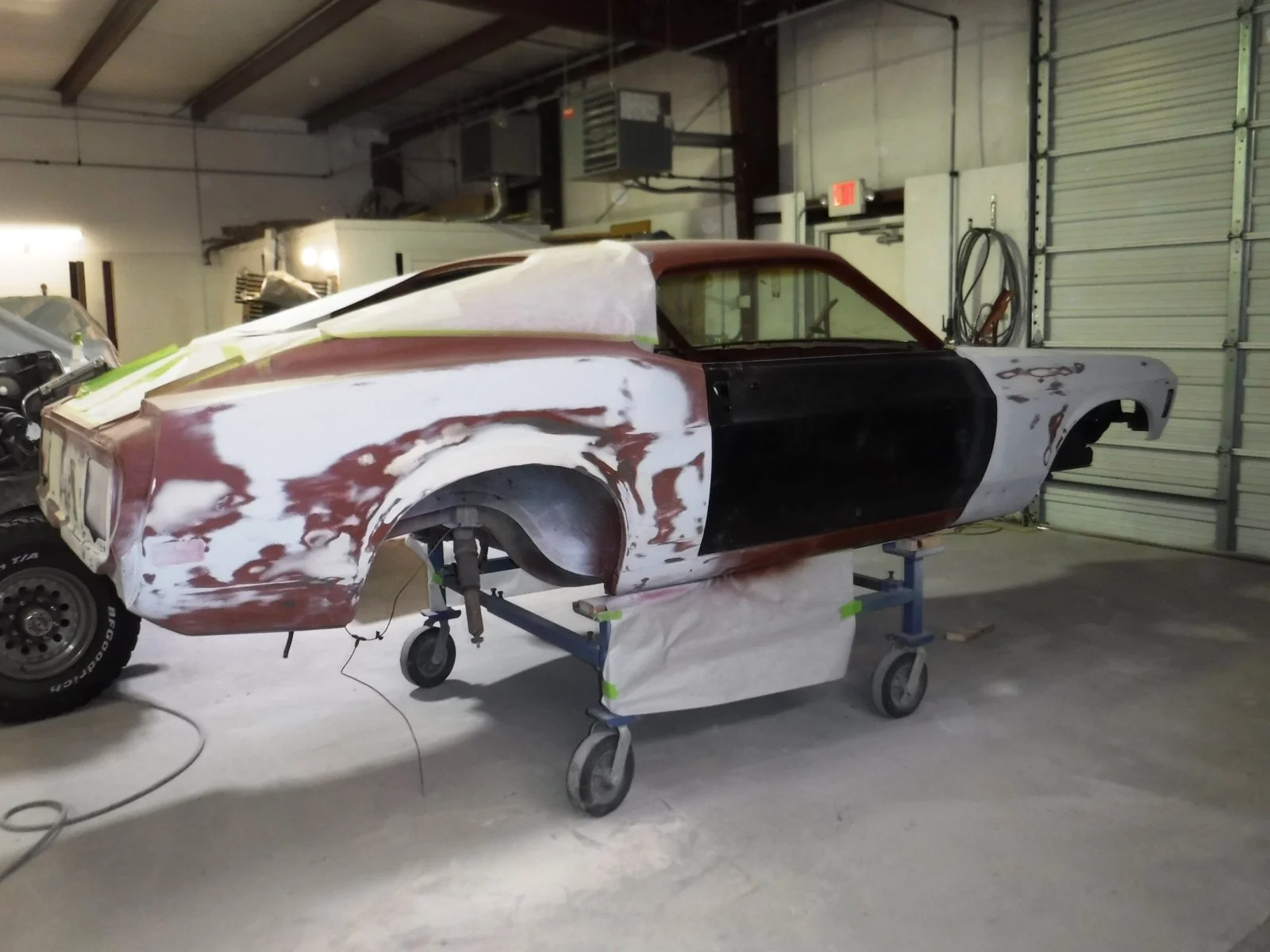

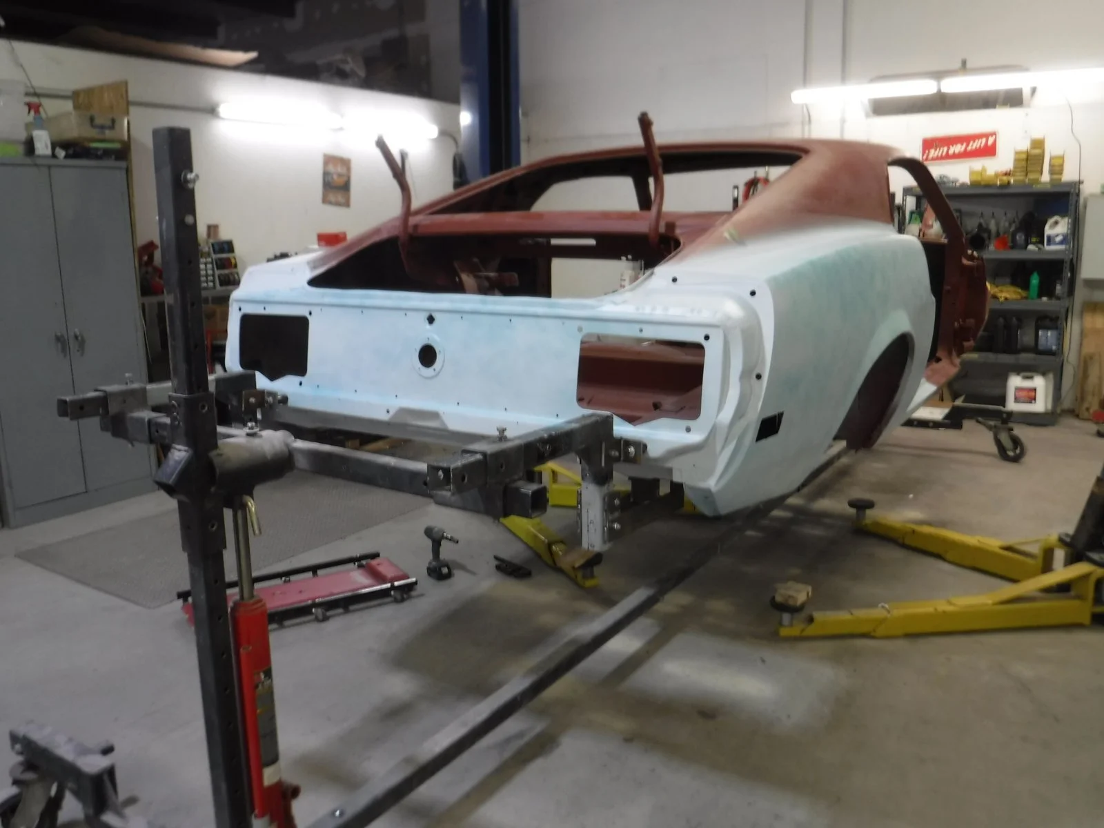

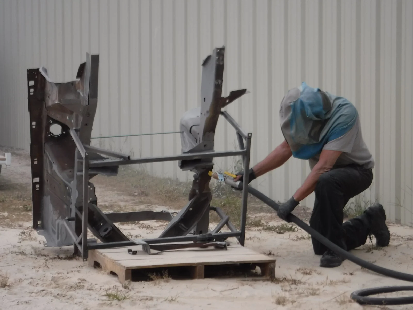

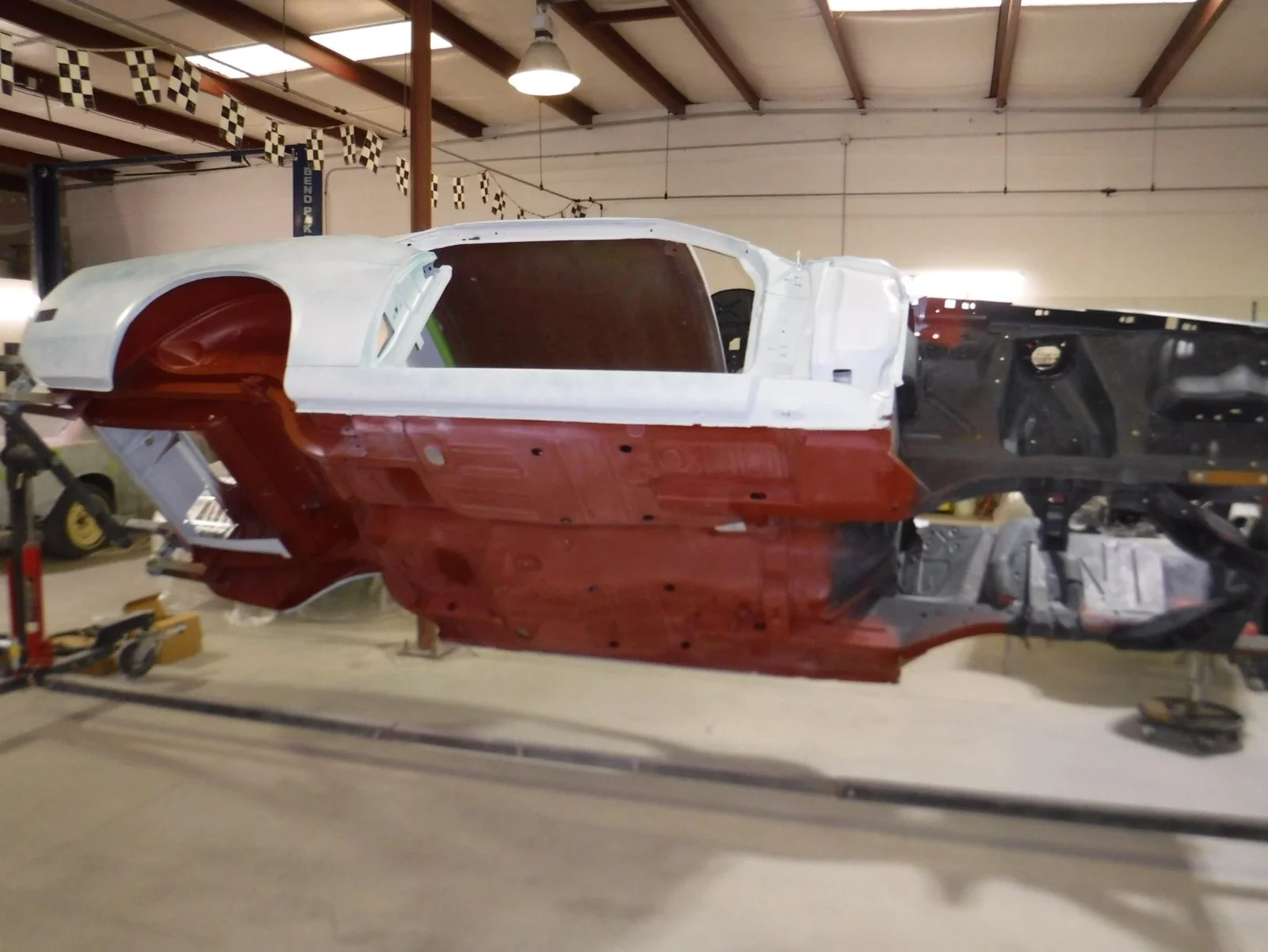

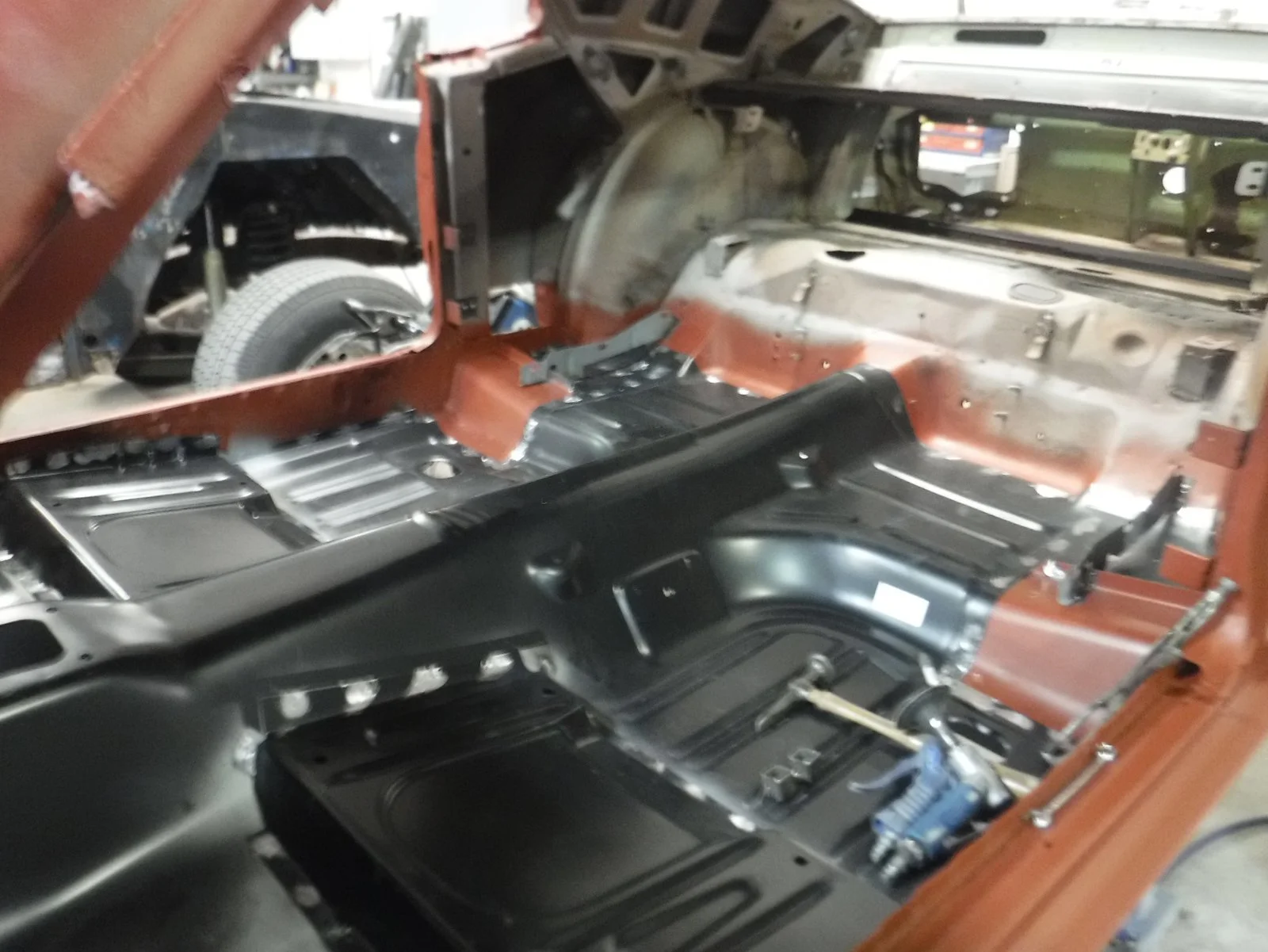

Due to structural integrity (and rotisseries being occupied) it was decided to do the body blasting in two stages. This is the second round.

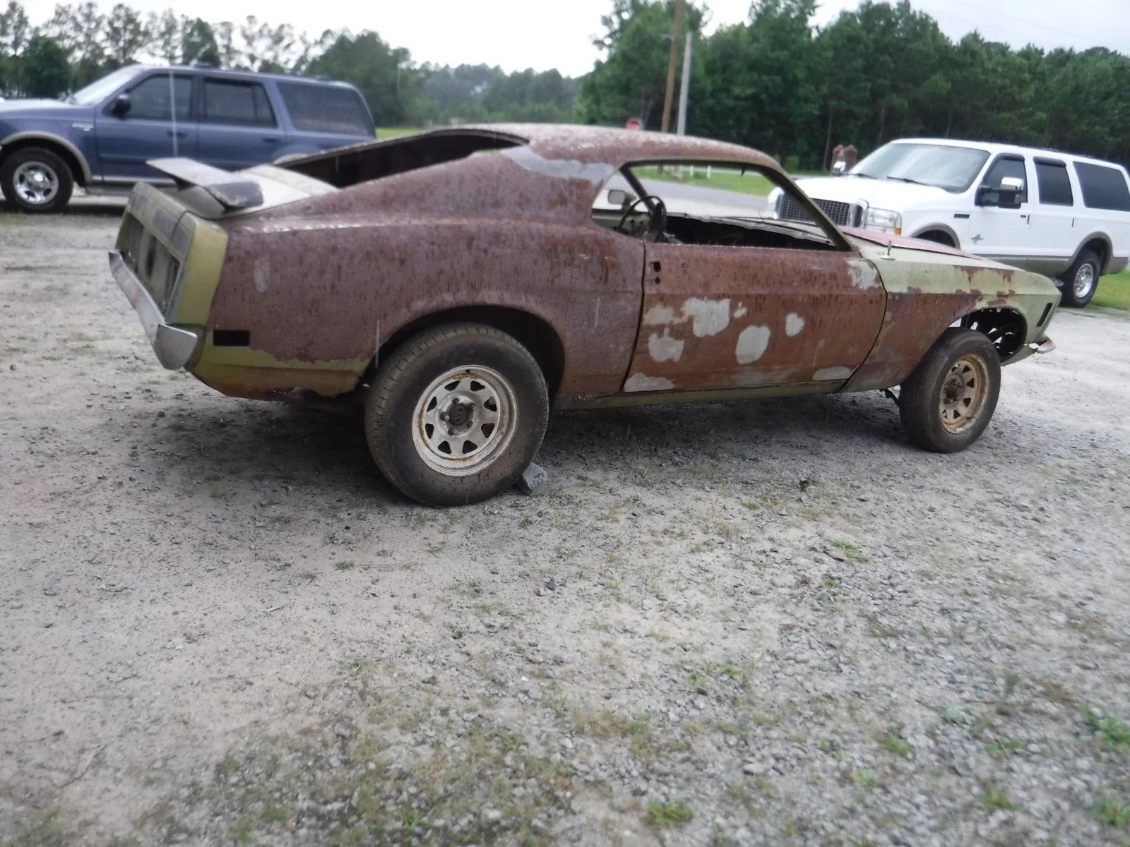

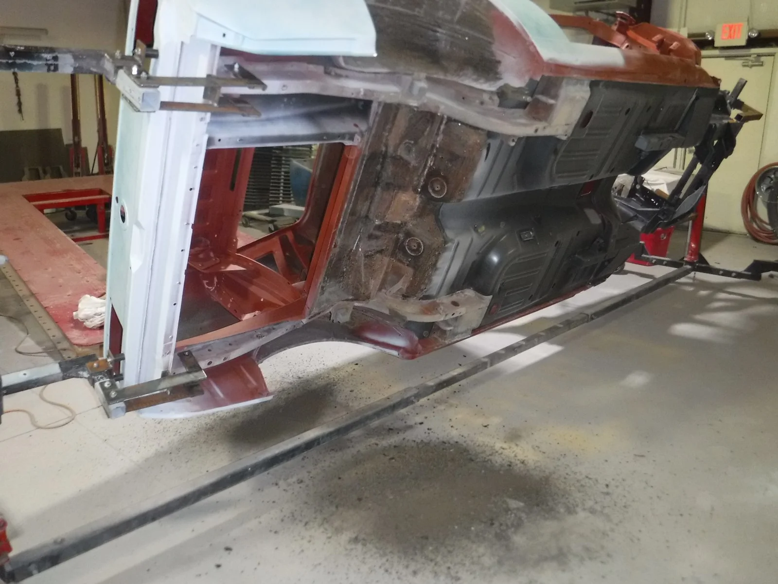

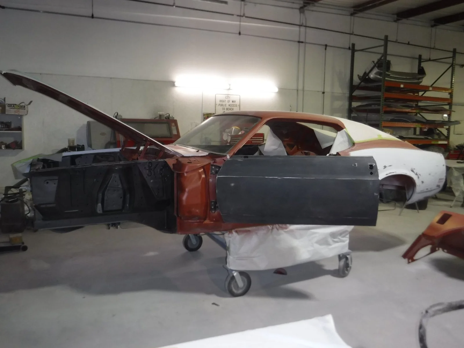

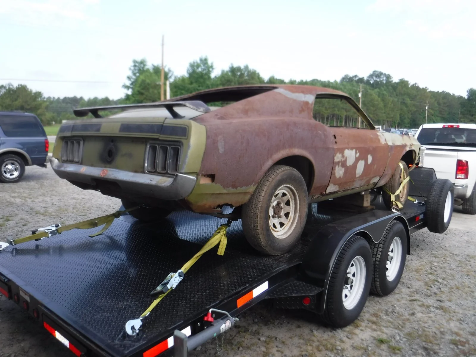

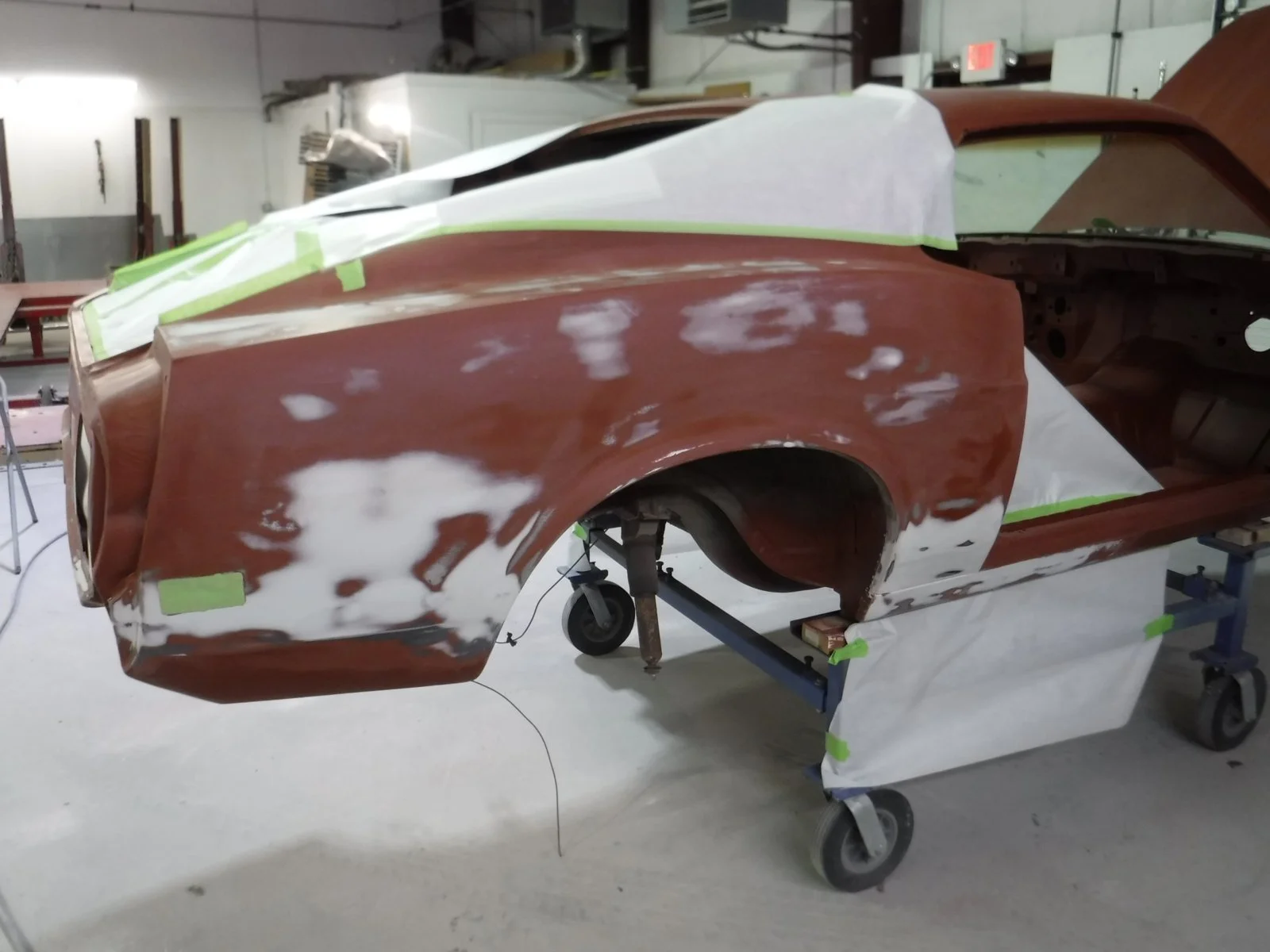

Because this came to us as an original paint car, I photo documented as much as I could before a wrench was turned. That included rear stripe dimensions and placement, rear body panel black -out, etc. If anyone has an interest in those, I can post them as well.
Hopefully this post isn't worthless any more. :D
And I thank those above for the great information. BTW, this car is a Metuchen built car with the Marti report confirming it to be a 428SCJ/Drag Pack/4:30/4 speed car. Code G Lime Metallic with green interior.
