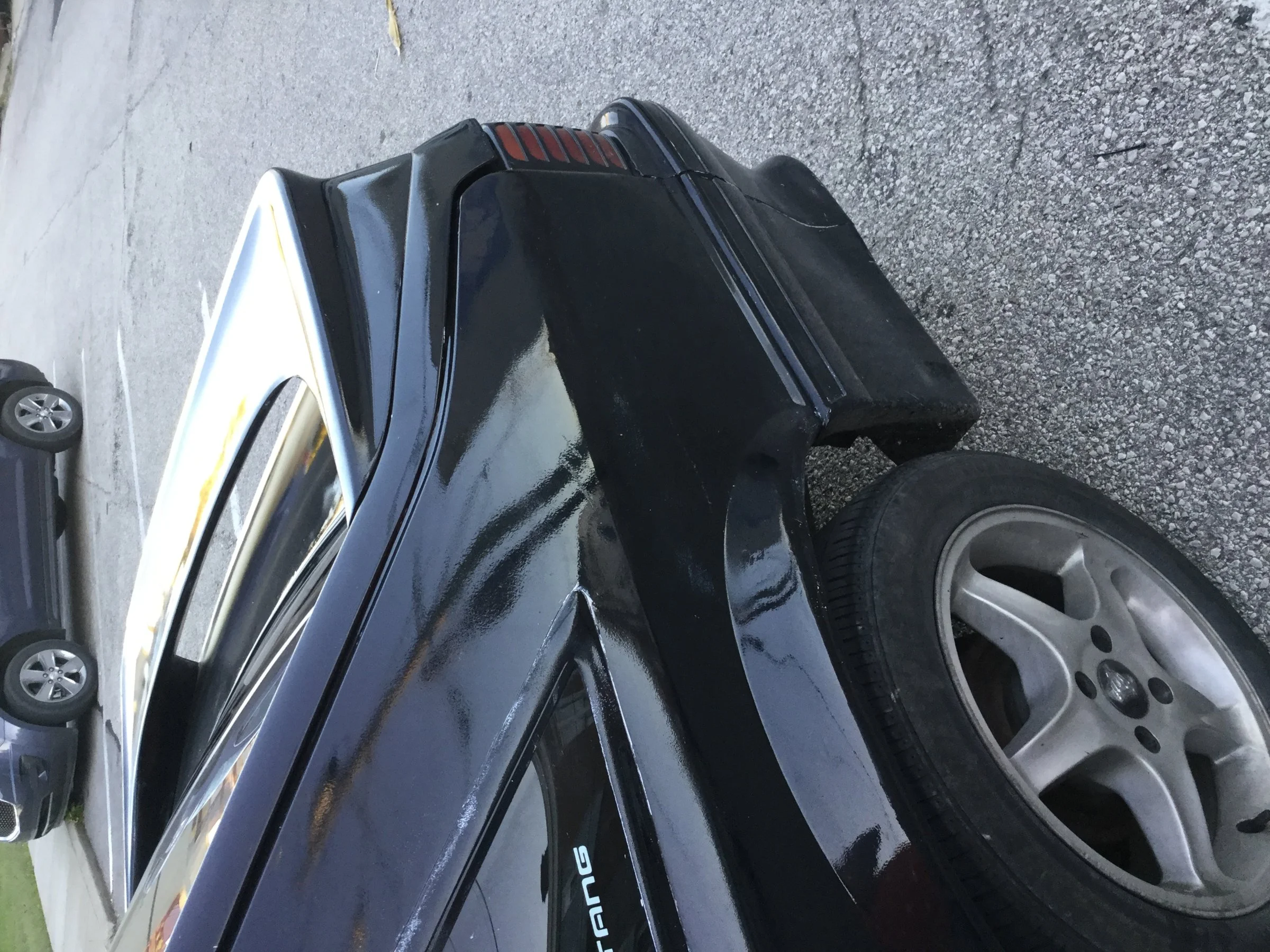

I just traded my Hyundai for an 1989 GT. Title says red, but the previous owner spray painted it black and then clear coated with a gun. You can see swirls from the clear coat. I was wondering if there would led be any way to buff it to make i look presentable until I get the funds to have it professionally painted or should I just sand it down and try to primer myself? Any information would be greatly appreciated. Thanks

Let me see a couple pictures of what you're talking about please.
Here's the door side

So, it's a pretty rough paint job.
You can try color sanding it relatively smooth first and then start buffing that out.
It'll take quite a bit of work to really fix it. How much time do you want to invest into the car?
