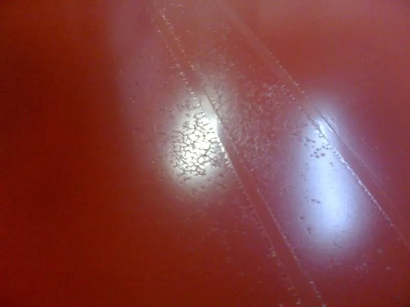

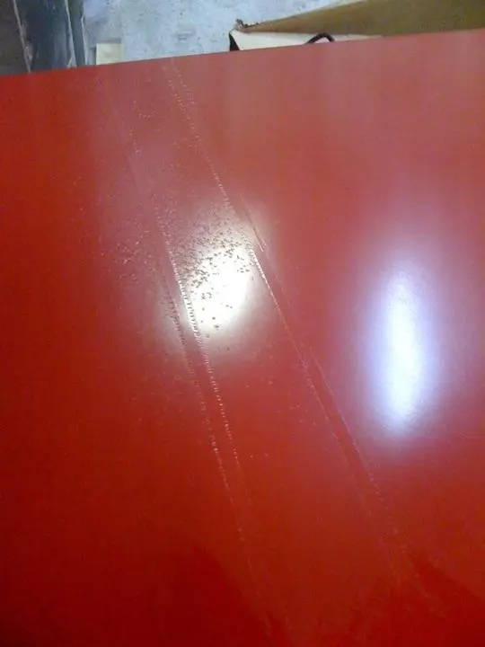

The primer was a polyester heavy fill primer. It was on for about a year before I got to paint. It was sanded before paint though. So that could of been it. As for how we pulled the tape I don't even remember. We had even another few problems. Like the paint and tape seeming to have a reaction. It left a line that even after being sanded with 400 grit smooth you could see. So it wasn't a lip but rather what seemed like a reaction. I took pictures but am at my station and can't put them up till I get off.

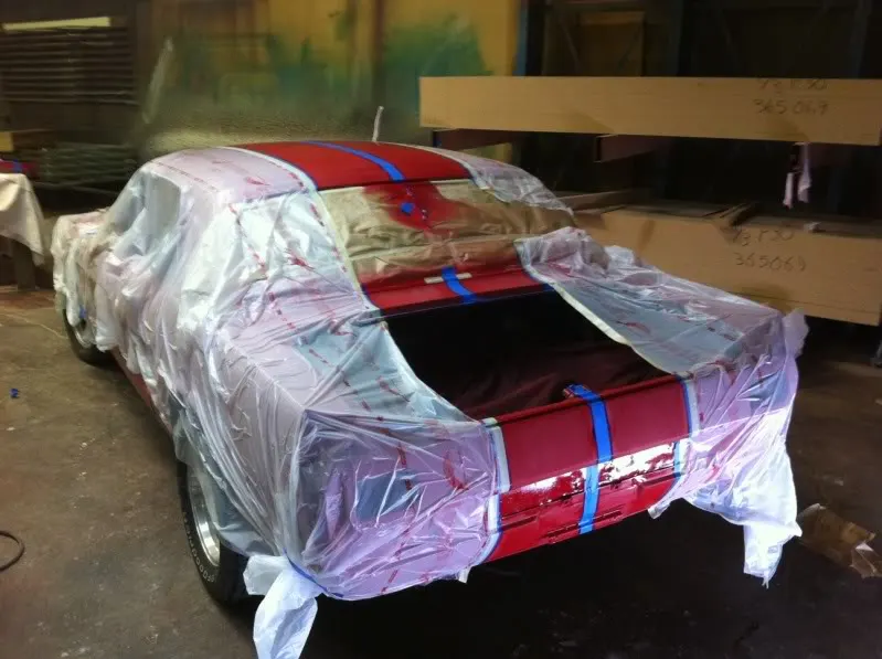

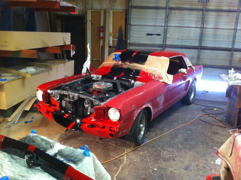

Ok all I got the internet at my house and i figured i would update you all on the progress and the issues that i was having before. Let me know what you think and hope you all enjoy. The pictures look a little more orange than it is in real life. Its definatly a red.
I didn't see this post until now, but can tell the base is way to heavy. you have to remember the base is only to get the color down. I paint where my stripes go lightly,just to get color,mask them off, paint the rest of car lightly just to get enough color, pull off tape & clear everything. then wet sand & buff.
