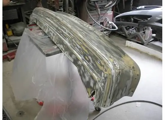

here is pic of the rear bumper getting stripped.. when I was done it was pretty much bare.

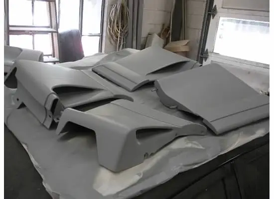

ground effects primed ( for some reason I don't have a pic of them stripped)

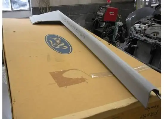

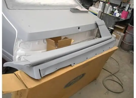

scuffing with 220 ..
It can be done w/o stripper, it's time consuming but I didn't mind. The prep is going to give the final result, get rid of the old paint.
