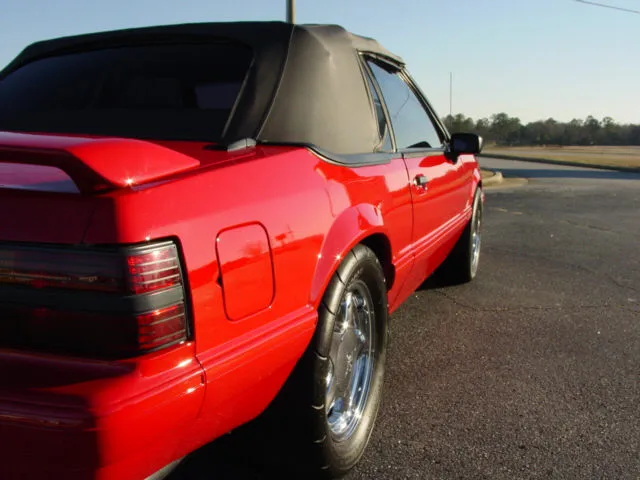

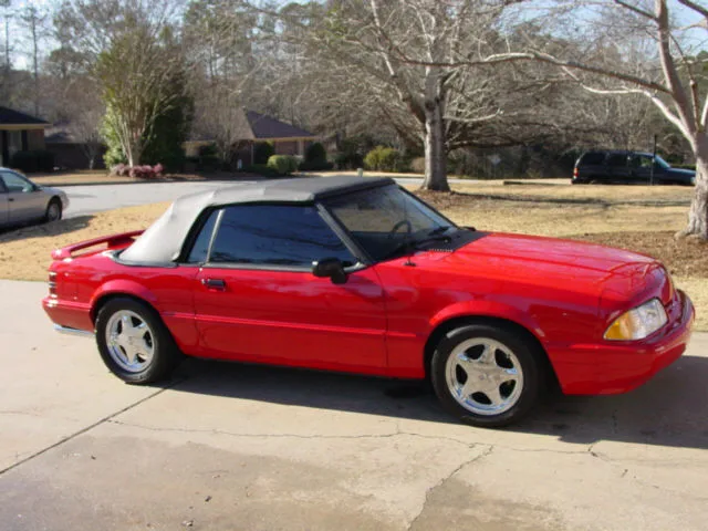

I did the same as executioner, on the local Vo-tech school. Wanted my 86 painted So I signed up for classes just t paint it now in my last 1/4 and will have a diploma in Auto Body & Paint. Didn't mean for all this, but figured heck, I started, might as well finish it...:rolleyes: You can see my 86 I painted in my sig on page 2. And the pics below is a 93 vert I painted for a guy about a 1.5 years ago while attending class..
