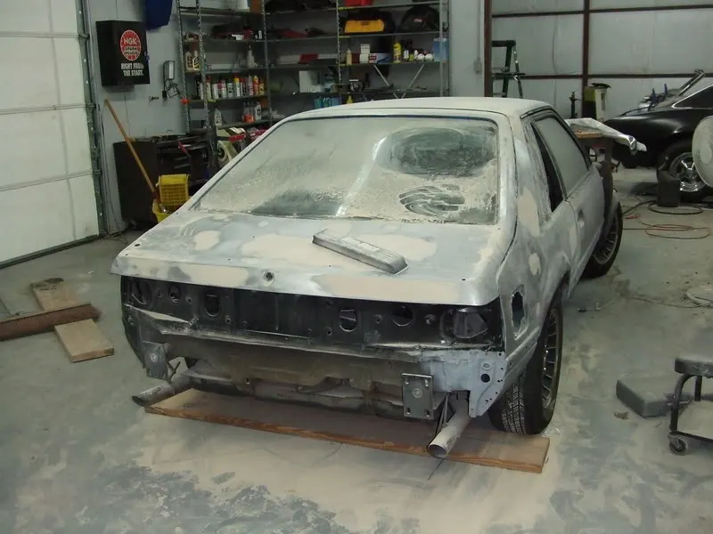

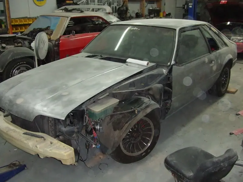

i take almost all the cars i work on to bare metal. here's how my car's been for about a month
