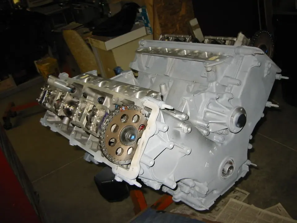

painting a 4.6
Are you sure you haven't seen one painted?;)
They look really good painted. I suggest you put on a couple of coats of clear coat which makes it easier to clean.
If you think you are sure that you haven't seen one painted, check out that PM I sent you awhile ago on my engine. It is painted.:D

oh yeah i forgot:doh:, i accually saved that in my pictures :D
here you go

yeah i know the feeling..... i was thinking about sandblasting the front cover, then painting it with self etching primer, i think that will hold the paint good
I think a Ford blue engine with black "tins" would looks great (even if the tins on our cars are composite)
back in the dawn of time (70s and 80's) I had pretty good luck just cleaning the heck out of the engine and painting it with regular, old engine paint...but it was probably more toxic back then and worked better...
I went over the top on 2 different occaisions back in the 80's when I was doing car shows. In one case I had the block hot tanked, primed it and painted it a basecoat white pearl. I then used masking tape for pinstripes and fogged on a light orange candy. The I peeled the tape off and shot the whole thing a yellow candy and urethane cleared it. It held up real well. In the other, more radical one, I ground all of the casting off of the block and heads, polished the whole ireon block, primed it, used a silver base coat with lots of flake and shot candy apple red over the base. I cleared it as well.
