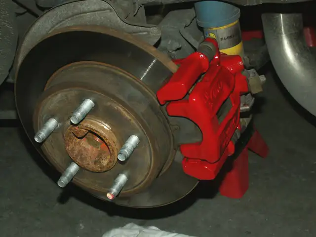

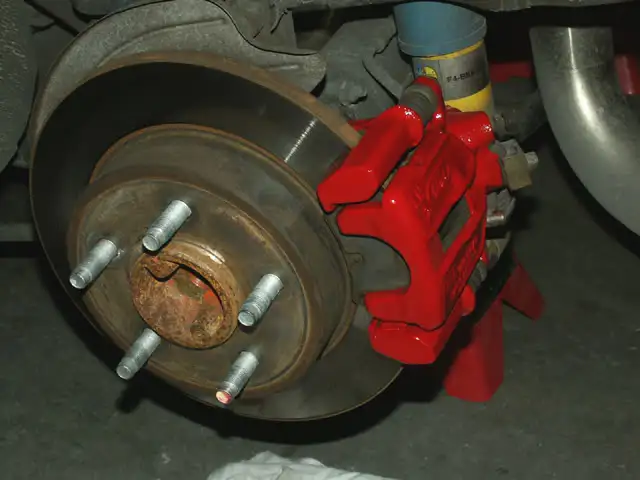

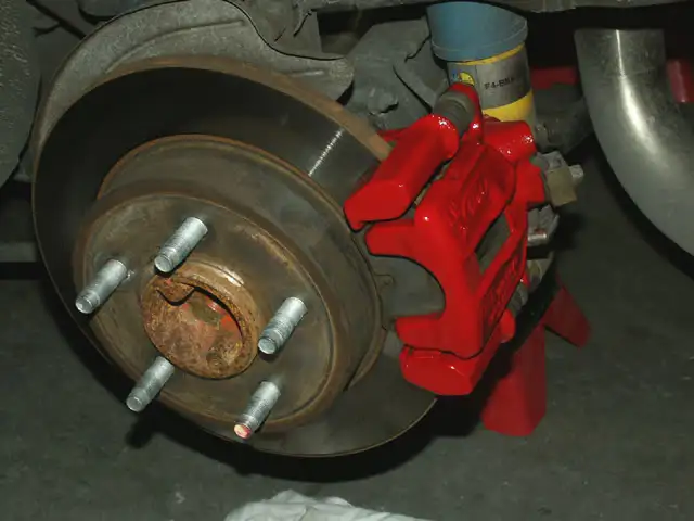

Get some Dupli-Color Caliper paint at Autozone or any auto parts store and brush it on. I didn't have to mask anything.
I bought caliper spray paint from discount auto. Taped everything off and had no problem. Just take your time with tape. I used red on my silver GT and I think it looks awsome.
Somebody on this site saw a picture of them and said it was a bad idea because the paint can trap in heat and make the brakes hotter. But I think that is BS
Btw, on that Dupli-Color Caliper paint kit I bought. (Shown above) It was brush on and it included the brush, and caliper cleaner. One kit is more than enough for one car maybe even two.
They came out reeeaaaalllll nice...:nice:
I might do another coat and then hit it with some clear to give it a nice shine.
Didnt even use half the can, and I put about 3-4 coats on each caliper.
