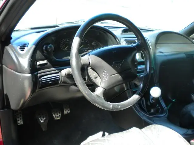

i didn't paint the wheel,found it at the JY,only painted the airbag.didn't use the vinal prep,dash still looks great.

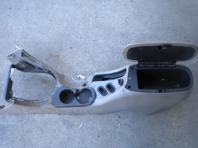

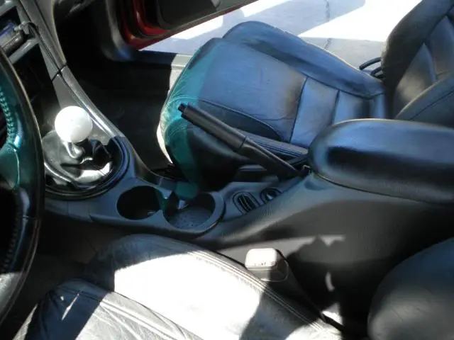

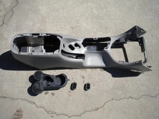

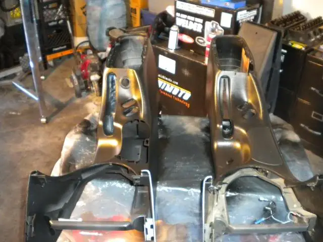

i picked up a center console from a 98.
grey with a cup holder in place of the ash tray.

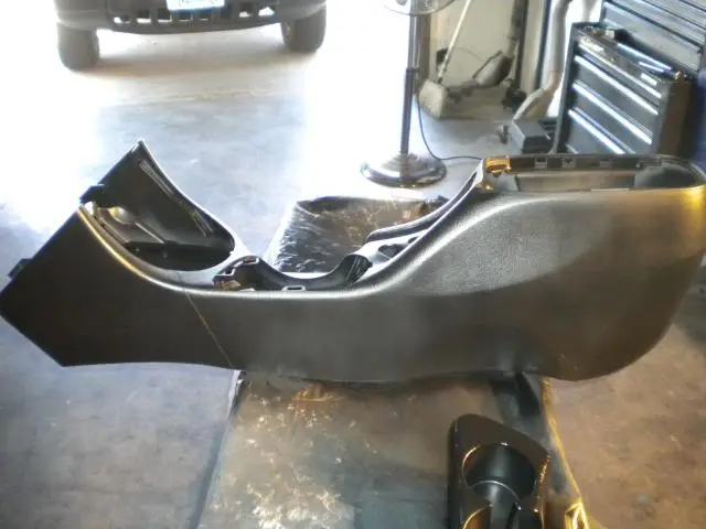

dirty!
disassembled and cleaned it up.

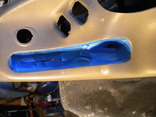

taped off the rubber trim
wiped down with a clean cloth and brake cleaner,than painted with the SEM Landau Black,both the console and cup holder.
heres the two side by side.

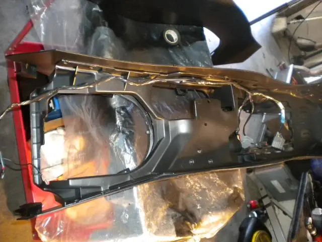

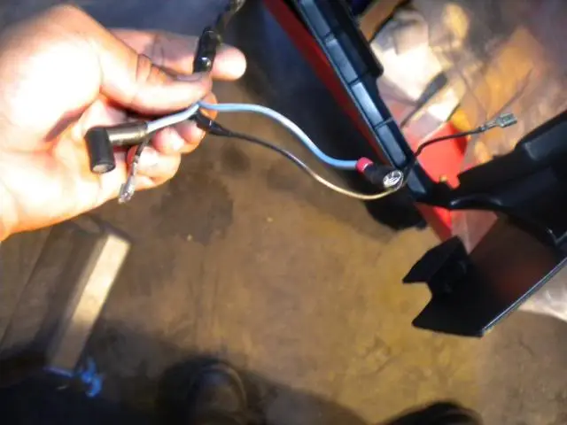

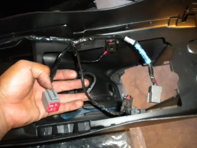

i used the harness that came with the console.
i have a hidden power point under the shifter boot for my sat radio,so i modified the the connection alittle.
also wired my foglights to operate independently of the headlights.

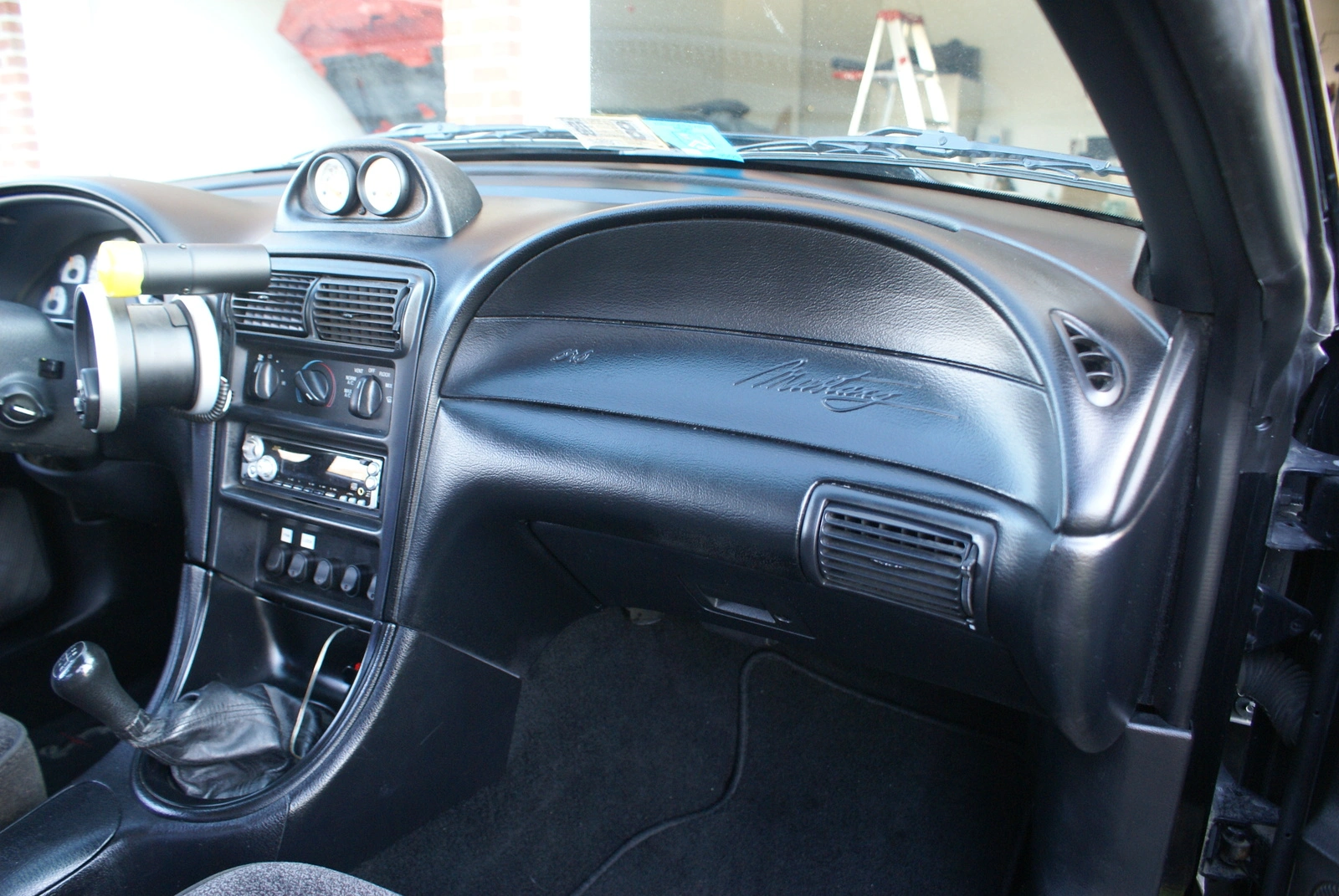

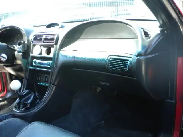

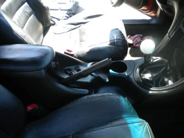

heres before,
heres after,i reused my old lid,as the one that came with the console was broken.

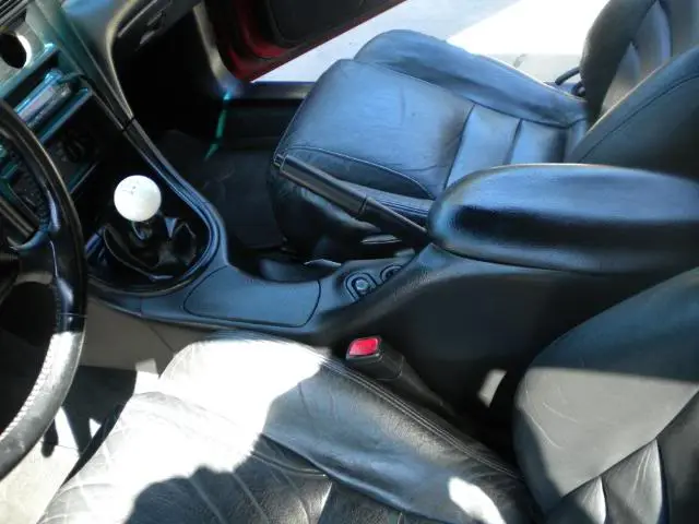

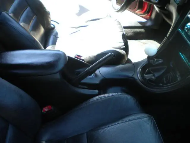

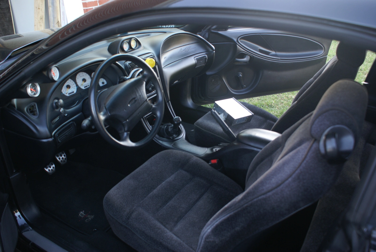

I did mine also, Converted the 2 tone to solid black. I bought an entire interior from a wrecked V6 car, I have the black dash too but the paint came out so well I just never installed it. I hve the black door pulls to install also and at some point upgraded seats. The donor interior was like new including carpet and door panels.
