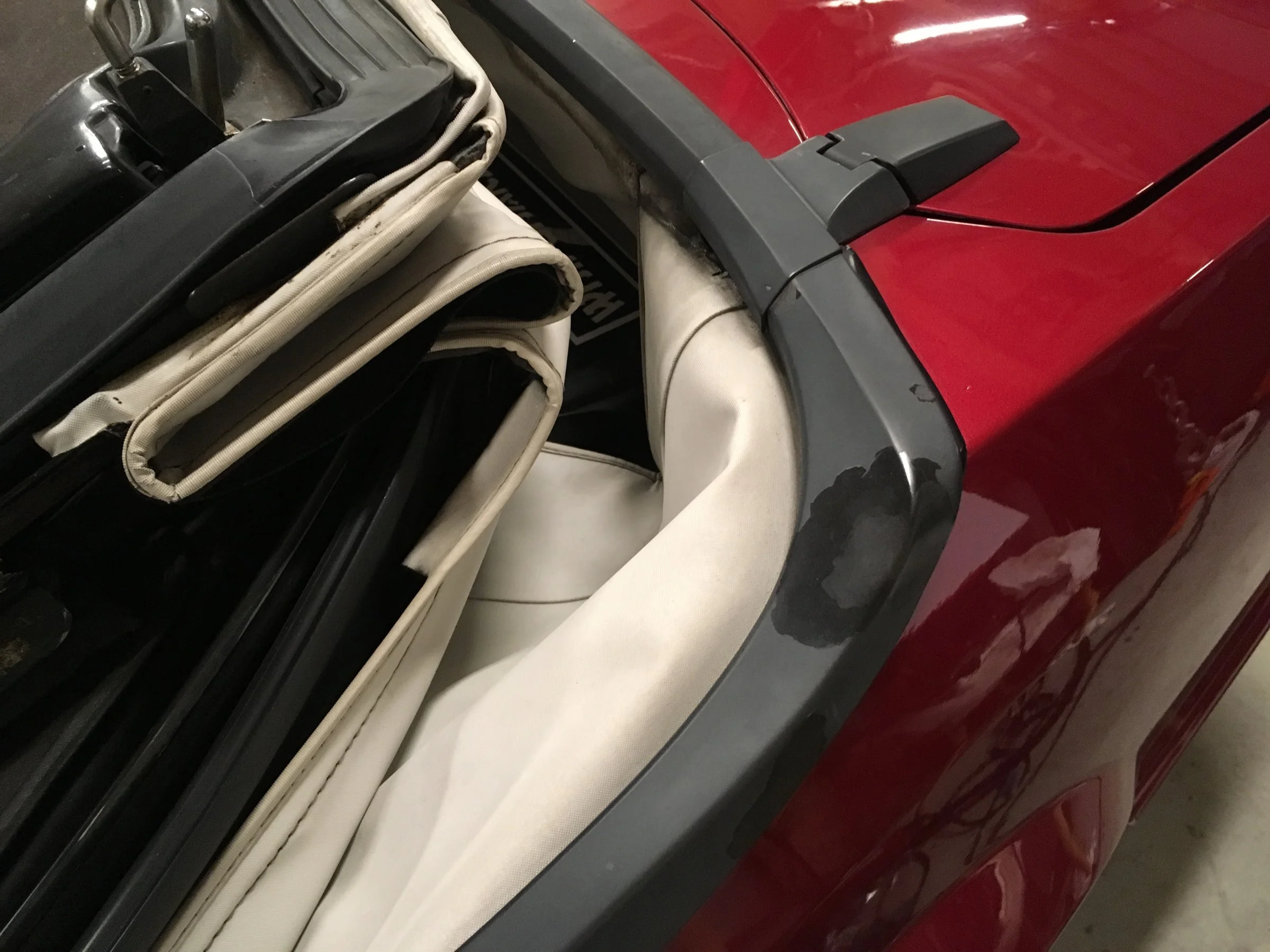

I need to eventually refinish the exterior trim on my 93 convertible. I’ll get some good quality spray cans like VHT or similar. What finish should it be? Gloss, satin, flat? I’m thinking satin.

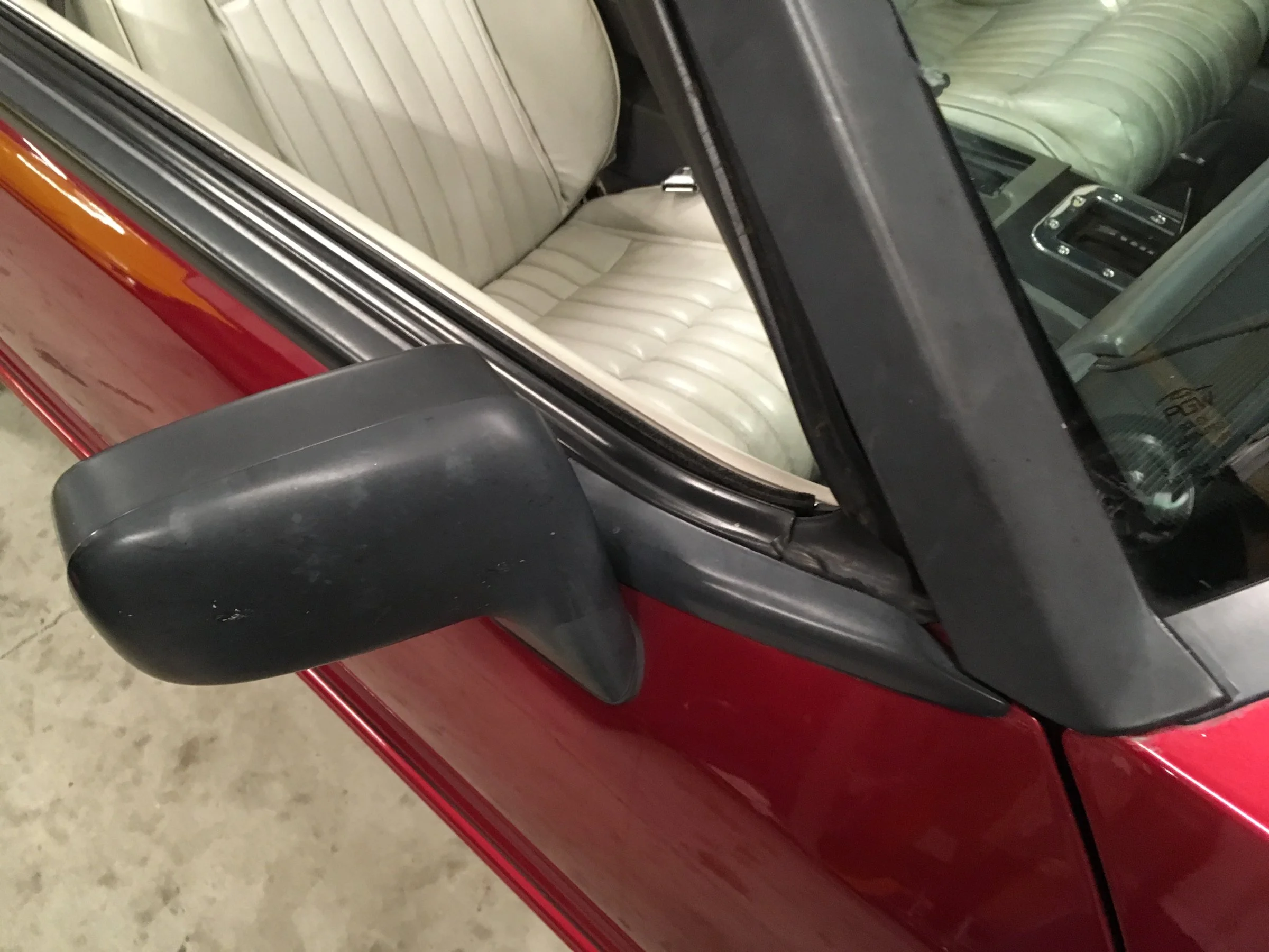

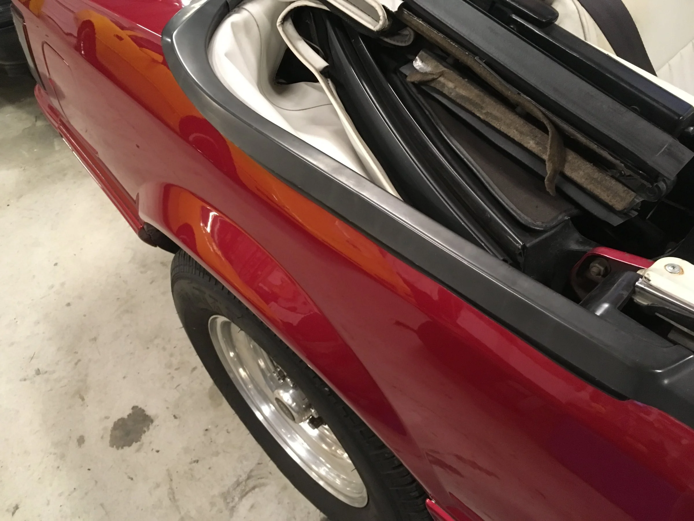

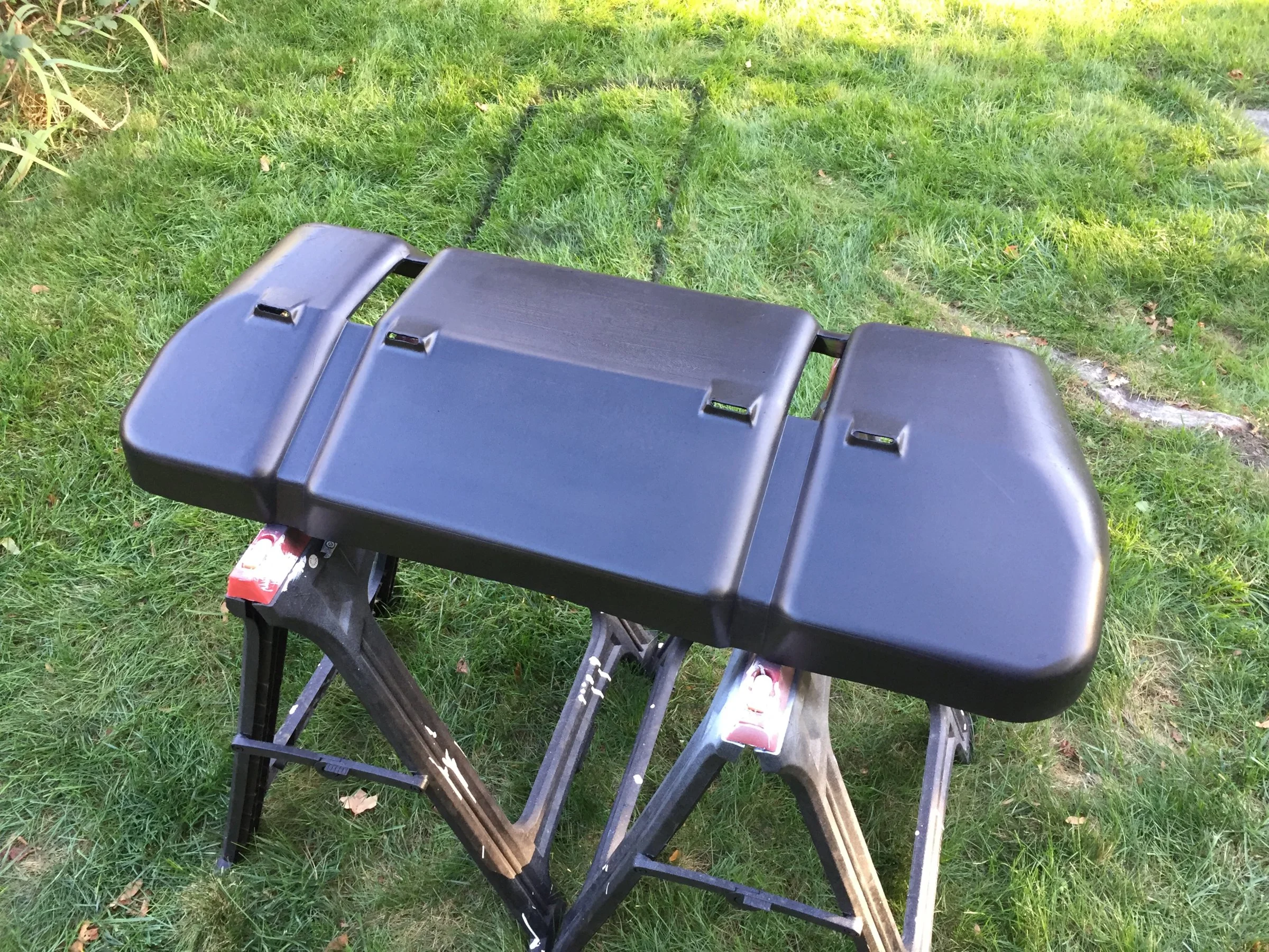

I used the rustoleum flat black trim paint from home depot. It turned out great on my side mirrors, restored quarter windows, and door window frames. I can try and get some pics tonight then I get home.

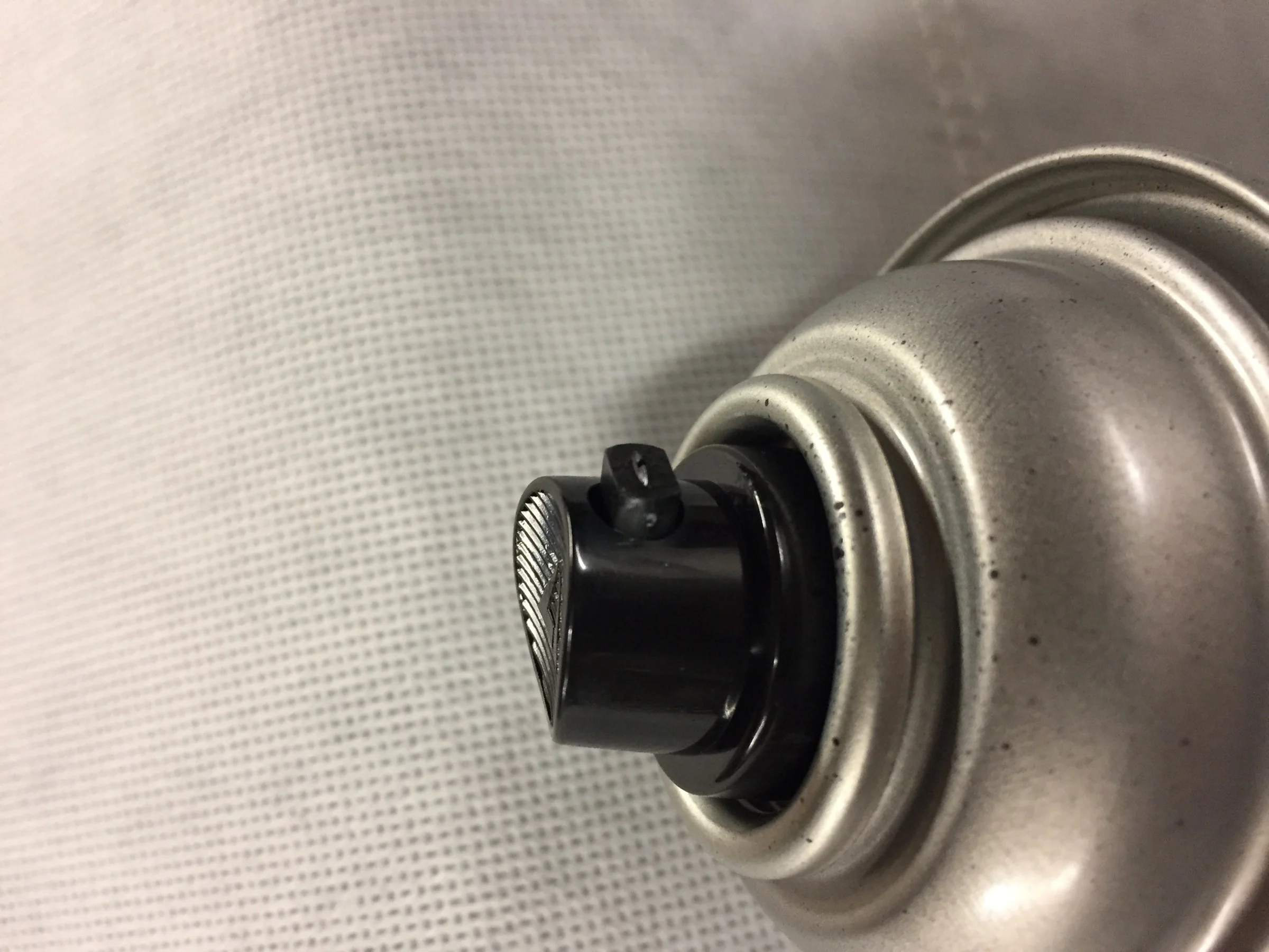

Whatever brand I get, it must have the fan spray nozzle. The one where you can rotate the pattern vertical or horizontal. I’ve always had better results with this type. I know the VHT has this type of nozzle. I’m not sure about the others.
