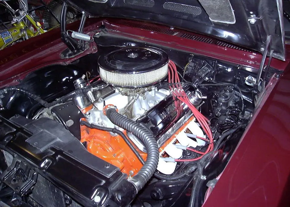

my dad and i used some high temp white paint, from advanced auto, on the headers on our Nova, it held up fairly well. i think its about a year old in this picture. in the end i think any paint will burn off, but the high temp white seems to hold up the best. good luck
