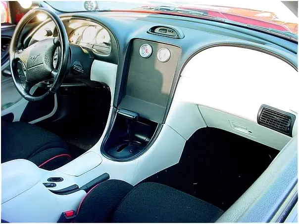

My interior was black with white but now is all black. The previous owner painted it all black, which in my opinion looks bad ass. I love the all black look. Ok well, I need to paint it again cause it's peeling. I know a lot of you have painted the interior and would like to know what paint you used and what did you prep it with?

The dask and vents were painted black.. The white sections are factory.
