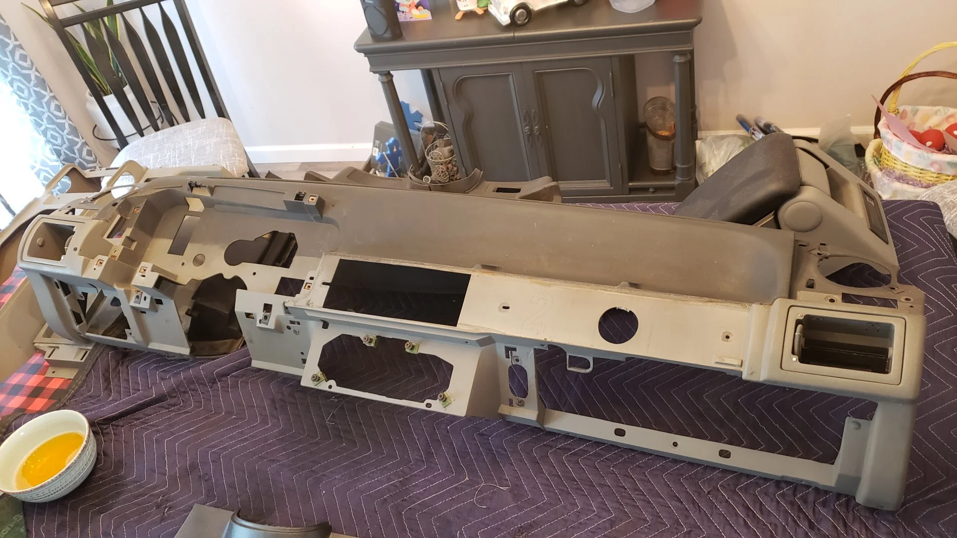

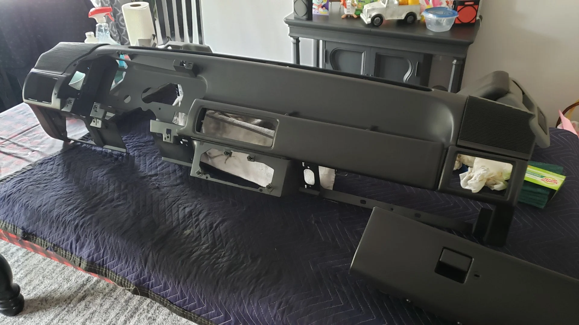

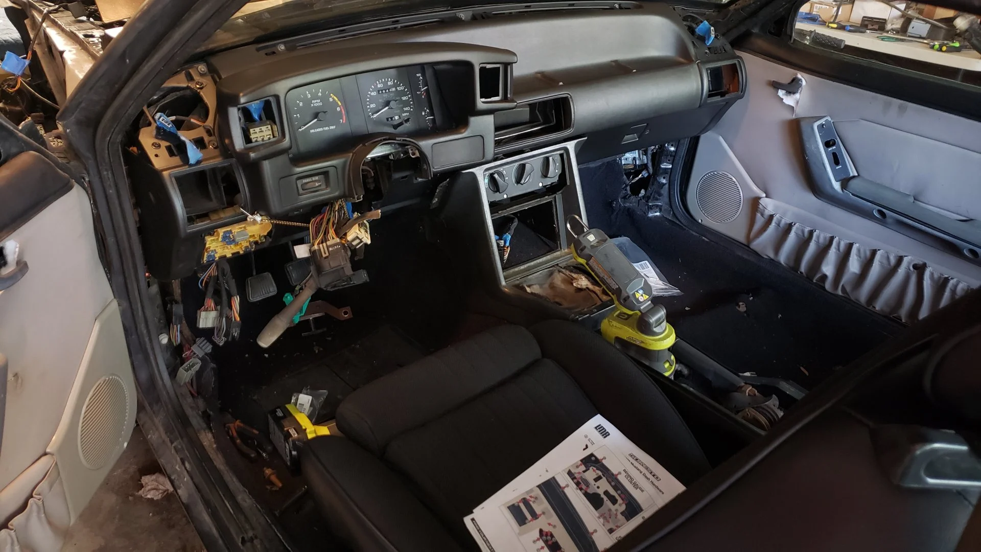

I used some orange degreaser then hit it with a scotchbrite. Next I wiped up all the scotchbrite/plastic dust with some alcohol. Did about 2-3 coats of SEM landau black. I was happy with the results.

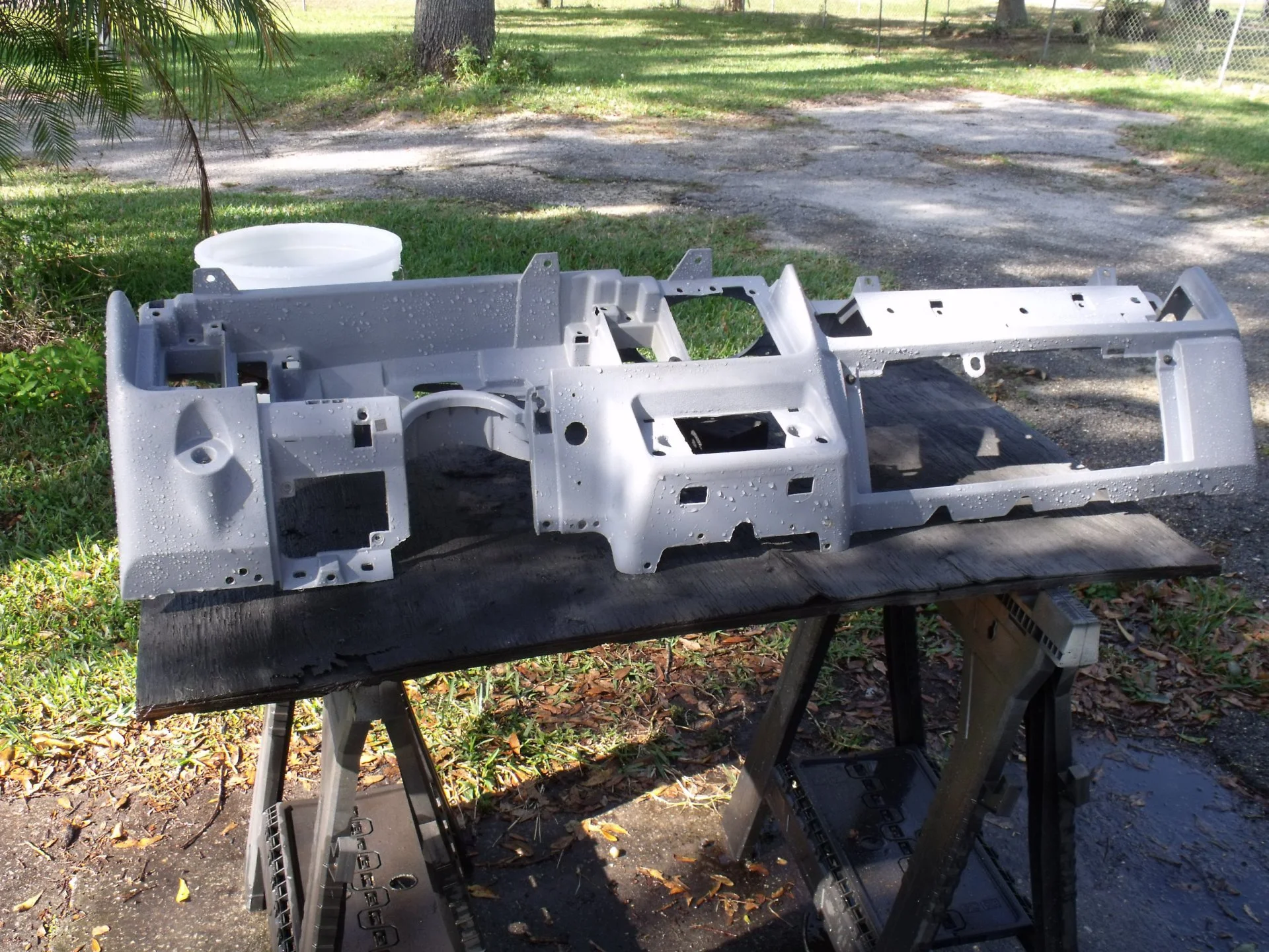

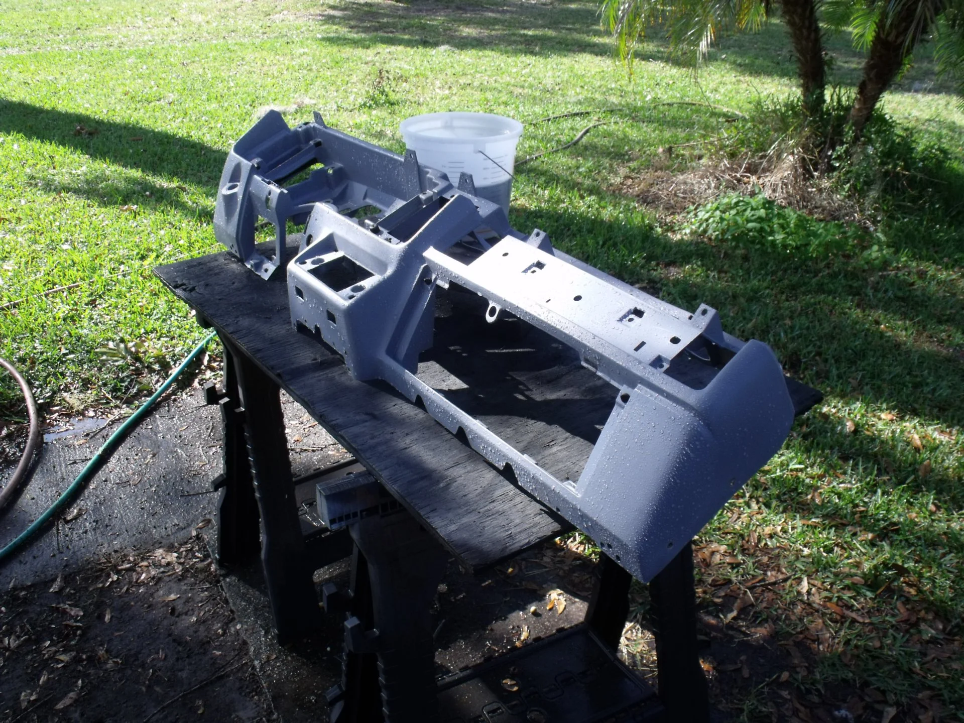

Here is the dash still wet from a scrub down .....
I found some cracks I would like to address..... Thought about using some fiberglass gel, but without cloth it never seems to hold well and using any cloth might make it too large and in the way...
Any suggestions?
