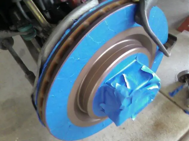

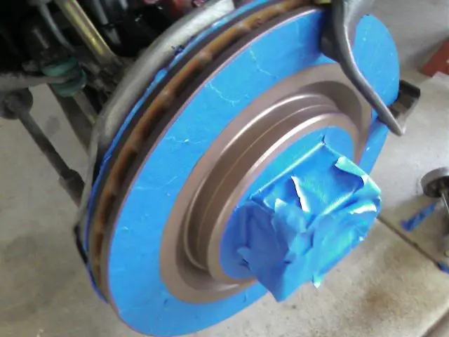

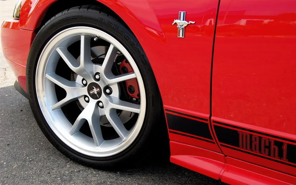

Ok...so I did the Cobra brake swap on the GT several months ago. I was impatient and I didn't paint the rotor hats when I installed the kit. Now the rotors are a nice rust color where it really should be painted. Can I paint them now? Or do I just have a visual reminder of how I just need to do it right the first time....next time :)

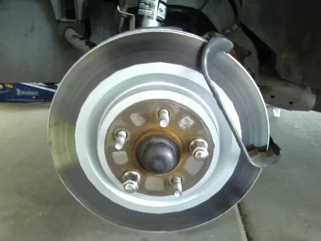

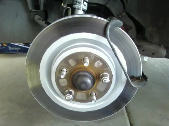

i did this a few weeks ago.
get some steel wool and sand off some as much of the rust as you can. get a rag and clean the rust off. tape off the section where the pad contacts. don't paint where the wheel touches the hat cause any uneven..ness will cause a vibration.
results
