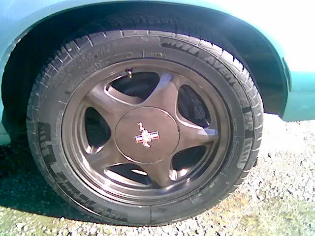

blake89stang said:

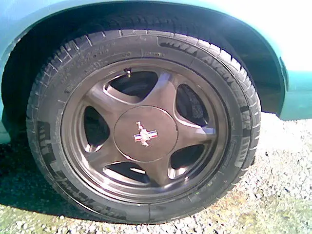

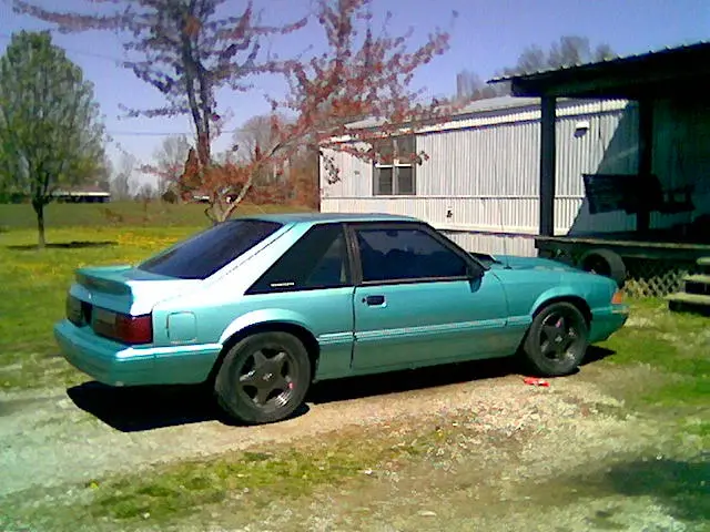

i painted my pony wheels graphite about 1 1/2 months ago. still looks great. i 1 coat primer, 3 coats paint and 4 coats clear.
now im working on the TB and EGR:D
Post a pic if you can, I would like to see how they look darker.

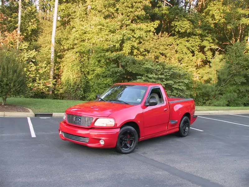

I used wal-mart paint stripper and duplicolor paint on mine...

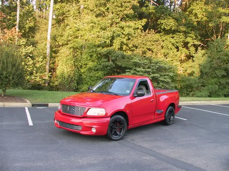

Used same method and paint brand for the Black wheels on my Lightning
